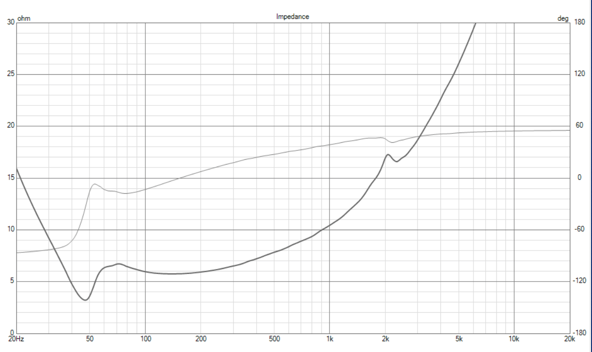

Above: Impedance of Eminence Alpha 15A with 20mH + 450uF high pass filter. Instead of peaking at 25 ohms, we get an impedance dip of 3 ohms. The additional current drawn from the amplifier gets dissipated in the woofer which gets us +6dB bass boost. Note the rising impedance below 40Hz because the filter blocks super low frequencies.
Because the Bass Boost circuit creates an impedance dip, we need to use 8 ohm woofers or 4 ohm woofers in series (unless your amp is comfortable with 2 ohm loads).

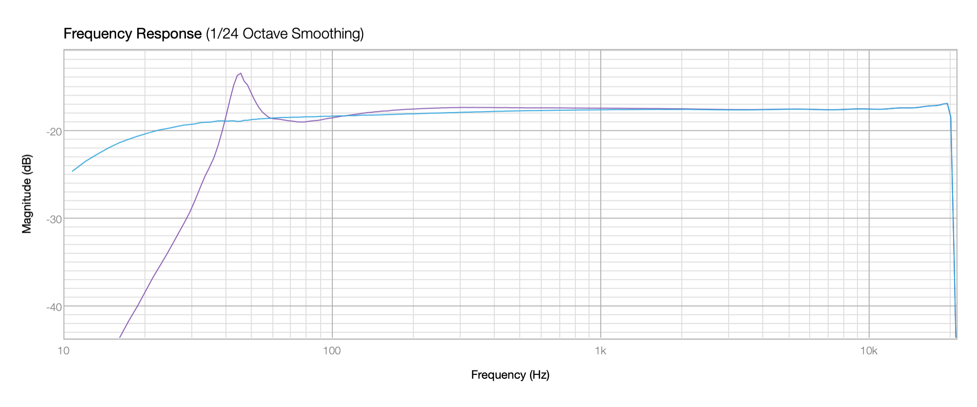

Below is an actual measurement of the circuit I described above: 20mH inductor and 450uF capacitor.
Above: Eminence Alpha 15A; Blue trace = input signal from amplifier, Purple trace = voltage at speaker terminals after the filter. Filter delivers 2X the voltage at 45Hz. Note the steep reduction of infrasonic signals. -10dB at 30Hz, -17dB at 20Hz. Prevents woofer damage and reduces distortion.

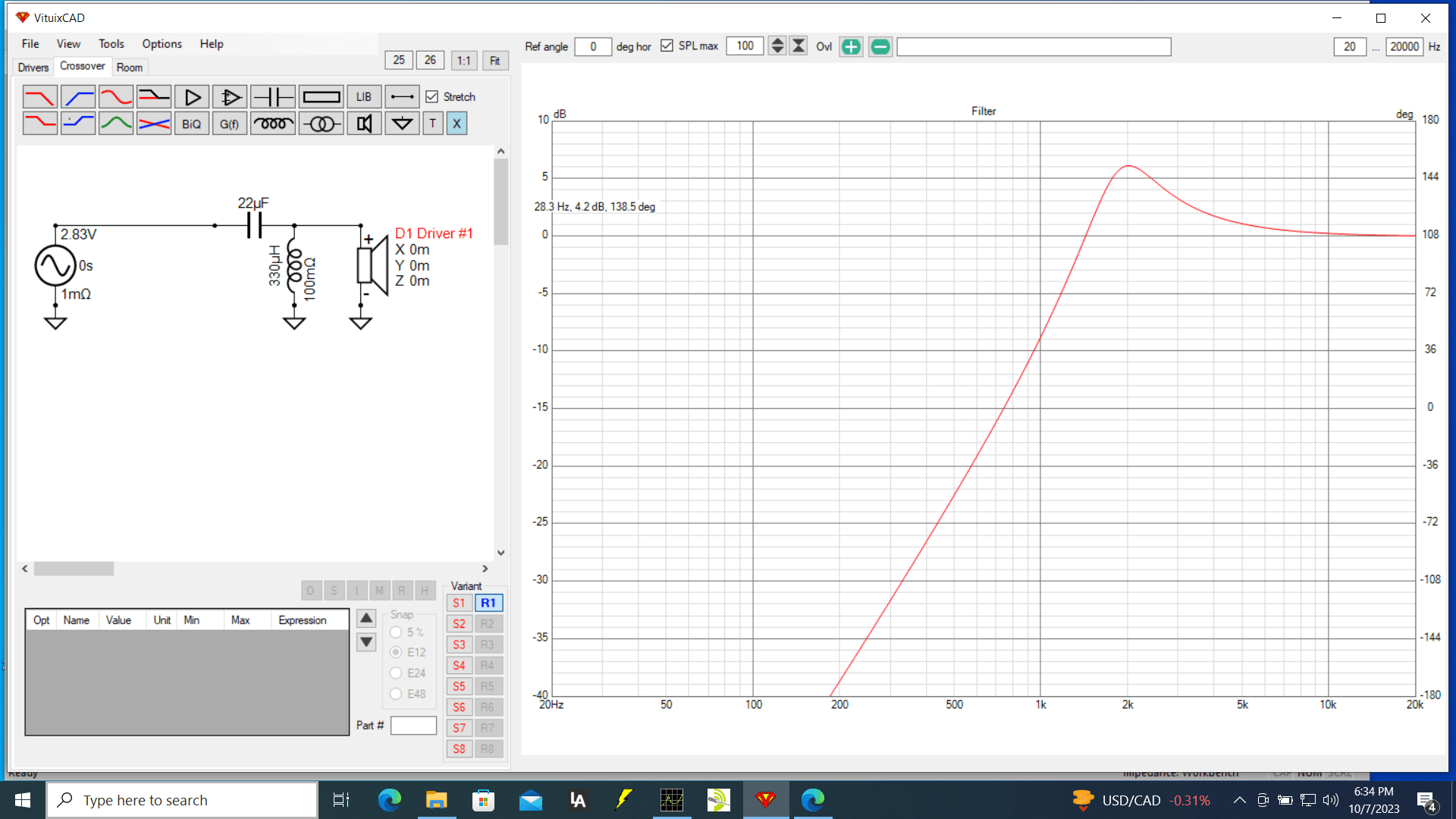

It is not terribly obvious to the average speaker builder that, across a limited range of frequencies, it is possible to get more voltage out of a passive crossover network than you put in. But you can do it with high-Q filters.

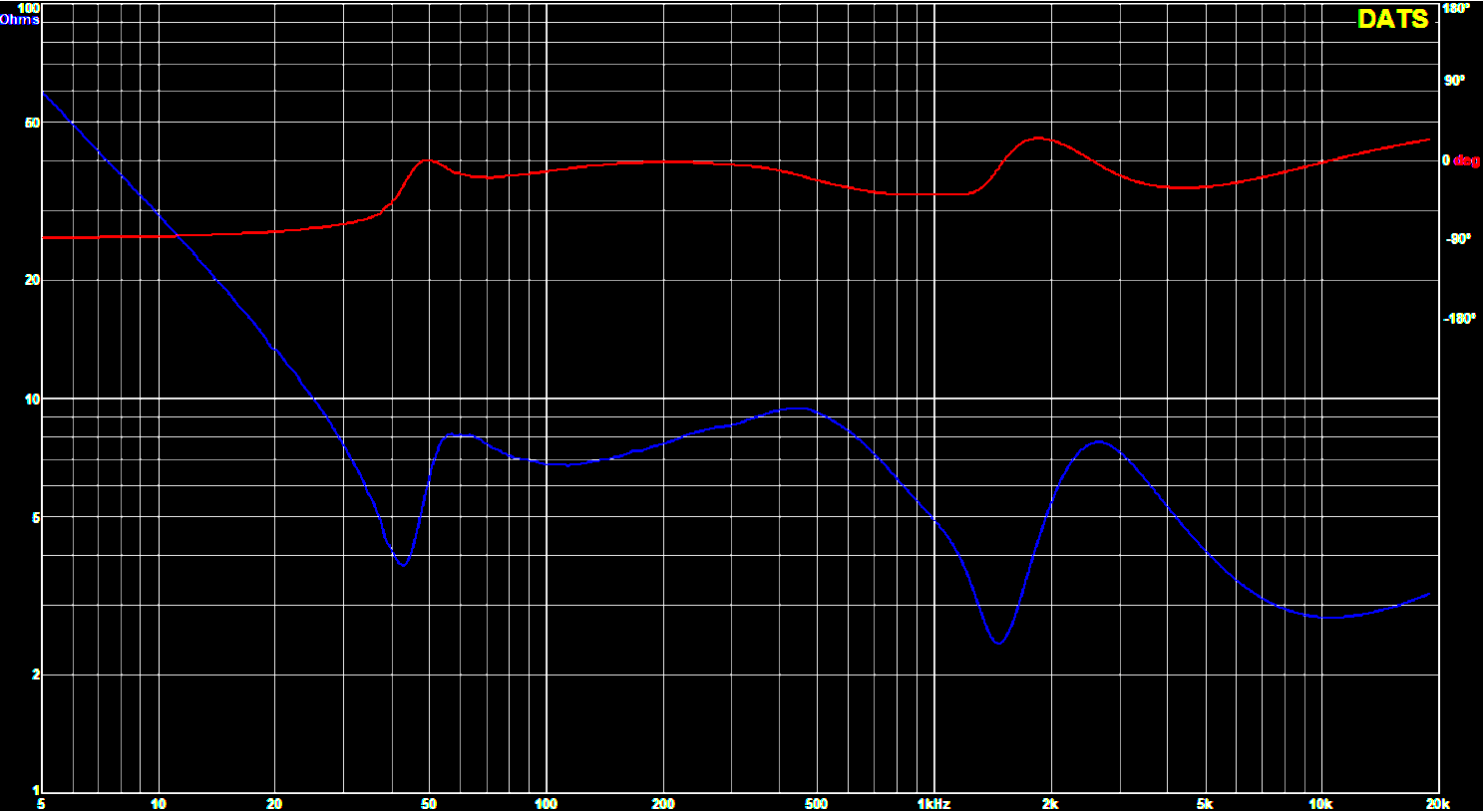

Above: 8-ohm tweeter with a 2nd order high pass filter; filter Q = 2. The red curve shows the input voltage to the tweeter, which is +6dB at 2KHz, followed by a 12dB/octave rolloff below that point. Simulated in VituixCad.

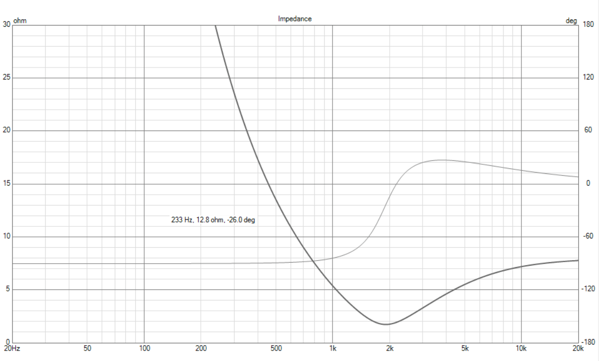

The price you pay for this is lower impedance. The circuit draws additional current from the amplifier and dissipates it in the tweeter. An 8-ohm tweeter with the filter in place has an impedance curve that looks like this:
You see that the impedance dips down to 2 ohms. So if the tweeter had 90dB sensitivity for 2.83 volts at 2KHz, after the filter it produces 96dB at 2KHz.
Oftentimes, when multi-way speakers have extreme dips in impedance, it’s because the designer has taken advantage of this. This feature is extremely useful and quite fun to play with.

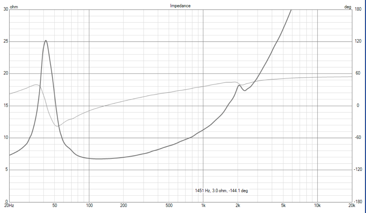

Below are my impedance measurements of the Eminence Alpha 15A:
At the 41Hz resonance, impedance peaks at 25 ohms. We are going to use this peak to our advantage, because when we add a high pass filter, the complex driver impedance will interact with the filter in interesting and useful ways. So now we’re going to model it using VituixCad and design a filter that gives us exactly what we want.

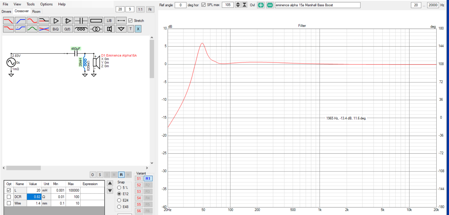

With experimentation I find that a 20mH inductor and 450uF capacitor gives a +6dB boost at 48Hz, with a steep cutoff below 40Hz.
This +6dB boost will blend very nicely with the natural rolloff of the Open Baffle enclosure at about 60Hz. But we have to watch the impedance very carefully:

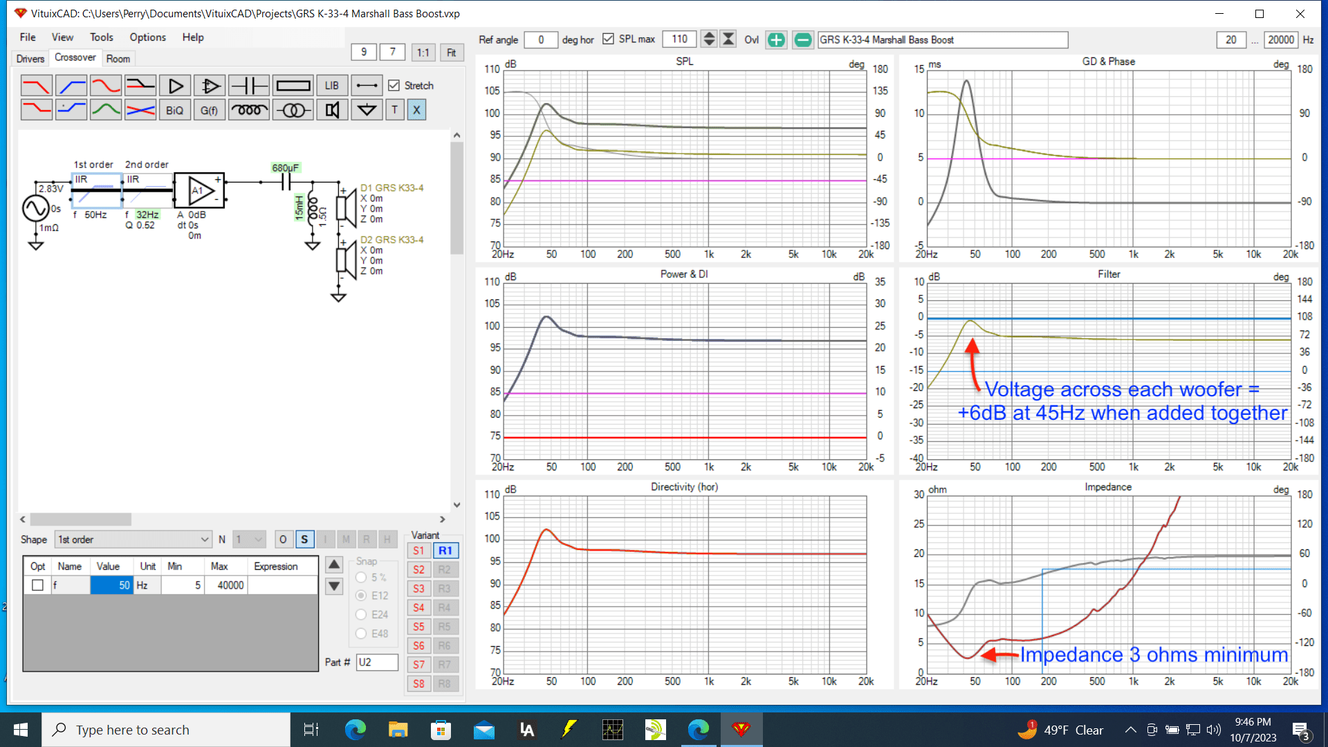

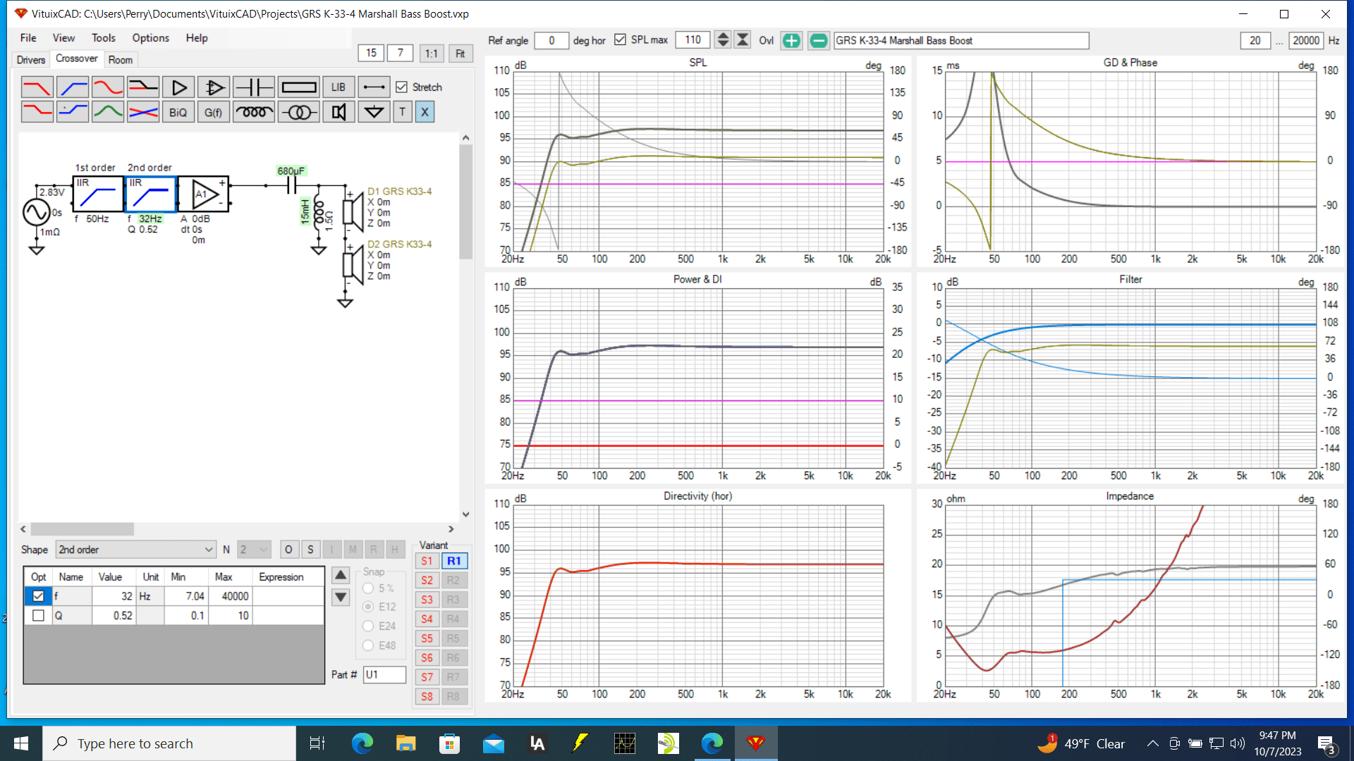

Since the K33-4 has 4-ohm impedance, I’m going to wire two in series, driven by a Bass Boost circuit.
Now, using the filter functions in VituixCad, I am going to simulate 1) the roll off of the driver (Q=0.52, Fs 32) (“2nd order filter” above) and 2) the roll off of the Open Baffle (“1st order filter”) with a simple 6dB per octave slope starting at 50Hz:
Based on the woofer’s natural response, combined with the Open Baffle 6dB/octave rolloff starting at 50Hz, we achieve flat response down to 40Hz with a 3-ohm minimum impedance.

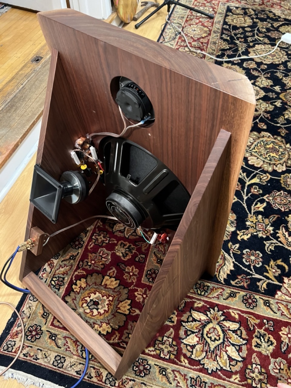

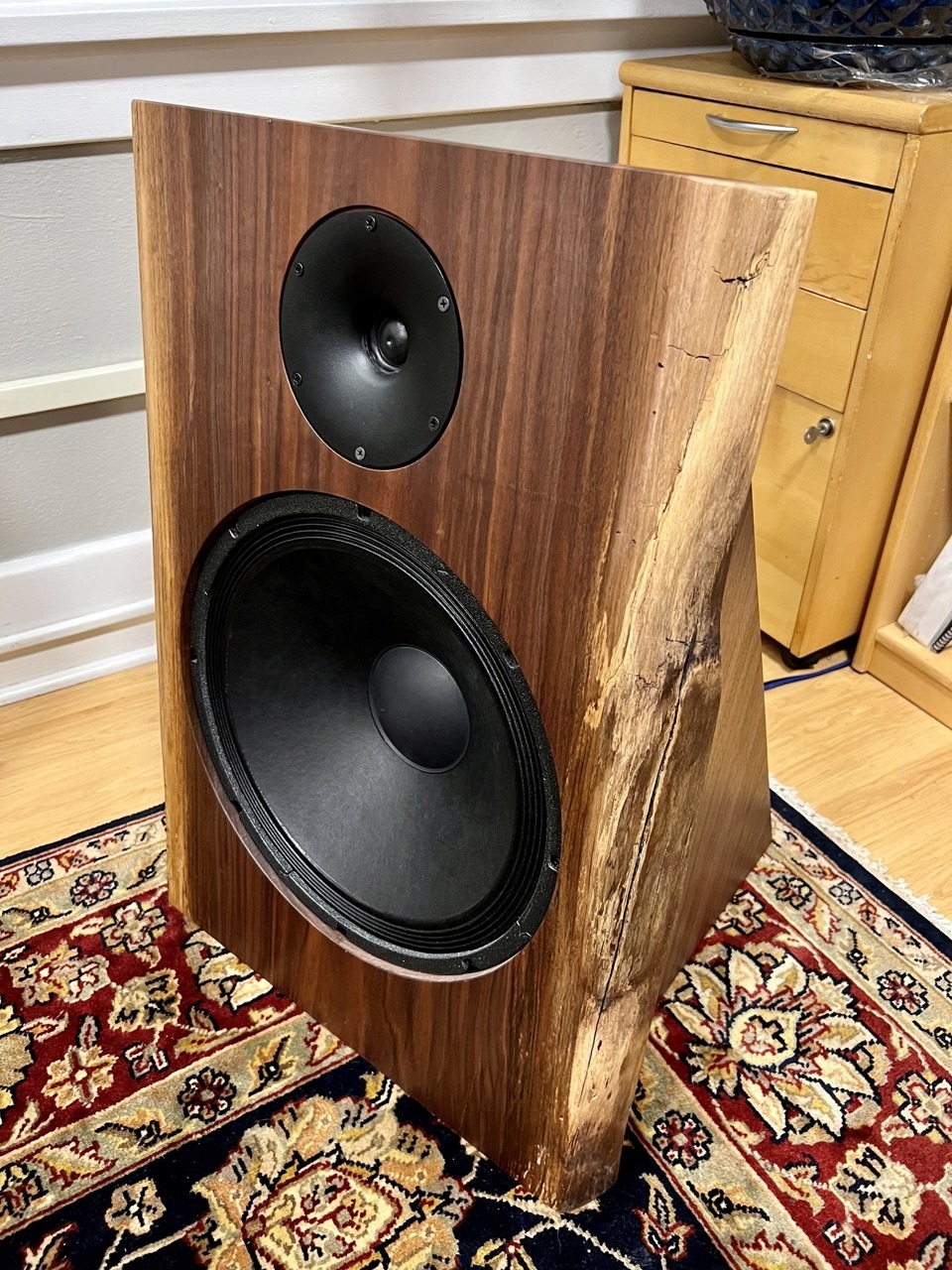

In a separate article I give details on a 2-way 100% passive system with a Bass Boost circuit. Eminence Alpha 15A woofer, SB Acoustics Satori TW29R tweeter with Visaton WG148R waveguide. 5 on-axis measurements in the room, distance 1-2 meters, averaged together from both left and right speakers:

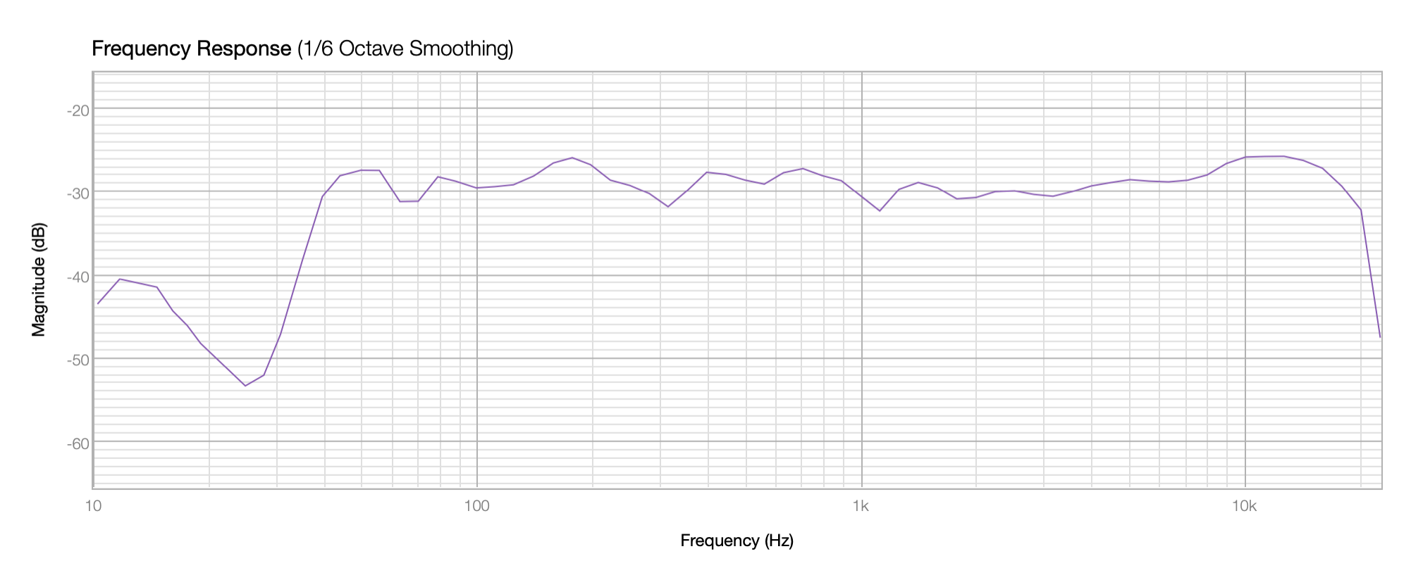

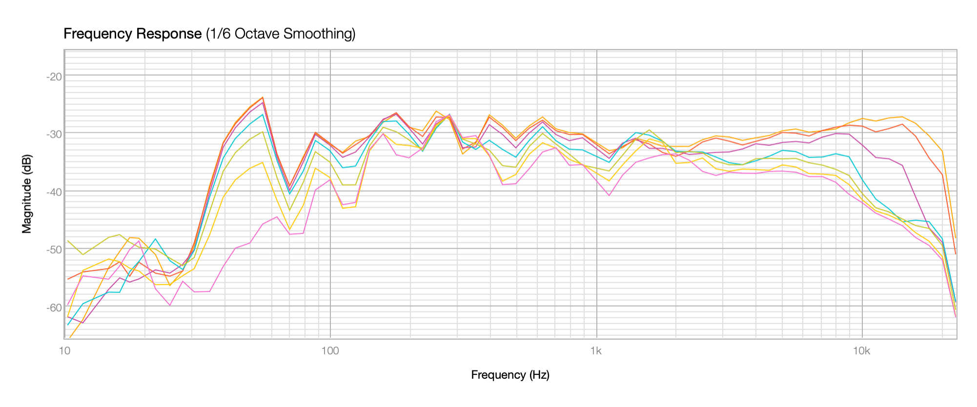

Here are photos with on- and off-axis response curves:
Above: 1/6th octave measurements in real room. No attempt to gate reflections. Curves are 0, 15, 30, 45, 60, 75 and 90 degrees off axis. Curves show Constant Directivity with strong in-room response down to 40Hz. Impedance 4 ohms.
An Open Baffle with no box is much less heavy. If you're using expensive hardwood, it's a lot less expensive than a box. These were made with slabs of Live Edge walnut. These compete very well with reflex designs in terms of SPL, bandwidth, and output. And especially size and weight! The money you invest in those big inductors and capacitors will pay off 10X in shipping cost alone by saving you the weight and expense of a large box.
The Bass Boost allows you to trade off a larger woofer w/ more expensive crossover components against a much smaller, lighter, less expensive cabinet. Using smarts instead of brute force. These speakers weigh 35 pounds (16kg) each.

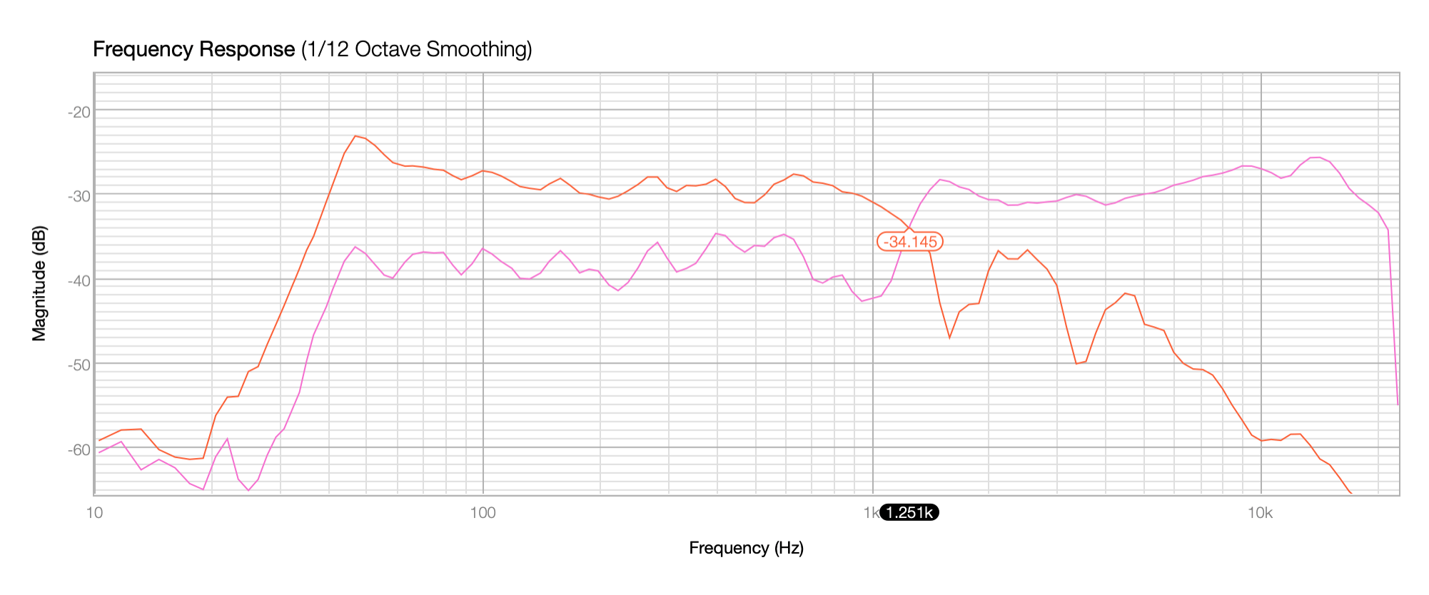

Below: Nearfield measurements of woofer and tweeter. The boost at 50Hz compensates for Open Baffle cancellation which is not visible nearfield:
The Marshall Bass Boost circuit enables this system to yield full, plump bass down to 40Hz, 93dB SPL 2.83V/1M. It comes pretty close to Constant Directivity response across the entire spectrum, and excellent blend with the tweeter with a 1250Hz crossover. The crossover is 100% passive, no DSP. All the advantages of Open Baffle with a LF punch more typical of a Bass Reflex “rock and roll” speaker.
Above: Impedance of 15” 2-way system with Bass Boost circuit. Impedance curve is completely different from a conventional speaker. Note the 4.5 ohm minimum at 42Hz, where the woofer enjoys a 5.5dB bass boost.

I just posted full details of the 2-way passive design mentioned in this post here:
https://www.diyaudio.com/community/threads/the-walnut-dipoles.404187/
Farfied curve cannot be flat same time at 1 m, 2 m and 3 m distance.@kaameelis I'm listening to them at 1.5-3M distance. Dipoles have their own version of "proximity effect" bass boost, same as microphones. The nearfield curves above show this very clearly. The farfield curves are flat.
@kaameelis you're right I'm sure they're not identical. The farfield curves are a averages of several 1-2M measurements. You're invited to extrapolate however best makes sense to you.

It's not the application that puts me off as I've used similar first order passes withe large sealed woofers for ages, it is going to be the high cost of all that copper in the huge inductor. But having seen the graphs I am going to keep it in mind if I go passive with the big OB project I've had in my head for a decade or so.
BTW Madisound just happens to be offering a 20mH inductor with laminate core and 18ga winding for CHEAP right now:
https://www.madisoundspeakerstore.c...uctors/20.0mh-steel-laminate-inductor-18-awg/
That's very close to the unit I have in the Walnut Dipoles, made by the same manufacturer, US Coils. Since in a dipole design this circuit lets you use drivers with a lower Q, the range of new viable high quality drivers this $40 circuit opens up to you is considerable. I understand shipping may be prohibitive for some people but I think for most people it's well worth the expense.BTW Madisound just happens to be offering a 20mH inductor with laminate core and 18ga winding for CHEAP right now:
