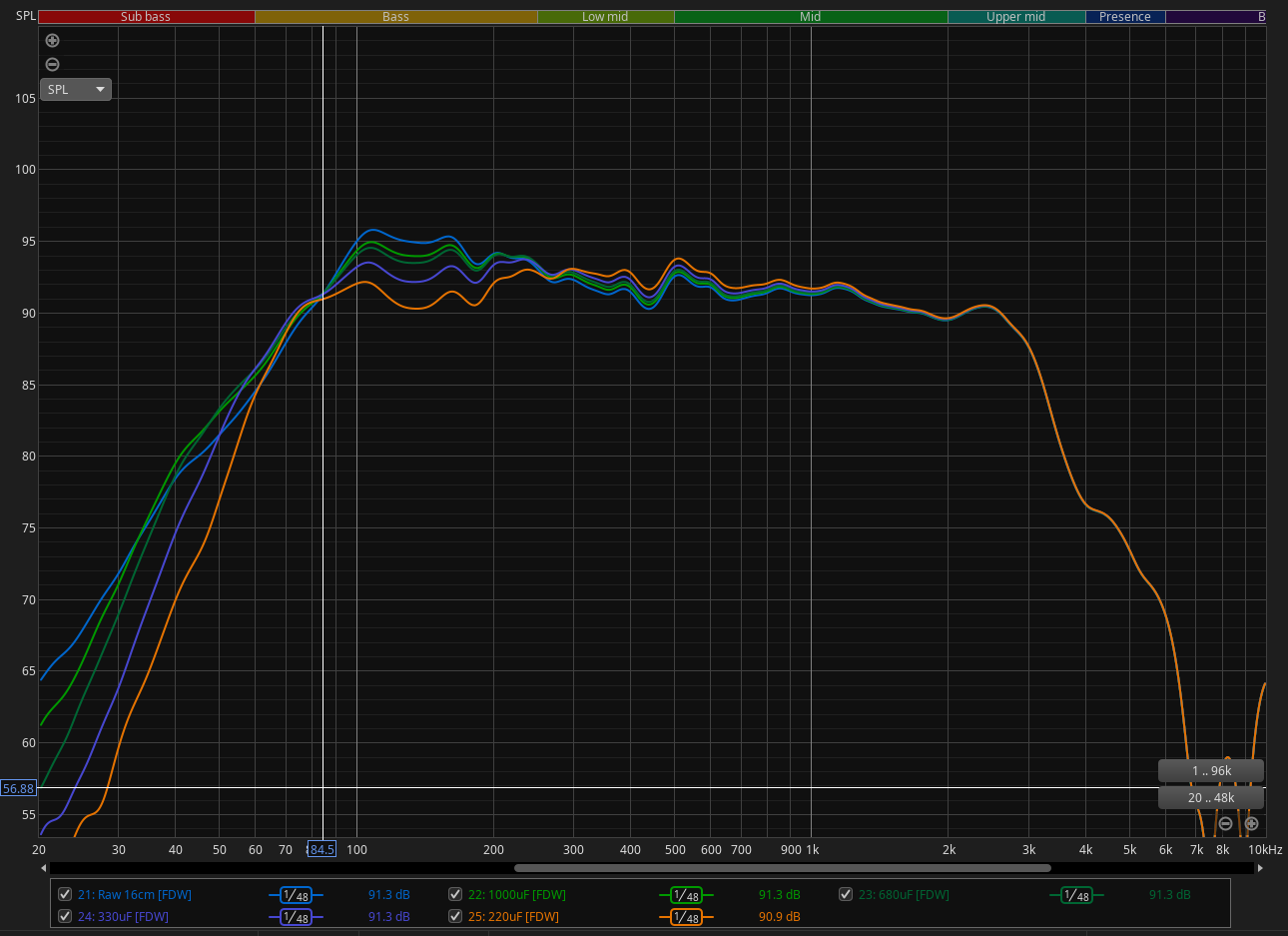

I am using 2 no eminence alpha 15A in parallel with FR. Would I be able to use this circuit with 4ohms or shall I do series and make 16ohms and try it out?

You would make the series vs parallel decision based on the sensitivity of the full range. Series if your FR is ~95dB. Parallel if your FR is ~101dB.
You can use a Passive Bass Boost circuit either way, but with some low impedance cautions. If you wire them in series then you use this circuit and double the inductor values and halve the capacitor values. If you wire them in parallel then you double the capacitor values and halve the inductor values.
The low impedance caution is that the 8 ohm woofer in this circuit has a 3 ohm minimum. Those woofers in parallel would dip down to 1.5 ohms, so you need an amp that can handle that.
You should simulate this on VituixCad or similar software before you build, if you possibly can.
