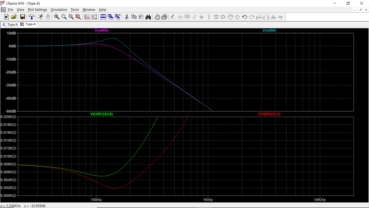

I simulated a third order low pass that ultimately ends up with an equal slope. It consists of 5mh, 300uf, 5mh (BLUE).
The price you pay is that you end up with an impedance dip below 2 ohms ((RED).

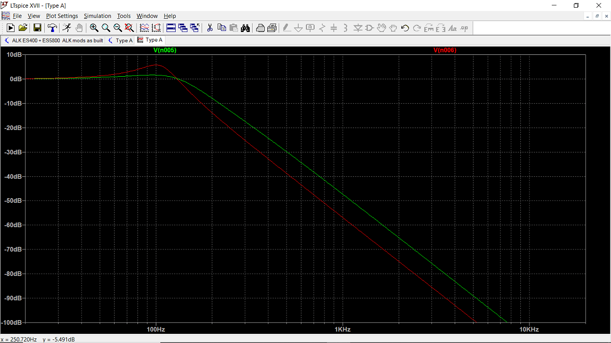

Thanks for the simulation! Could you please simulate an X-over where the hump is at about 100Hz? Fortunately I use diy inductors with airgaped cores so the inductance can be changed easily or I can produce others ...
These are simulations across an 8 ohm resistor, just to be clear.
Here's one using 7.5mh 400uf 7.5mh

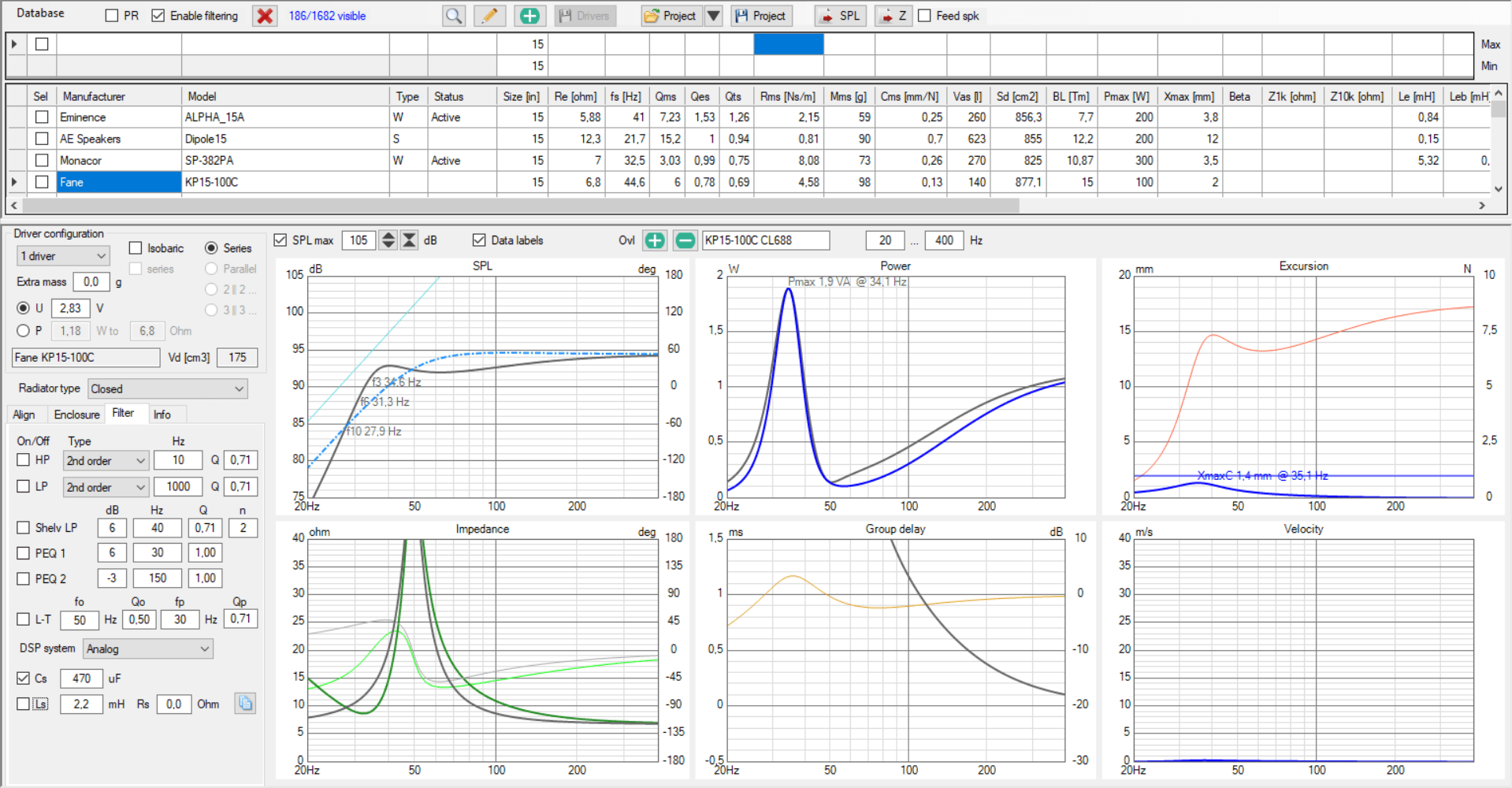

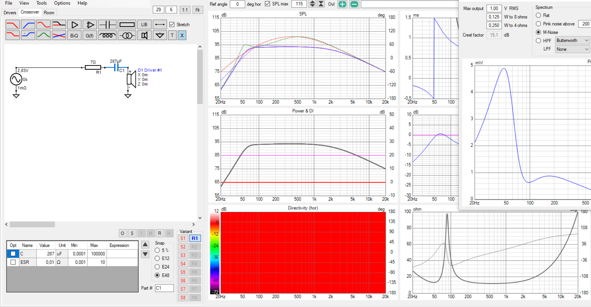

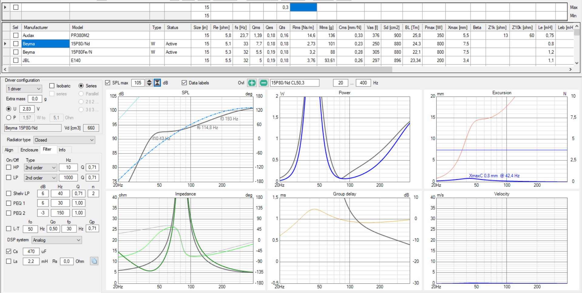

the bass peak, or boost, happens when impedance in series with the driver at driver main resonance frequency is increased so that electrical damping is reduced. Now the driver does not EQ itself anymore (through backEMF) and system Q goes up. It works for any Qts driver, but perhaps this particular application on this thread requires some particular Q. Still, the "boost" is there available for any Qts and exploitable in any system if necessary, although perhaps not very practical if Qts is already past 1.
One can test this directly in VituixCAD enclosure tool for closed boxes, select a driver and toggle the series cap on the filter tab. It should work similarly with OB as it is function of the electrical damping and adjusted/exploited per project, if it's something useful.
On these images the overlay trace in SPL window is "auto aligned" closed box response for each driver, and the black line shows response with 470uf series cap added. One can tailor the Q with box size and cap size. These are some random drivers with few different Qts to demonstrate, nothing special.
The trick increases excursion which increases distortion for the whole bandwidth so it's not free lunch. Excursion and thus distortion would rise with DSP as well so in that sense it's nice, bass boost without DSP.

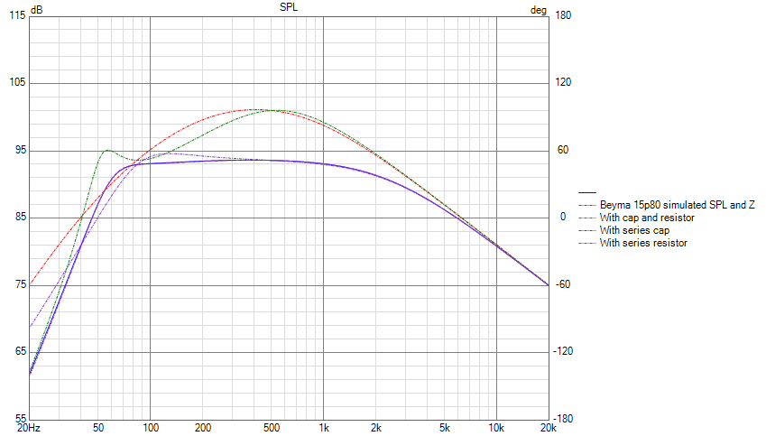

Edit time over, gotta add few more observations from the closed box examples:
ps. it's simulated response and impedance of the Beyma 15p80, from example above.
- the boost on the above examples is mostly below the impedance peak frequency
- Also, as the cap increases high pass slope, which partly reduces excursion on the very lows, so perhaps distortion penalty isn't as bad as it could.
- peculiar thing with also a resistor added, straightens the response (reducing current on mids than at the resonance), and while the cap doesn't add that much boost anymore it still does some contouring of the Q, but not a boost anymore. Also distortion would be reduced some (hint of current drive).
