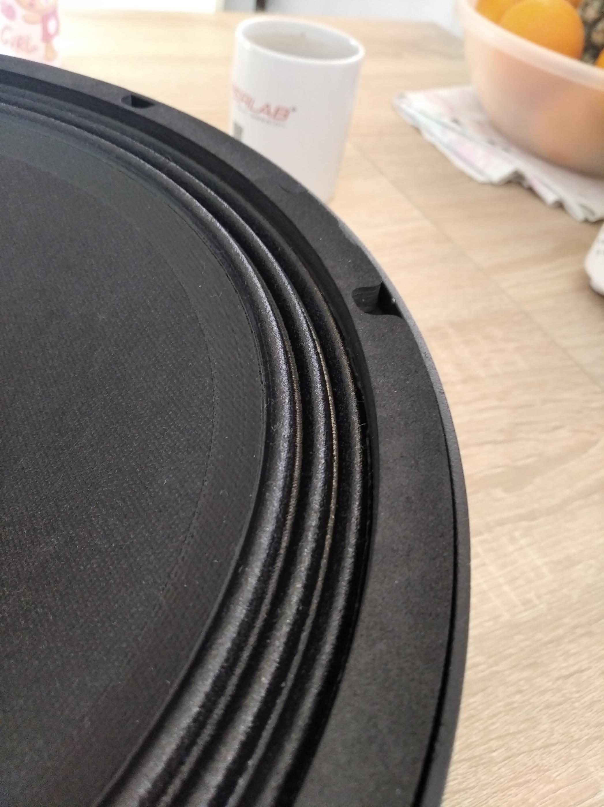

We talking about the black foam bits (on mine) in between the bolts? They seem like foam to me and not cardboard—mine have "squish".

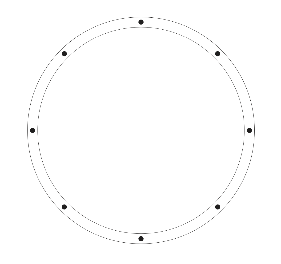

Funnily—I made the attached some time ago—inspired by Devore, priced it out in brass—$160 EACH—and I'm not sure I'd get it right on the first pass... I put it on hold for the time being. It would be very sweet—even if raised a bit from flush, however, with the foam removed would sit right inside the groove..

We talking about the black foam bits (on mine) in between the bolts? They seem like foam to me and not cardboard—mine have "squish"...
You're right. I've just inspected mine. Foam indeed.
![IMG_20210215_133928.jpg IMG_20210215_133928.jpg](https://www.diyaudio.com/community/data/attachments/841/841763-16bba0809712a5212d5082197b99d003.jpg)
This makes things much easier. Very sharp scalpel and leveling jig.

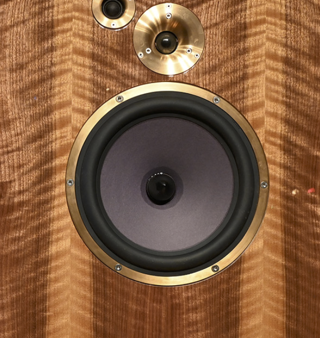

scalpel and careful use of googone or even very very careful use of acetone will remove the foam. They may just peel right off cleanly. Trim ring cost is the barrier (or not! ;-) I actually think if it sat a tad proud it would look good a millimeter or 2 if covering the edge of the basket was wanted. Otherwise the trim ring could be machined to fit in the groove flush with top surface, replacing the foam—which is obviously less machining to produce.... Group buy Matthias? You also have silver cones on your tweeters which I quite like—mine are black.

That pic with the bronze finished drivers looks way cool. Definitely more finished with the ring.

It seems we all have perhaps different materials in play on the woofers that have to be dealt with since they were "designed" to be mounted from inside... I priced out a flat dimensioned trim ring that I designed to sit in the groove where the foam currently is in mine... I quickly priced it out with some guys in CA who do great laser cutting work. Large size, lots of waste and 1/8" brass came to $160 per (technically worth it, if you want it, for these lifetime speakers—but it's not cheap). Then I'd have to manually add the countersinks and get brass bolts (which can sometimes be really costly too).

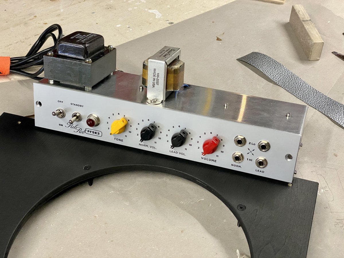

I used the clear/silver anodize for my McGyver tube amps looks pretty nice:
Der MacGyver Verstarker ist fertig aufgebaut | HiFi-Bau Brennwald
