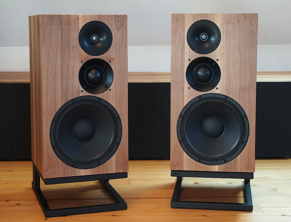

There are a few photos in this thread. I attached a photo of my finished Monkey Coffins.

Mine—USA side—cost every bit of $2500 to make the pair and that doesn't include my time or all the tools required to pull them off from a woodworking perspective—I also took my time and price shopped over the span of about 4 months gathering parts—also possible the exchange rate was better at that time, IDK. The Volts alone are 1/3 of the cost of the build—I bought them through Solen in Canada. The other way to save massively in the US is order as many parts as possible from the guys at Audiohobby (see links in first post—Matthias has been updating the links consistently)—It was really hard to find stateside a lot of the crossover parts (unless you want to start modifying inductors etc)—but Audiohobby had everything per Matthias's BOM and were fantastic to work with and shipped UPS to US for free (at the time) and you can view all prices in USD sans VAT on their website.
I posted a lot of images as I built mine... you can do a search—relatively recent as far as the thread goes. I am a little sad they are finished. Haha. They were a blast to build—daily gratitude to Matthias around here and I can't believe I own them. Another friend stated "Well, you built your last speakers, first". As these were my first speaker building foray.
