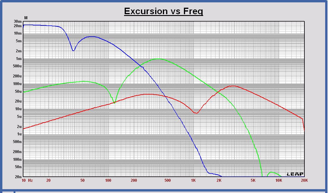

Better late than never, I made some maximum excursion plots of the Monkey Box design.
The woofer excursion is maximum 7.4 mm peak at 64.7 Hz for a voltage of 33 Vrms on the speaker, that is a SPL = 112 dB at 1m, free space.
Interesting to observe, at 33 Vrms, the midrange excursion is 976 um peak maximum at 387 Hz. The lineair Xmax limit is 1mm peak.
The tweeter maximum excursion at 33 Vrms is 81 um peak at 2920 Hz.
