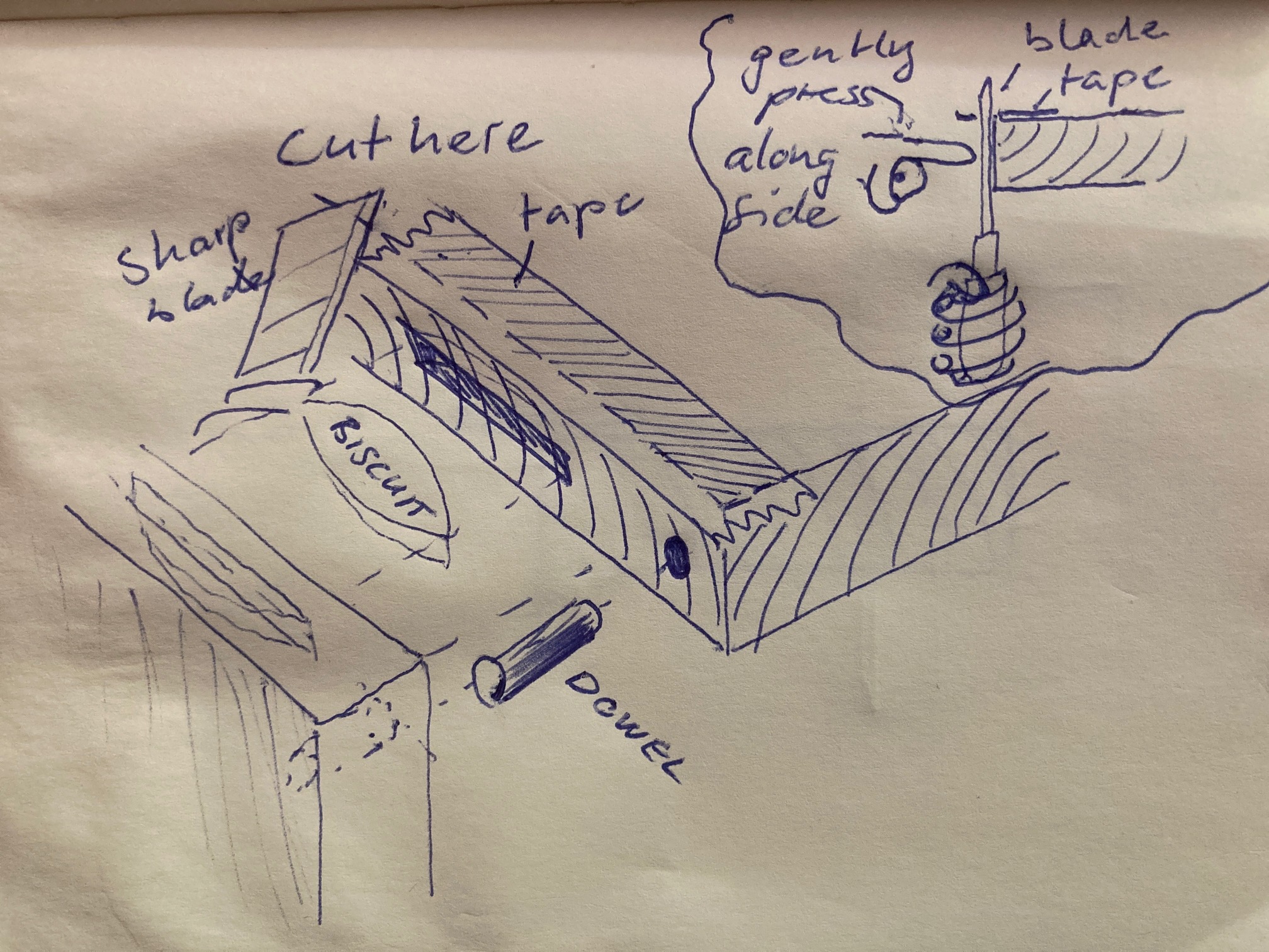

The cabinet-maker’s trick for precise alignment of a cabinet‘s sides is to use a dowel at the side‘s end (that’s 2 dowels per connection, must be predrilled as precisely as possible), thus the positions of the cabinet‘s parts are defined. Biscuits work „unilateral“ only and the part can move while you’re glueing/joining/clamping…)
If the cabinet will be veneered, you could also use nails to lock the position, but that’s tricky, and they must be removed after the glue has set.
Use the internal bracing as angle, clamp the sides (they‘re forced into a square angle with the braces)
Use the PUR-glue which is awful to work with, but is stronger than the wood itself and thus nearly unbreakable.
If veneer won’t be applied, to avoid a mess on the precious outer sides, use masking tape, mask the part before you connect them. Stick the tape onto the side so that it overlaps, and cut the excess with the sharpest blade you have (razor-blade, cutter or chisel), make sure there’s no overlap into the joint. The expanding glue will flow onto the masking tape… = clean joints!

Don...Be very careful applying any tapes to veneered ply, especially at an edge. Tapes over veneer can and usually will pull grain out—perhaps less of a thing with birch/maple but I've still seen it happen exactly where you don't want it to.... and as I mentioned, for simplicity, since you have butt joints—you may have the best results when final finishing to embrace the multiply and clearcoat it all. Personally I think that would look great. You could also paint wash—also letting the plys be plys. myleftear's sweet advice about registration pins is solid—though if you are clear coating—you will see the pins (and they will telegraph through paint w/o going through a process)—and if you do them blind the expert factor goes WAY up. Any glues left on the surface of ply that aren't removed will not take finish—which is why I was suggesting, due to project size—water based glues will keep you flexible and simplify glue up and you can easily manage squeezeout and excess. I have never seen a failed titebond joint that broke in the glueline—and you have biscuits and a box with lots of support. Just my opinions! Let us know what your final result desire is—we can all keep throwing stuff at you... Sheet veneering of this size isn't for the faint of heart either...paper-backed veneers and proper contact glues would soften the learning curve, but even then... pretty hardcore.
I of course didn‘t consider „grain pull“.
Still, I‘d only use stuff like 3M 244 or maybe 3M 2090, better material. When you remove the tape, always pull it out of the edge (not into the surface) and keep pull it off as „flat“ as possible (this is hard to express…)

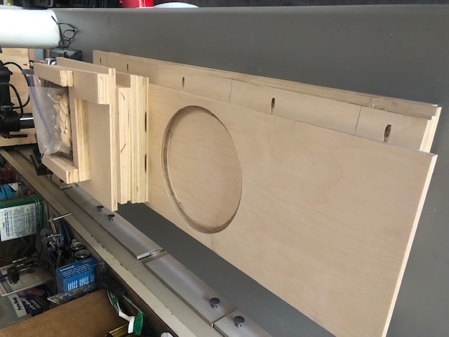

cutouts and drill outs

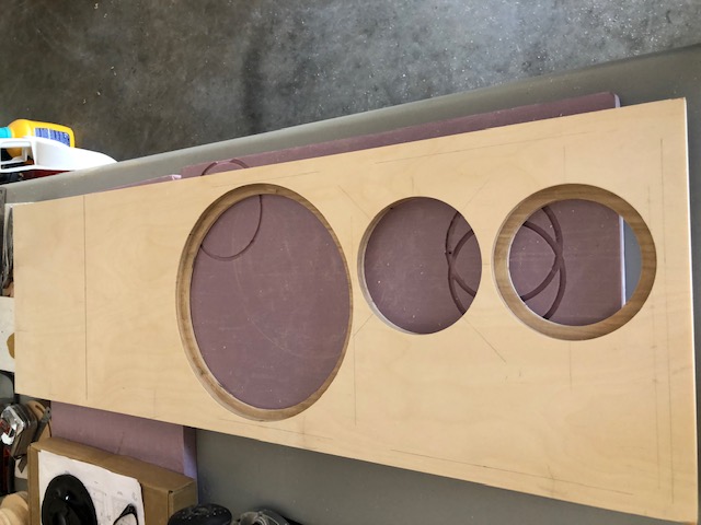

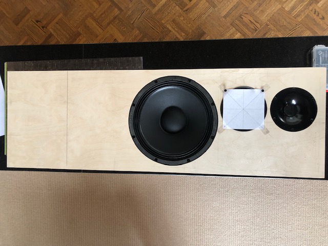

Attached are the driver cutouts and my Volt screw mapping project.
Summary in case it helps somebody. Pics attached.
Cutouts: Two keys. An infinitely adjustable circle jig and cut as many practice holes as you need until you are totally satisfied with the fit. I wanted what I call a slide fit which is really a press fit but it just slides in with little pressure. Thank you pfarrell for talking about the practice part.
The little square paper over the volt speaker is my mapping template. The mounting screws are M5 on a 172mm diameter. I made a template quite easily with a Lietz 45deg drafting triangle. I only use a micrometer to measure since the measurement is digitally read out and I only have to use two points to get a good tic mark. I don't do fractions of millimeters well. My method of being precise. I am drilling 5.5mm holes and will use the counter sink to self center the screws.
I'll let you know how my concept works.
So far so good on the first two holes but am on hold for a portable drill jig because my drill press does not have the "throw to get to all the screw locations.
Sometimes you have to DIY to DIY.
As an FYI, The line approximately 9 inches below the woofer is where the bottom of my tower volume is. The extra space is for two floors and the xover space. I took them out of the driver section but did not want two more boxes (or one more).

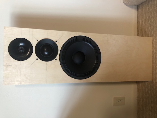

dry fit

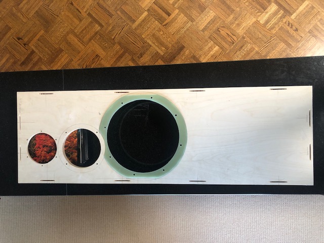

Attached are a couple pics of my front baffle with speakers dry fit. Tedious to get it right but it all worked.
The green ring on the woofer cutout is 1/8 in G10. It is really tough stuff and great for backing plates. Maybe overkill but the bottom of the speaker volume is further away on my tower so I opted for the reinforcement.
Now to assemble the cabinets.
My plan is to finish (stain, paint, whatever) the cabinets before I start to put everything together. The wood is 18mm baltic birch.

Oh man! Super exciting Don. Looks great. I see you opted for the "off center non-12 o' clock" woofer bolt alignment. That will make it easier inside.
Re: finishing. I went perhaps a bit rogue here—but it's based on years of experimentation making photography backdrops for our own professional purposes. I also involved my wife in the process of the color/design in order to gain support for a project that, well, wasn't really optional in my opinion! At one point she had no less than 18 swatches of whites painted on our walls deciding which white we'd use in the house. I used the exact Benjamin Moore Regal Select paint on the speakers as we used on our walls (Chantilly Lace) OMG. BUT I thinned every coat, and went through the usual process of knocking down the grain/flattening brush strokes each coat, and filling voids/blemishes. I did this process for about 10 coats, building thin layers up. Then I used a poly satin clear coat, for an additional 3 coats. All water based. What you end up with is a decidedly organic looking finish—but very professional looking as well. It's not about some perfect non-orange-peel high gloss candy coated finish. What I did has a different kind of depth—probably a direct result of so many coats. I let the plys telegraph a bit on the various edges and didn't worry about trying to make them completely go away. (to do that BTW involves Bondo in my experience.)

@pfarrell,
As usual, very helpful. Thank you. I am actually kind of surprised after all those coats, albeit thinned, that there is still some read through. Interesting.
Re the woofer bolt alignment - form follows function. I kind of wondered when I got into the build why it was designed so tight driver wise. Maybe M will chime in and give us the background. Anyway, I am trying to build it as accurately as possible and change is not on the table.
I will keep posting and asking questions as I couldn't do this on my own. Thanks again.
I wanted the drivers close to each other to reduce vertical dispersion, and to make them fit on the OSMC front baffle. I designed it such that the woofer screw holes would fit around the magnet of the midrange, even if the screw holes would be arranged "horizontal" as shown here.
