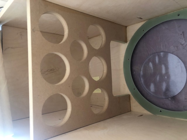

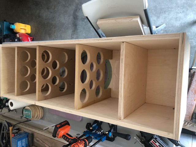

I think I should add an additional brace to my tower. 2 reasons,
1. longer unsupported wall length below woofer, tower is 230mm longer.
2. The recommended port placement at mid height lands right on a brace.
I could solve both problems with added brace. Looking for your thoughts/approval.
Thanks,
Don
Here are a couple pics. All 3 reinforcements are basically the same. Probably overkill but it's sturdy. Top two reinforcements are not actually finished (nor installed).
The cabinet seems really strong but the baltic birch ply definitely has a ring to it as opposed to a thud. It is probably too late to put an inner layer in as this was built off the interior dimensions. Open to suggestions.
Don
