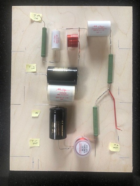

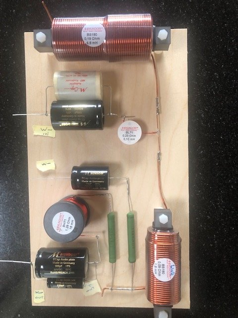

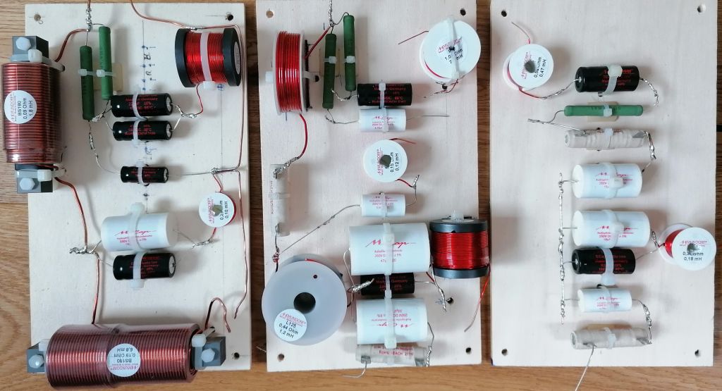

Don, I had a quick look at your xovers, but the photo is not always clear enough to see all details. Can you do closeups with better focus/detail of the three branches? Also, the woofer sees a larger box volume, which changes the bass-reflex tuning. I believe we discussed this in the Monkey Tower thread, but I am not sure what you came up with in the end. (How) did you adjust the impedance compensation of the woofer accodringly (Lw4 and Cw3 in the xover schematic)?
planet IX, is that a metallic screw to hold the small inductor in the woofer filter (and maybe others)? If so, make sure the screw(s) are non-magnetic! I prefer plastic screws/parts for this.

All parts are fixed with plastic-screws and and zip-ties, so no metal anywhere in the xover.
M, thanks.
I will reshoot pics for better results.
I have three changes from the posted parts list. Lw4 at 18mH, Cw3 at 320uF both from the tower thread and Lm2 at .39mH which was your suggestion for an improvement from this thread. I hope I got it right. Certainly not forgotten.

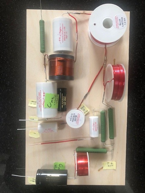

I did not check all the part values, but the connections look fine. You'll still need to connect all the "minus" ends. Also, one of the labels says "T+" where it should be "Mid+", but I believe that's pretty obvious. Looking good!M,
Better pics of xovers. Let me know how it goes. Many thanks.

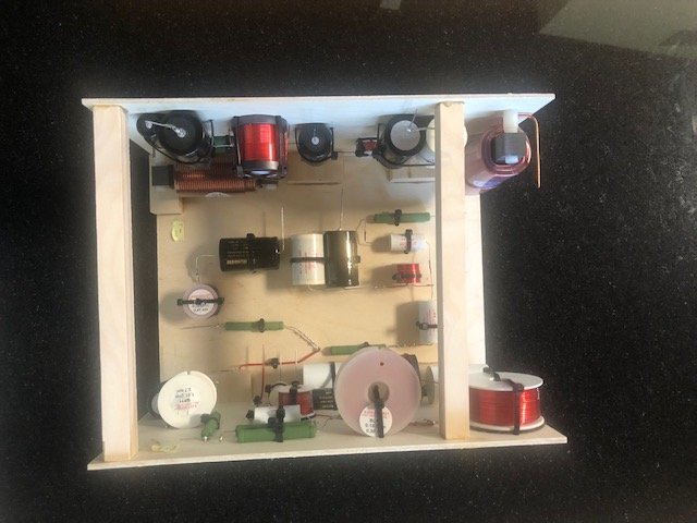

The xover "sled" for my monkey tower. Since the xovers are in a separate compartment at bottom of the speaker box it has to be built outside and then slid in and hooked up. Not the easiest way but it's the end result I wanted. + and - in and outs not completed.
