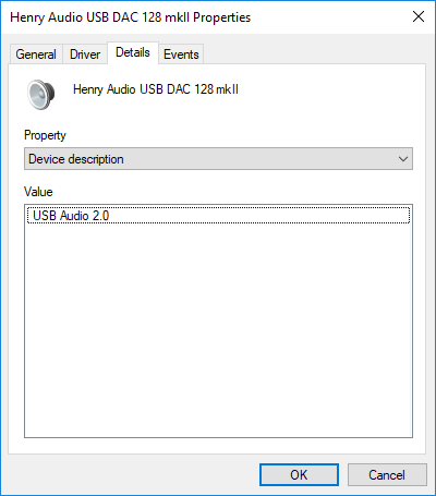

Something went wrong with my windows 10 driver for UAC2 when I changed the usb port. It would not play anything in Foobar in UAC2 mode, while UAC1 works fine. No error, just hangs, like it's being paused. Tried to perform cleanup multiple times, everything installs without any errors, but UAC2 mode just not working. Going back to previous USB port did not help either. Windows rebooted twice as well.

No joy yet, but here's something odd. I uninstalled and cleaned up all drivers from related to Henry Audio, and device still pops up as installed. It also works in both modes, UAC1 and UAC2, and is displayed differently Windows driver list.
UAC1: Headphones (Henry Audio USB DAC 128 MkII)
UAC2: Digital Audio Interface (Henry Audio USB DAC 128 MkII)
Not sure how this is recognized in both modes without drivers? What driver is being used to play in UAC2 mode? There is no click when switching between different sample rates, so I'm guessing it's not switching at all and plays all the time as UAC1.
It seems to be that new Microsoft UAC2 driver. How do I check if it's really playing at given sample rate?

Hi, It seems you have everything as it should be. Both UAC1 and UAC2 are class drivers in Windows now.
The DAC uses a code to present itself as a digital interface. The new UAC2 driver has picked up on that. Previously, the firmware used the headphone code to identify its device type. The new firmware uses digital interface for UAC1 as well. Your computer probably just cached the old code. Don't wory about that!

Both DAC, driver and player are sources of potential pops. The MS UAC2 driver has been maturing significantly in that area.
When you use the bottom-right audio icon and navigate to properties and sample rates, you should be able to see all 6 in the pull-down. When you test them, the DAC uses the selected rate. That I have checked many times.
Whether or not the player sets the driver and DAC to use the music's sample rate is a different questions. Different players and protocols are better than others. In general, WASAPI exclusive tends to be rather good.

If you are using Win 10 the audio player gets piped into the audio engine. That has SRC's on each in and out. Check the properties => advanced tab for the setting for the audio device. Some programs like Jriver can work around this limitation I think. However I have always had to set it manually using the Windows sound engine. The native SRC's are not the best either.
