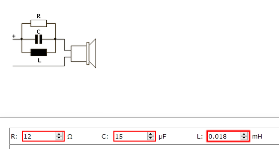

The 9.5kHz peak which causes sibilance is caused by the cone itself, not the dustcap. Run the maths on the diameter of the dustcap and the lowest frequency it can ring at is about 20kHz.
Easiest way to fix is to build yourself a 9.5kHz passive RLC notch filter. This way the modification is fully reversible. edit: notch filter attached. Increase the value of the resistor to make the notch deeper, decrease towards 0ohm to make it shallower (at 0ohm, the filter doesn't do anything)

Make some by turning some wire around a wooden dowel. Small inductors are easy to make by hand because they require relatively few turns.Suggestion on where to get inductors that small. I'm in USA and mainly deal with Parts Express and Madisound. Round the value you gave to common size? Thanks.
Air Cored Inductor Calculator – M0UKD – Amateur Radio Blog
Without an inductance meter you may need to get creative at tuning the filter to be exactly 9.5kHz. You could aim to make the 15uF capacitor a little under the nominal value (14uF), then play a 9.5kHz test tone and add small capacitors (0.1uF) in parallel until the tone becomes quietest.
Do you have measurements to back up this claim? What happens if you over-do it (the driver is junked)? In my experience, painting cones usually just moves problematic peaks to different frequencies. In a lot of cases things become worse, or the amount of mass required to sufficiently damp kills the drivers sensitivity. If there was an easy solution to damping cone breakup every manufacturer would do it.RLC is a bandaid. The Zig on the back (and the extra EnABL ring) work to discourage this peak.
