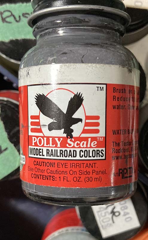

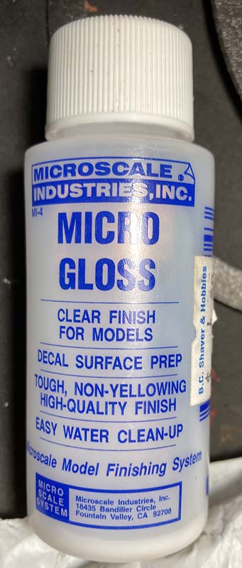

I have some questions for materials.ModPodge, ZIG 2-way glue for the preprep. High solids train paint for the spots and the clear glosss (used for covering decals on models).
1) Clear gloss means Modpodge gloss?
2) Can I use urethane paint for alminium dust cap?
I couldn't find high solids paint .
Would I be better off leaving them stock

Clear gloss is an acrylic, ModPodge is a PVA.
Don’t know about urethane.

This is the kind of paint you want.
Testors Enamel Paint 1107 Turquoise
Google is not finding me Japanese sources. You are looking for a hobby shop that sells plastic models.
Gloss: Model Master Acryl Clear Flat, 1 oz.
This should be at the same model store.
ModPodge should be findable at a general craft store. Also the ZIG, but finding the exact brand could be tricky. It “dries” if left inthe air, put it between 2 pieces of paper and it is like stickies.

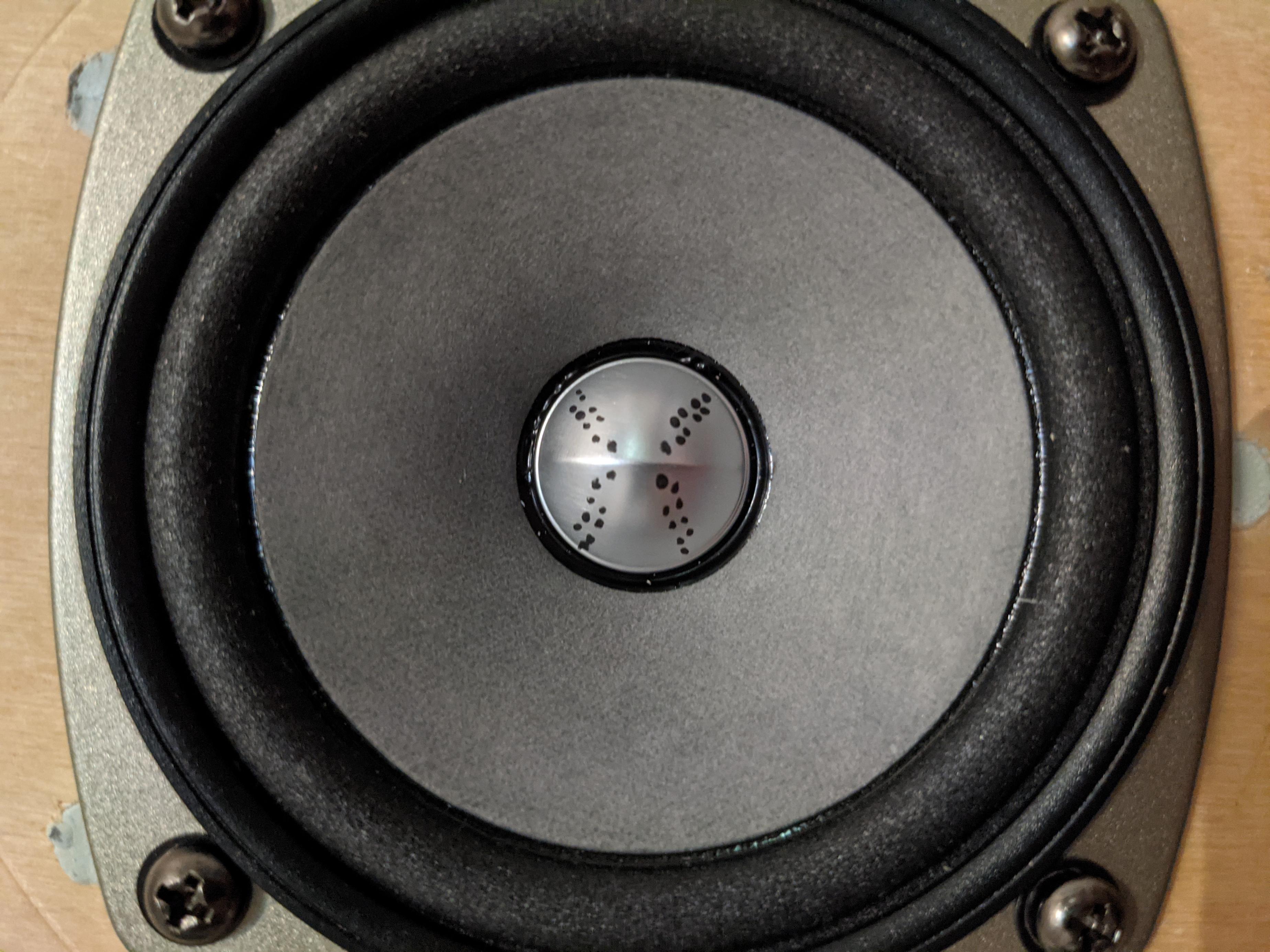

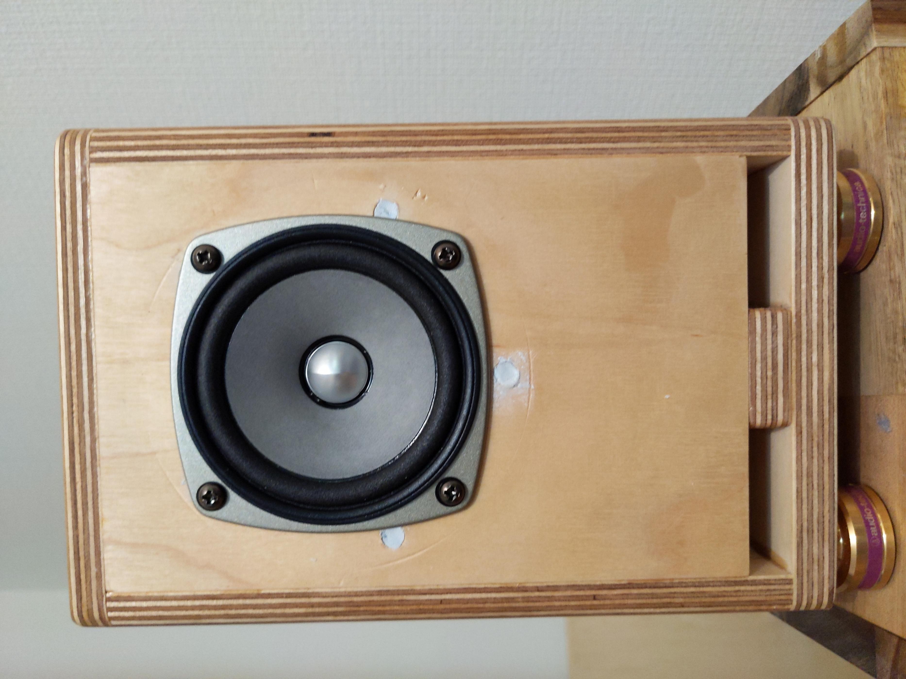

Wow FF85wk is amazing driver.
So smooth than I thought from reviews in my environment.
Feel like why I didn't have this until now???
I also bought solid core cable made by Audio-technica.
Solid core cable is best for me.
Thank you Dave,uFonken box plan is the art.

RLC is a bandaid. The Zig on the back (and the extra EnABL ring) work to discourage this peak.
dave
Can we assume both methods can give the same result, and if they do, does one have an advantage over the other?
They are complementary.
Are you saying they should be used together or did you mean they're equivalent?

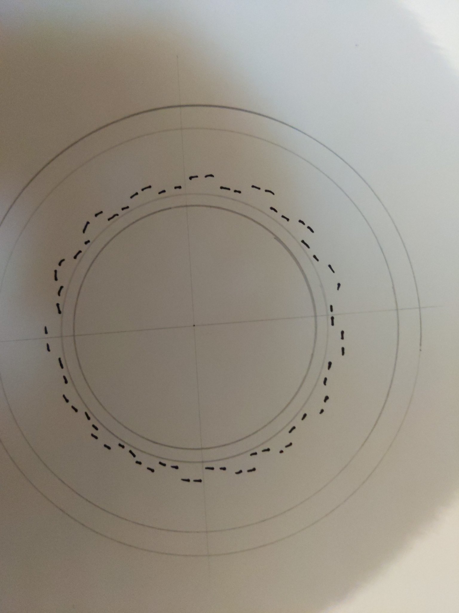

Hello Dave.
I am thinking to enable SB65wbac25-4.
https://www.diyaudio.com/community/threads/sb-acoustics-sb65wbac25-4-what-to-do.273211/post-6996484
Do you think it's good to enable like this?

I’d have to do a tap test to tell.
I have gathered the most important posts for those that want to try EnABLing here: https://www.diyaudio.com/community/threads/how-to-enabl.385334/#post-6999171
