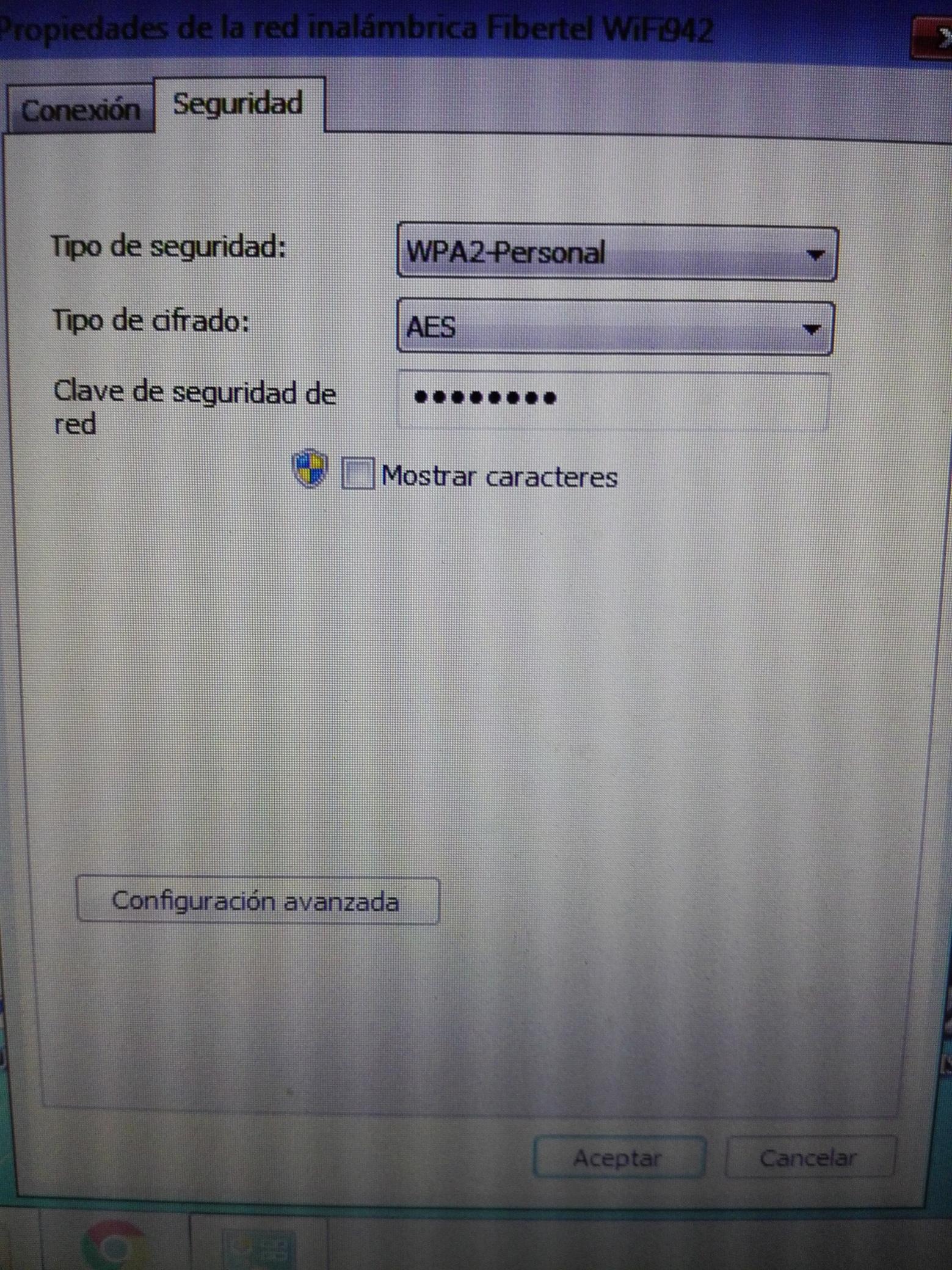

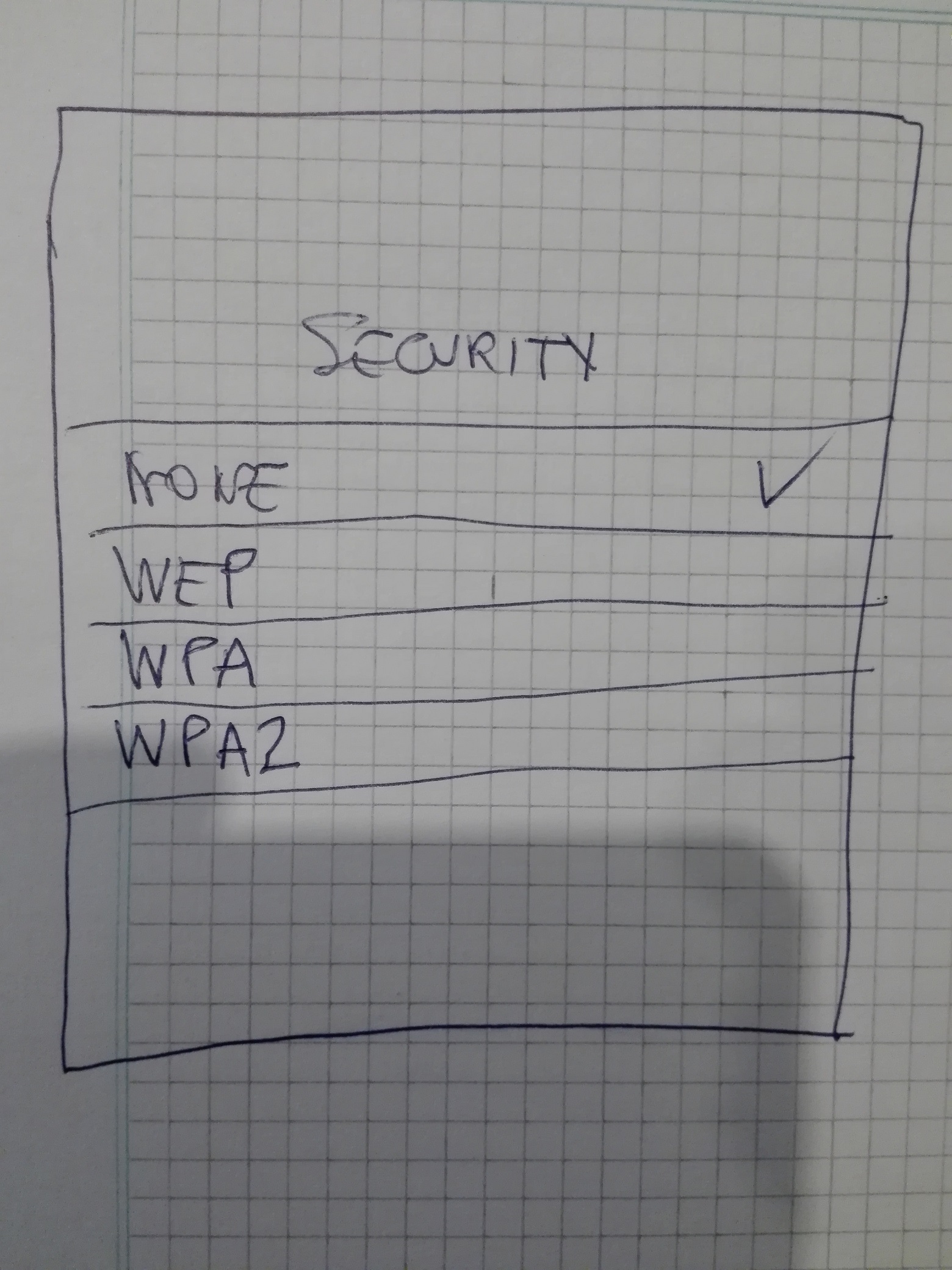

With the exception of the test with a network cable, I have proceeded with everything else and follow the message of "The connection failed, wrong password"
I found that the security selection does not match, I think I should select WPA2, but I'm not sure .....😕
The sketch by hand is the configuration in the smart phone.
The photo on the screen corresponds to the WI FI connection properties of the netbook.
What do you think ? I do ?
Thanks friend 😉

For sure the type of security it should match both sides. You should also remember which security type it was when you created the password first time. The pass is encrypted very different, or not at all, function the type of security. You can also use "None"on both sides, and see if it works so.
Also when connecting the network cable, it switch off the Wifi section and so a kind of reset occur in that section. It could be beneficial a such experiment in your case. The cabled connection does not ask for, or it need a password.
When about the virtual keyboard on the phone, no matter which keyboard app is used (Google or whatever), a language selection is available in its settings. If you had the keyboard selected for English when creating the password, and then you may key in the pass on a keyboard set it on other language, the keys are not encoded in the same manner, even thought you may not see important differences on how it looks the keyboard on your screen. This detail it is important when about keying in a password.
If you (created) typed in the password from a (for say) English keyboard (on your mobile or on a laptop), you should retype the same password on a keyboard also set it for English. If the language does not match next time you type in the pass, the targeted device may not recognise the keys encoding and password will fail.
Hi Coris
I did as you recommended, I used the Oppo Sonica directly with the network cable for a few days.
Then, I disconnected the WI FI router for a whole day, I re-entered the same password that was not recognized before, and now yes !🙂🙂😕
Thank you very much, my friend, it has been a great help ! 😉
