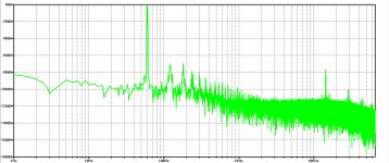

One day when wanting a project I tried this. The LM324N was the worst possible choice. The 324 has very bad crossover distortion as it's seemingly unsolvable problem, so solve that first. By adding a 3K3 resistor to each output I could remove that problem ( to - ve rail as shown ). The final bit of thinking is an inverting buffer that could by cancellation remove the compromise that was caused ( curve distortion of SE class A ). As this is a very cheap circuit it might be worth a try. The limiter is both good and bad. The limiter graph shows the good side as it is nicely on it's way to being a sine shape. LED's tend to be better than many things as voltage references. 3 times better than a 1N4148 I think when temperature changing output. The point where I take the limiter output from makes the 750 K value something that needs adjustment, that's the bad bit. Even so it shouldn't be hard to find what it needs. Try the highest value you can. 2.5 Vrms suits the LM324N. It is a sweet spot. Using 2 x NE5532 could give lower distortion. I doubt it will as the frequency is low which does much to hide LM324N's problems. Most of the distortion comes from the limiters square - sine compromise.
I didn't do this circuit for showing here. Just a bit of fun. If you look the spectrum is very a OK and a useful 2.5 Vrms. You only need adjust one side to get minor speed adjustments. It will provide all that's required in terms of ppm and very small adjustments. COG/NPO usually are 30 ppm, with many resistors this can reduce to about 15 ppm total. It can be that using higher grade resistors makes it worse ( 50 ppm verses 15 ppm ). I was told COG are made to work well with the old MRS25 type resistors which set the style of others. Like many stories it might need checking. 2 x 318 K is about 50 Hz. The two arrowed values ( 10 K used ) are the ones to adjust. To be clear, one side can be fixed and one adjusted if a small frequency change. Try both sides. Ideally a small voltage rise with frequency. In theory you need that. It is possible you can even get 45 RPM using just one side. Don't rule out needing 20% higher voltage for 45 to offset the inductance.
This ready made seems far better.
Assembled Low Distortion Audio Range Oscillator 1KHz Sine Wave Signal Generator | eBay
Results of LM324 State Variable Filter Oscillator.
![vHLOIPf.jpg](https://i.imgur.com/vHLOIPf.jpg)
Here is what I didn't say. Sine and Cosine are included. Although not as good the Cosine is totally useable as mostly the distortion is second harmonic which is less harmful in terms of vibration. The high order harmonics will be filtered by the motor inductance so can be ignored. I would encourage you not to use my circuit if wanting first time sucess. The SVF at ESP Audio is a better version. However this simple circuit is not far from what is required.
