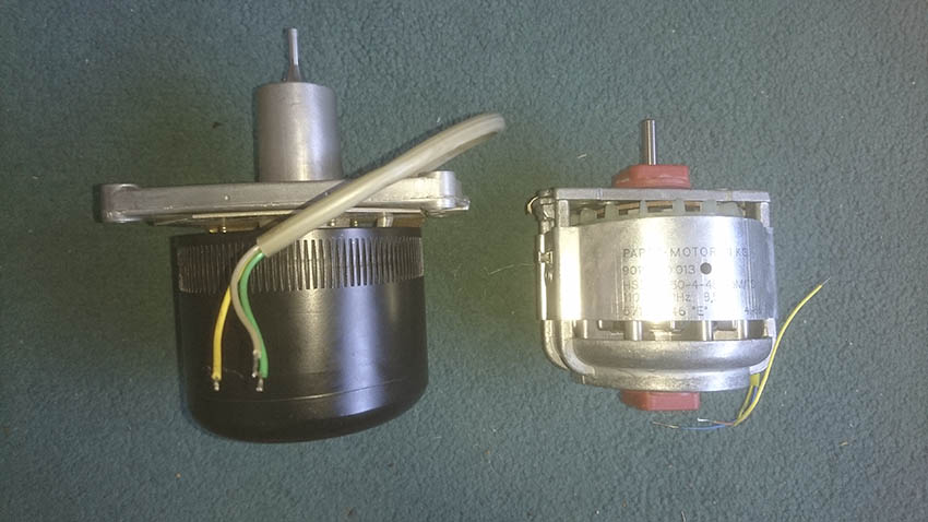

What kind and how big is your power supply? This 6 wire motor is nice but large. We are guessing that the mean well 24v 150watt 6.3 amp power supply is right on the limit.
For example the motor will start to run at 25 volts slowly then if you bring the signal it will increase rpm until reaches around 50 volts then the power supply drops from 24 volts to the amps to about 12v. Also if you hit the power supply with max signal it does not go as high as if you bring it up gradually. So the conclusion we came to is the protection circuits in the power supply is kicking in never allowing the motor to lock in.

I'm still waiting for my 6 wire Papst (probably stuck in customs )
I'm hoping my smaller Papst (in the picture) is similar in size to the original one used in the Thorens TD124. it's 64mm (~2.5") across the outside of the rotor.

Well good news or bad news depending on your goal. The motor is pretty big. The outer steel band is 3.650"Dia. Black fan looking plastic part 3.219 dia. Bracket height 2.820. Mounting plate 3.387 sq. And the shaft is 8mm dia.
Weighs in at 2lb 12 oz.
I am guessing this will be the big dog on the porch. But will take up more space and eat more food.

That is a bit of a beast, but in a P*****g contest my revox capstan motor has a rotor outer diameter of 3.5 inches, and weighs just on 4lbs. No wonder it takes a few seconds to get up to speed I suspect however that it isn't a synchronous Papst as the outer rotor doesn't have any visible structure.
