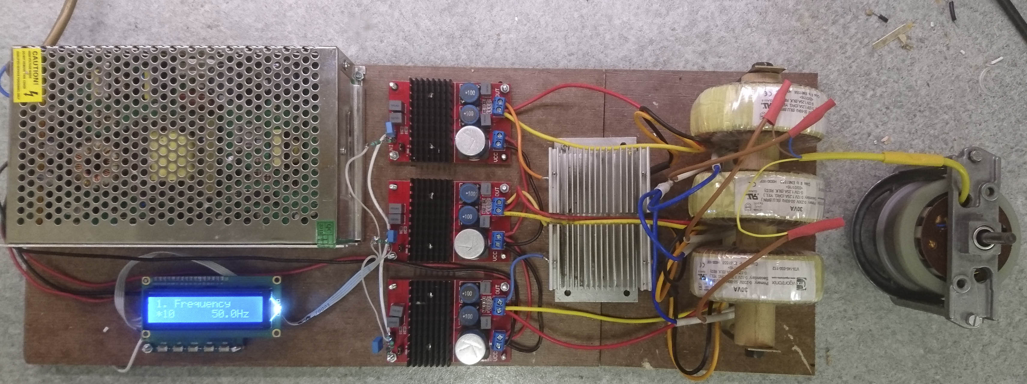

I included the 1 ohm resistors because the amplifiers are specc'd for a minimum load of 2 ohms. I'm only using a 12v power supply so I worked out that an extra 1ohm in series with the transformer should do the trick in limiting the startup current. I actually bought a few spare amplifiers just in case I guessed wrong
I've been running the setup in the picture for a few days almost non-stop. The amps run almost cold, the transformers are at about 45 degC, in fact its only the heatsink over the resistors that get at all hot, and that's easily fixed by the addition of a 12v computer fan reattached to the heatsink.
The motors (I have 2 different Papst motors) run almost completely silently, only a very slight 'woosh' of the air moved by the external rotor gives any indication they are moving.

1) Do you really need those 1 Ohm resistors.
An Amp that can supply 100Watt to 2 Ohm, can supply 14Amp rms or 20Amp peak and that with 3 Amps simultaneously! Most likely way beyond what your motor draws at start-up.
Your Power supply would also prevent that long before with 10Amp max .
2) What is the gain of the used amps, it is not in the ebay description.
Probably some 30dB?
3) The output voltage of the 3 phase generator is supposed to be variable from 1V to 5V rms.
Even 1V is probably too much with these Amps so you will probably need three simple 1:10 voltage dividers in front of the amps?

Hi Hans,
I tried leaving out the resistors and got no output, I suspect the Amplifiers see something too close to a short circuit across the 12v side of the transformer and won't start. Reinstalling the resistors all is well.
I do use a resistive divider on the input to the Amps, I also use a 0.47 uF capacitor across each amp input to reduce/eliminate any 'hash' from the generator.
The gain is, as you suspected around 30dB.
The next stage is to machine a suitable pulley for the motor, then swap out the E50 motor on my TD124 for the Papst, and see if I can detect any difference.
At that point I shall find a suitable case for the 3 phase generator and box it all up.

I'm using 10W resistors for my setup, they're there to stop the amplifier shutting down when it sees an effective short circuit from the transformer at startup. In my case I'm losing about 20% of the power across the resistors and they do get quite warm, even when bolted to the bottom of the heatsink.
Remember though that I'm driving a 3 phase 30W motor
Remember though that I'm driving a 3 phase 30W motor![]()
30Watt motor means 10Watt per phase.
With 15V coming from the Amp's, that results in 0.7Amp.
Power per resistor is I^2 x R = 0.5 x 1 = 0.5 watt.
So 10 Watt resistors are more than O.K.
Hans

Hi Tom,
I didn't choose the 12v supply especially, its just one I had lying around. As far as the motor power requirements are concerned the 30W was a bit of a WAG. The Papst motors are notoriously inefficient; I've dug out my clamp meter and here are the readings of my current setup
Amp output voltage 6.5V per phase
Amp output current 2.8A " "
Remember I am using 12+12 ~ 230V 30 VA transformers (12v primaries in parallel) to generate a 120V supply for the motor
This means that each amp power output is around 20W (ignoring p.f. correction)
A 60VA PSU is running too close to the limit; I would use at least a 100VA unit.
I'm going to try using a 24V supply, and run with the 12V primaries in series, this may allow me to get rid of the ballast resistors, though I will obviously have to adjust the input attenuators for the amps.
