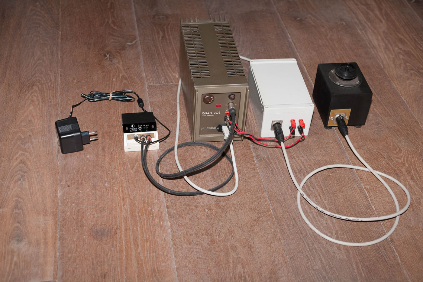

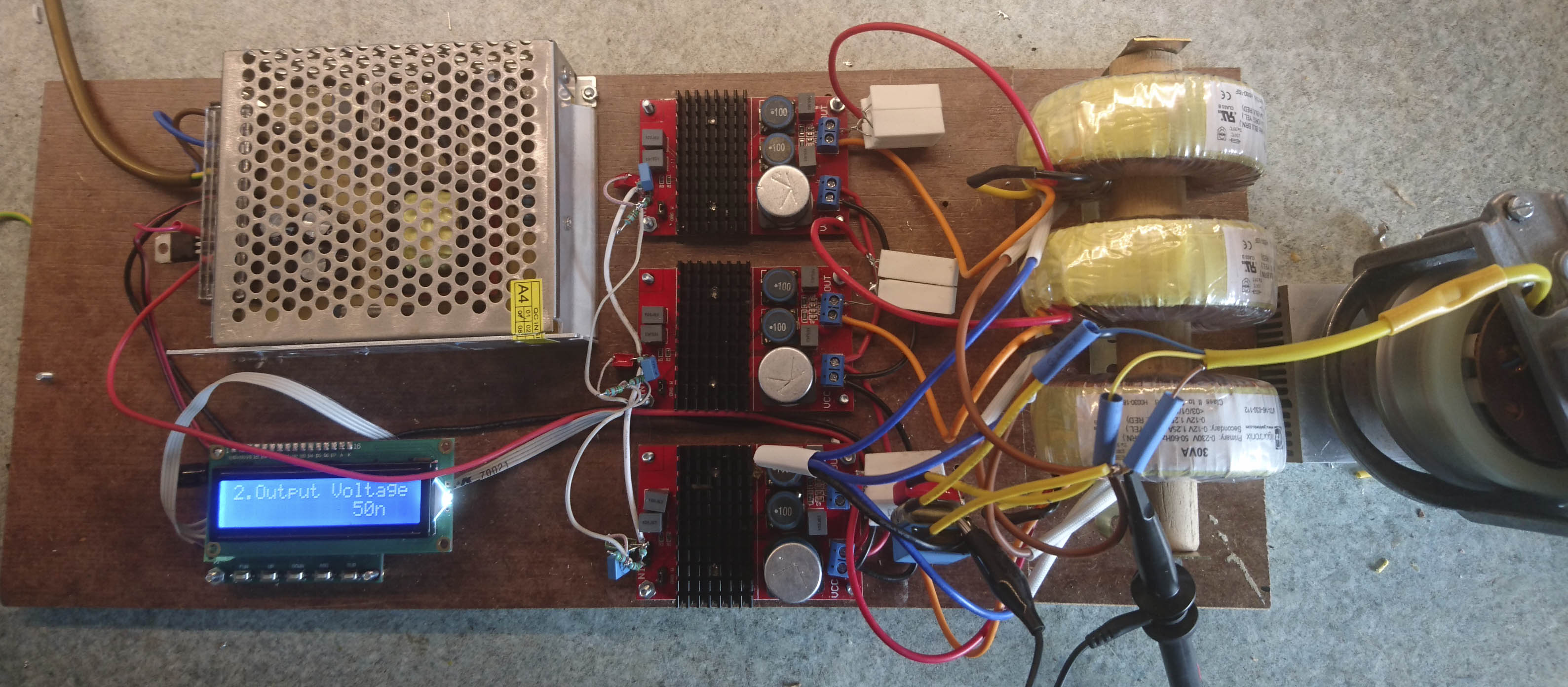

Hi there,
The transformers I am using are 0~12, 0~12 x 230 30VA toroidal
The first time around, using a 12V 20A supply I was using the primaries in parallel, so had 12:230V, being fed by a PBTL amplifier. With an amplifier output of around 6.5Vrms I was getting about 110V at the secondary of the transformer, but with some significant losses across the 1 ohm ballast resistors
I've revamped the setup as follows,
Now using a 24V 5A supply, with a 12v regulator to feed the 3 phase generator.
The transformer primaries are now in series so 24:230V, no longer need ballast resistors, but I've left 0.5 ohm resistors in to avoid a totally inductive load.
I've modified the input attenuator/lpf to allow a maximum amplifier output of around 15Vrms.
I've added 3x0.022uF 250Vac caps across each transformer secondary phase to eliminate any residual hf getting to the motor.
Here's a couple of pictures of the current setup, the first is the lashup version, soon to go into a suitable enclosure, and the second is the neutral - phase output, showing a clean, pretty accurate sine wave, with no HF noise.
I do think this is the most cost effective way of driving a multiphase motor, whether two or three phase.
Please post any questions, I'll try to answer as best I can.

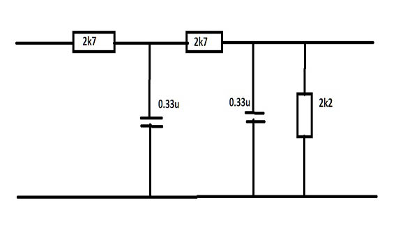

I see 3 resistors and 2 caps at each amp inputs. What these are for? Attenuator as V-divider with some caps as filters or Low Pass filters?

To answer the above questions,
The input attenuator/lpf between the generator and the amp is now as below.
With the supply voltage for the amps increased to 24V I could reduce. the attenuation to allow a larger output swing without clipping.
I have left 0.5 ohm resistors between the amp and transformer as I found that just occasionally, if I had the output of the generator set near the maximum, the amps could still lock out.
It was suggested above that a timed relay could be used to short-circuit the resistors once the motor had started, I do have some small 4 pole c/o relays and might try this, though I find that running the motor at about 75~80V provides more than enough torque.

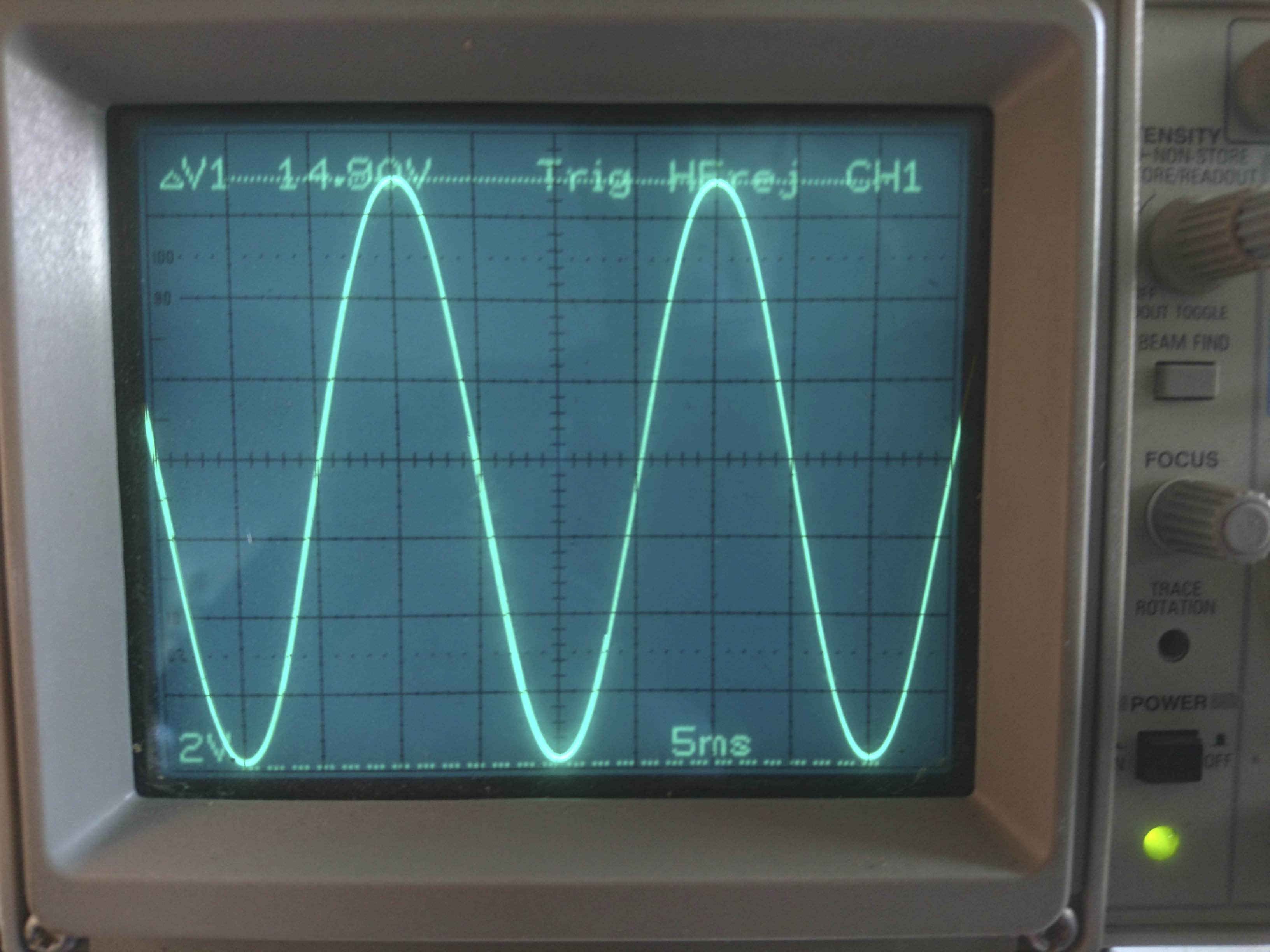

Hi Ralph,
I did not notice this before, but your Amps have only one supply voltage instead of having a +/- supply voltage, making the max output voltage much lower.
The Sine Wave you displayed with a 24 Volt supply has a pk-pk amplitude of 14.9 Volt, which is only 5.2 Volt rms.
So you can never achieve 15 Volt rms (which is 42,4 Volt pk-pk) with one Amp having a 24 Volt supply.
When using the 12 Volt supply, you could only produce halve or some 2.6 Volt rms.
This resulted in at least 3.8 Amp rms in your 1 Ohm resistors.
Now I understand why the got hot.
Using a 24 Volt Trafo now for 5.2 Volt rms input means that the power transfer of trafo drops from 30Watt to (5.2/24) x 30 Watt = 6,5 Watt.
This may be just enough for your application but is probably saturating at start up.
That's why you still need 0.5 Ohm serie resistors.
More optimal would be to pick a trafo that better fits your needs.

Hi Hans,
Sorry, but the information you gleaned from my pictures wasn't quite correct.
I'll go over it point by point:-
First, you are correct that my amps are single supply, but I can achieve 15.65V rms using a 24V supply, before visible distortion occurs.
The amps drive power in both directions, not relative to ground "PBTL".
At this point the voltage at the motor is 109.5V rms, more than enough; I don't think I shall need more than around 80V.
What you saw in the picture as 14.9V was actually 149Vp~p ( x10 probe on scope), and was taken from the neutral tap to one of the phases, giving a phase~neutral output of 52.68Vrms, this corresponds to a line voltage of 91.24V.
If you look at the photo of the setup you will see that the output set to '50', there is no visible distortion at 60
As far as the need for the resistor to avoid saturation, I suspect you are right, but the addition of a timed relay to switch out the resistor should fix this.

My setup is already live and working trouble free for some 10 years.
The reason I constructed this, was because when putting the needle of the cart on an LP with the belt removed, but the motor running, I could clearly hear Rumble.
The research that I started resulted in this setup, where I heard no rumble at all.
See posting #25 for the measurements I did recently to show that even while playing an LP, in this case thus with the belt driving the platter, no signs of Rumble are visible in the spectrum, other than the "rumble" coming from the LP.
Since it is so long ago that I made this, I can't remember the details of the toroids, other than that they are 15V/230V and at least 30Watt each.
There are no stickers on them to do some detailed searching.
Hans
