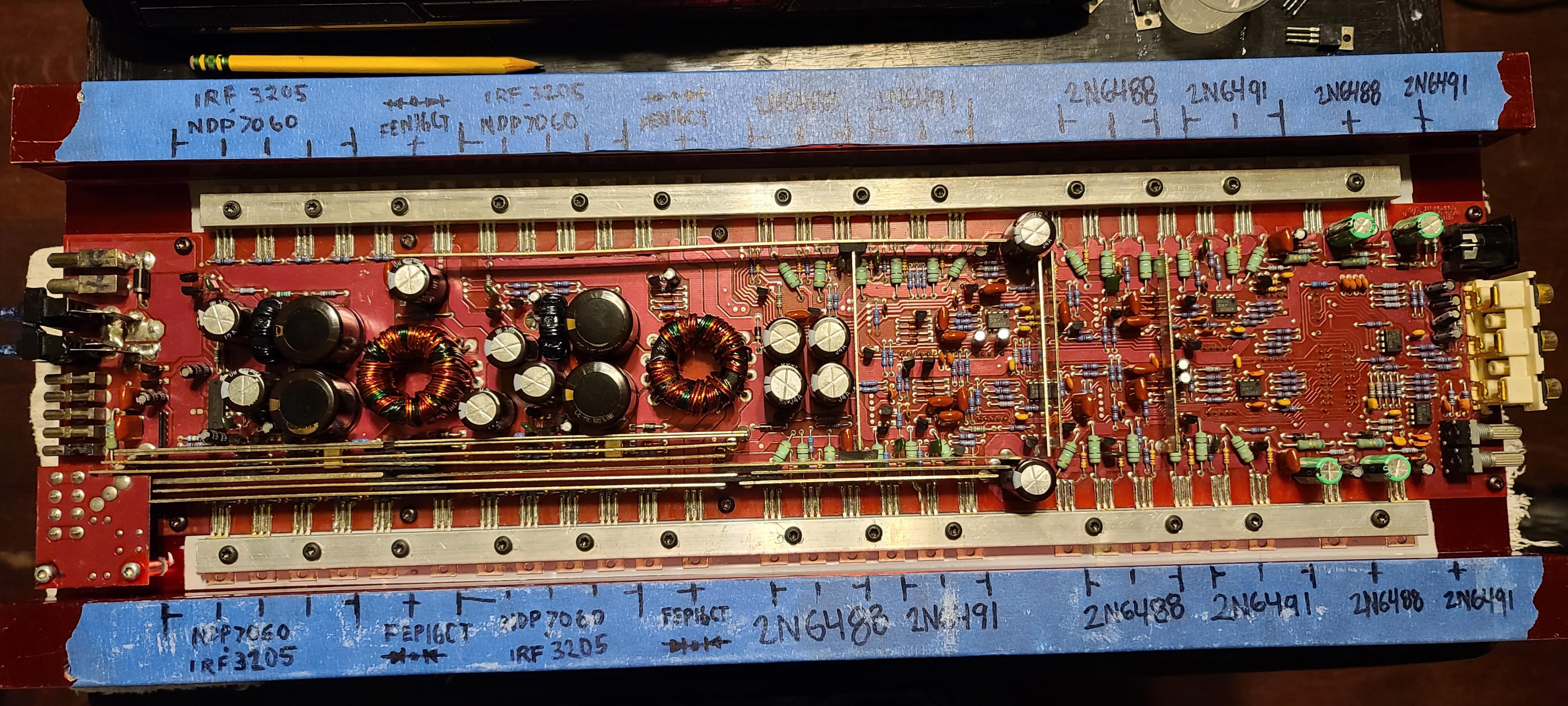

Top right of the datasheet explains the suffix. Look just right of the giant picture of the part and you'll see the pin configurations and suffix.
CT = Center Tap.
The replacements you order need to have both Kathodes on pin 2 for the FEP and both Anodes on pin 2 for the FEN.
CT = Center Tap.
MUR1620CTRG = FEN16CT
MUR1620CTG = FEP16CT
The old marking gave the polarity in the prefix FEP = positive, FEN - negative). The newer markings have the prefix of all, the same (FEP), regardless of polarity. The pin configuration is determined by the suffix (xT, xTA, xTD, positive, negative and doubler, respectively).
