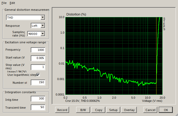

1kHz THD vs output voltage measured at my LatFET-Mono-Block.
I used an old laptop lenovo X201, soundcard EMU-tracker, 30dB voltage divider and the software "STEPS" from ARTA. You see a laptop screenshot here:
