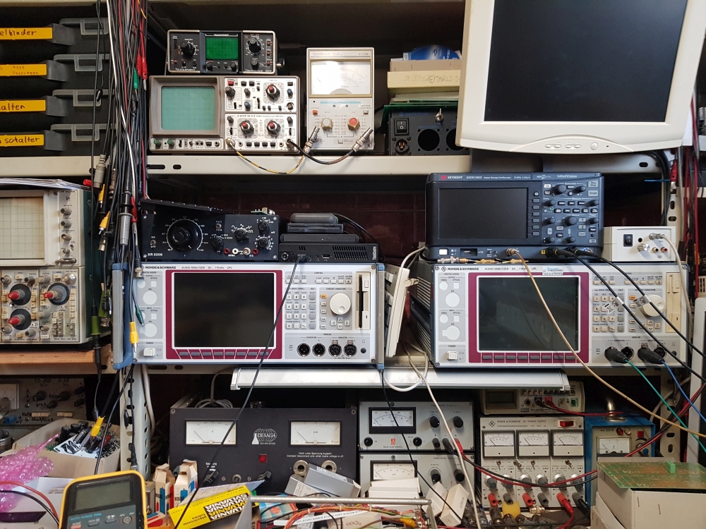

I use also a Keysight 1202 G together with my Rohde + Schwarz UPL , because the UPL bandwidth without B1 option is limited to 21.750 kc .
Kind regards , Alexander .
