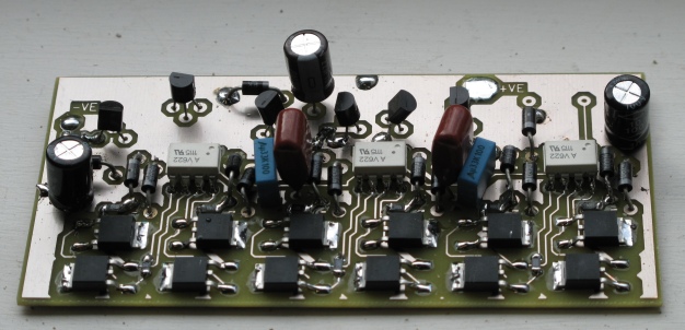

I've had the technique of making good quality PCBs sorted for a few years now, it certainly comes in handy with things like this. As the PCB for the relays had been designed a while ago, all I needed to do was remove the relays and replace them with the fets + opto. The rest was up to Farnell's next day delivery service and of course having an amplifier that doesn't work correctly can be quite an incentive to do something quickly!

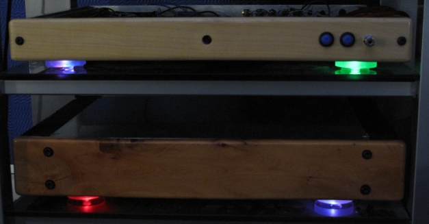

The case that the amplifier (and above the DSP/Preamp ) is in has glowing feet. These are RGB LEDs that cycle through a variety of colours. When the protection triggers, or the amplifier is first turned on, the feet turn off, lighting only when there isn't a fault present.

Well here we go a 6 channel solid state relay based DC protection and turn on thump remover.
This is based around the FR3607 MOSFET produced by International Rectifier and the ASSR-V622 MOSFET driver produced by Avago. The delay and detector is based on the design by Rod Elliott. I'd had Rod's design implemented around some Omron sealed relays, but after a year things started to act up.

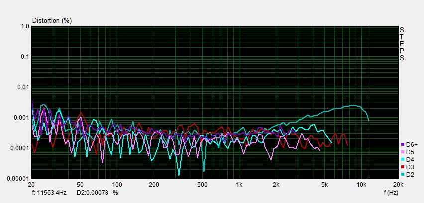

A few days ago I decided to measure the distortion performance of my blameless 6 channel, just to check that things hadn't gone out of balance, needless to say one channel had gross 3rd order distortion. At the time I didn't bother to investigate why, then a day or two later I noticed that one of the drivers in the active loudspeakers wasn't producing much sound. Turned out it was the contacts in the relays and a day or two later another one stopped working properly too. I had spotted this thread a week or two ago so it couldn't have come at a better time!
The solid state based relay works great and, here's a distortion sweep of the channel that was previously misbehaving.
As you can see, problem solved
