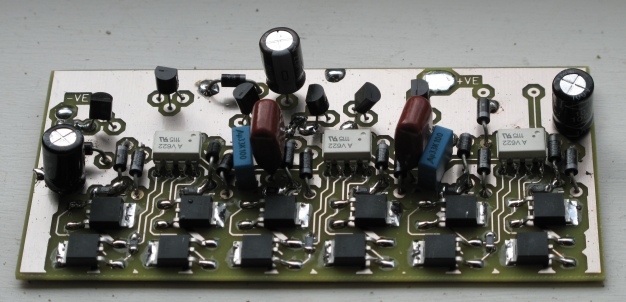

Well here we go a 6 channel solid state relay based DC protection and turn on thump remover.
This is based around the FR3607 MOSFET produced by International Rectifier and the ASSR-V622 MOSFET driver produced by Avago. The delay and detector is based on the design by Rod Elliott. I'd had Rod's design implemented around some Omron sealed relays, but after a year things started to act up.

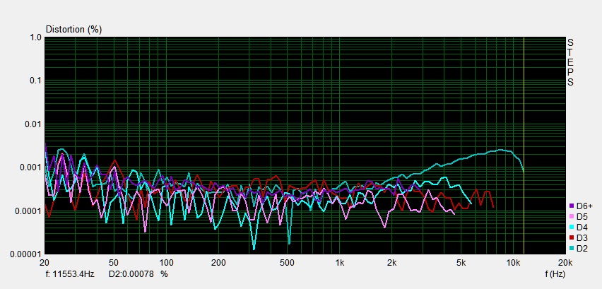

A few days ago I decided to measure the distortion performance of my blameless 6 channel, just to check that things hadn't gone out of balance, needless to say one channel had gross 3rd order distortion. At the time I didn't bother to investigate why, then a day or two later I noticed that one of the drivers in the active loudspeakers wasn't producing much sound. Turned out it was the contacts in the relays and a day or two later another one stopped working properly too. I had spotted this thread a week or two ago so it couldn't have come at a better time!
The solid state based relay works great and, here's a distortion sweep of the channel that was previously misbehaving.
As you can see, problem solved
That's great, and really interesting to hear you mention the distortion and the actual contact problem effecting driver output audibly.
This has got me wondering you know... months ago I played around with a SPL meter at lowish levels with sine wave testing. Just for curiosity to find nulls etc in the room. Anyway the output from one speaker was "distorted" at certain frequencies. I put the ear plugs in and turned up the level higher and the distortion seemed to reduce and ultimately it dissapeared. On music there was no hint before or after of anything ever being amiss.
Could this be a relay contact issue ?

Wow that was quick, and purdy too! Mine is still on the fugly perf-board setup I kludged together so many years ago, I'm kind of lazy like that, and it still works as good as day one. And it goes to show how great minds think alike, I'm using Rod Elliots DC detect/thump eliminator for the front end of mine too. Good work.
