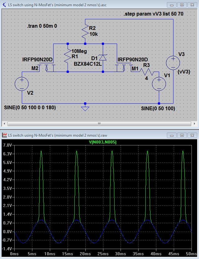

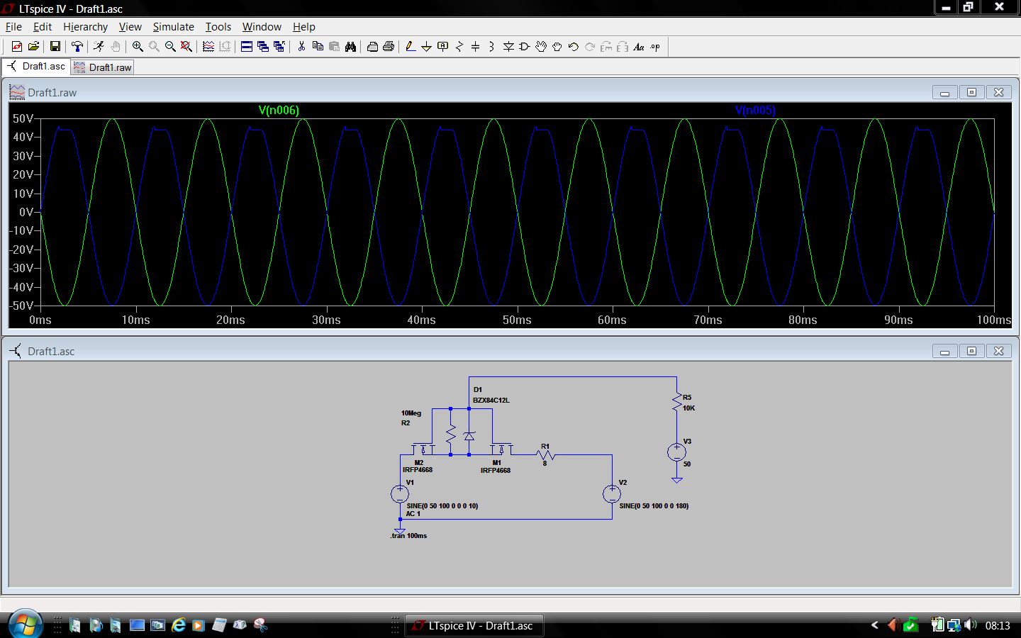

Unless I'm missing something it's easy because the FET's are ground referenced.
It's just a variation of this,
http://www.diyaudio.com/forums/solid-state/191449-output-relays-12.html#post2655631

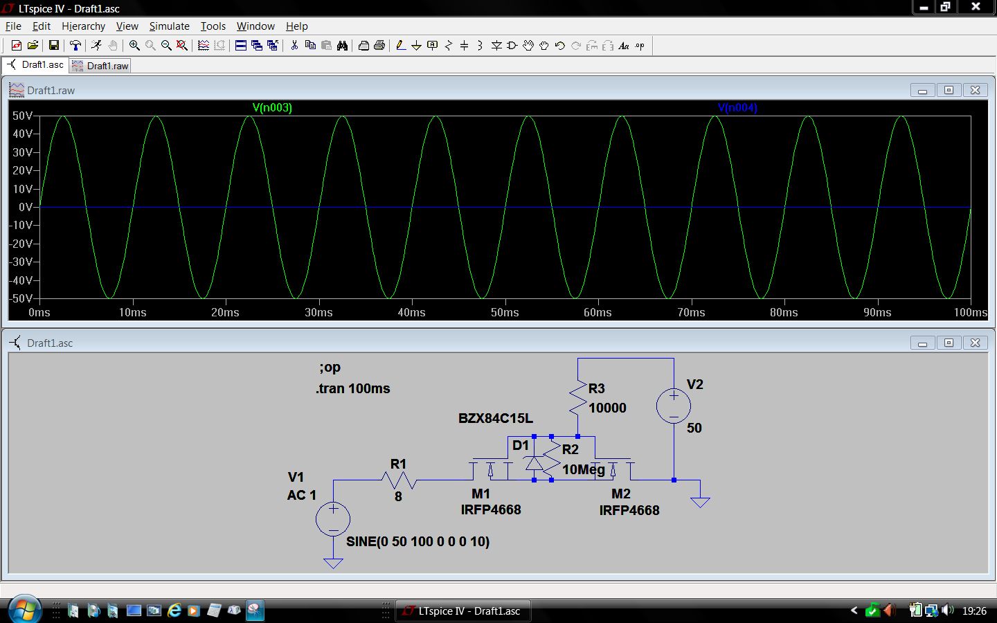

Which seems to work OK as shown here. First pic is switch on. Blue trace is voltage on R/H end of 8 ohm load... zero volts.
But, as I noted, this (referenced to ground) will not work for bridged amplifiers.

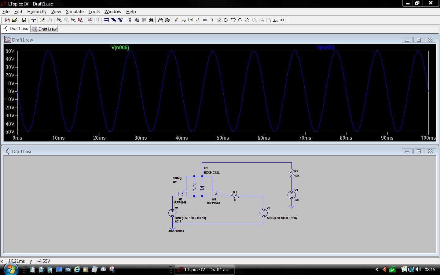

So you move your reference point.
Mooly has it. But I used a slightly more complex drive circuit. I will post something up later today if I remember. For a bridge amp, you would have to reference accross both the supply rails.
Yes, and in the example here which seems to work OK you need to be able drive the fet gates to higher than the positive rail. Or more correctly to maintain at least the Vgs required to keep the FET on. I left the drive at plus 50 volts to show the "clipping" that occurs if you don't. Change V3 to 55 volts and the clipping goes. In practice it's easy to arrange a sub PSU rail with a voltage doubler to get a higher rail.

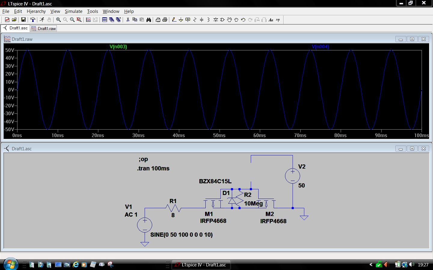

Green trace is V2
Blue trace is other end of 8 ohm load
In the second pic the blue trace is overlaid on the green showing no voltage across 8 ohm.

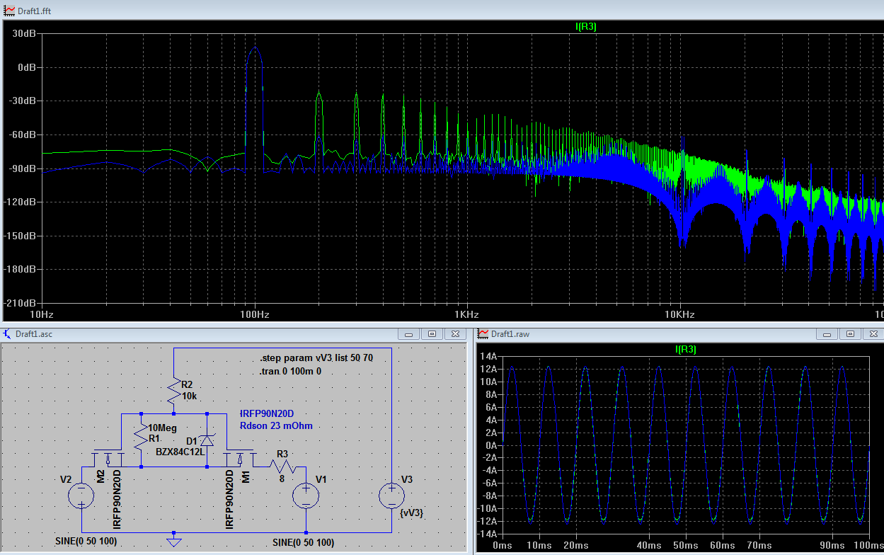

That is not going to work, have a look at the green line in the FFT plot (that is V3 at 50 Volts) if we use 70 Volts then it is way better (blue line) but we need an extra power supply (just to drop the opto).
P.s. you can also see (blue plot) what 46 mOhm is doing, not a pretty sight, we need to get at the least 10 times better to be acceptable (5 mOhm?).
P.s. It also gets worst in real life, my amplifier will be running from +/- 80 Volts and it will be used to drive a ‘Carver Amazing Platinum edition’ magneto static dipole, this has a rated impedance of 4 Ohms. Under the same conditions that will be current (worst case) over 30 Amp’s (at 80 Volts).

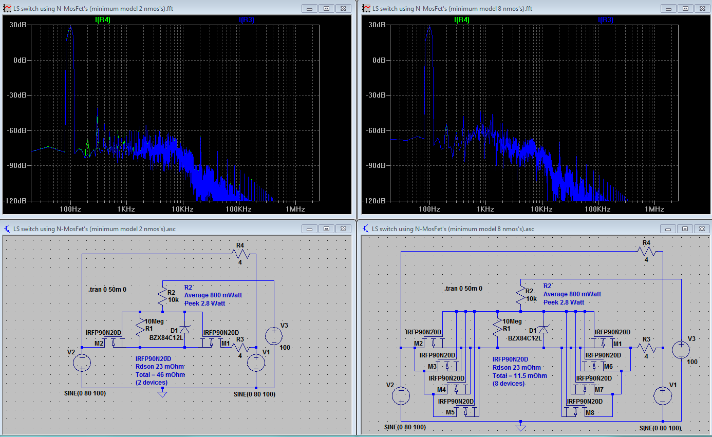

Here a few more FFT's, left side for 2 devices (46 mOhm) and right side 8 devices (11.5 mOhm). You can see a significant degradation of quality in FFT left (compared are the IR3 and IR4). It would be advisable to get the switch at around 10 mOhm (the FFT shows no significant effects at that level).

Here is the voltage across the switch, at 50(green) and 70(blue) Volt gate drive (V3).
That is not going to work, have a look at the green line in the FFT plot (that is V3 at 50 Volts) if we use 70 Volts then it is way better (blue line) but we need an extra power supply (just to drop the opto)................
It does work
I cobbled it all together just to try and see if the basic idea was workable for a bridge amp without using an opto and it is.
Your specific requirements are pretty severe current and voltage wise (not that there is any problem with that) and so you do need multiple FET's and to drive them at a high Vgs at all times.
As you say, "but we need an extra power supply (just to drop the opto) ". The voltage doubler I mentioned is easy to implement but ultimately I think the photovoltaic couplers are the most elegant solution for this as they need no level transition from whatever drives them.

O.k. let’s agree on this (although I never would advise cold side switching), you can switch ground when you are sure that you never are gone bridge the amplifier(s).
There will be a penalty (quality wise) when Rdson total is higher than 1/1000’st of the loudspeaker impedance (e.g. with an 8 Ohm loudspeaker you must have a switch with an Rdson below 80 mOhm) (the penalty being at -60 dB).
When using 4 Ohm loudspeakers you need to have a shitch of 40 mOhm (or less), when you bridge these you may want to halve this to 20 mOhms.
Yes you can do without the opto when bridging, but you will need an additional power supply. As the additional power supply will be more expensive than the opto this approach is not advisable (especially (when not using the opto) when you take into account that you need switch the full rail voltage).
I would advise to switch the ‘hot’ side always, you never know when (and who) is going to use the amplifier bridged anyway.
Then there is one more issue, you need to drive the gates fast (very fast) to stay within SOA bounds of these devices (even when using multiple, you need to consider that there is always one that switches last, and thus takes most of the load). For this purpose you need multiple transistors and maybe a bit more, using those opto’s specially designed to drive the NMos devices will free you from these ‘extra’ stuff at an cost of only 1.30 Euro’s or less.
