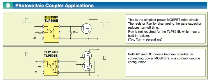

Is there a resistor missing from the diagram?
Or does the driver discharge the gate charge quickly enough to turn OFF the SS relay?to turn the SS relay ON
Yes - you are correct !
A look at the data sheet for the part I suggested does indeed show the need for this resistor. They also have a part with the resistor included inside the package but alas that version is not available from my usual source. I've attached the relevant section from the datasheet.
As you've got two pass devices though, wired in series, surely under that fault condition each would only see ~half the max voltage or am I missing something?
I would agree, but there is the danger of higher voltages when interrupting current flow through inductive speaker.

* The Resistor *
Looking at the value of the resistor I need to place between the FET gates in order to help discharge the gates during turn off - there is a trade-off between the desire for it to be small for high speed but not so small as to load down the opto-isolator.
The chosen opt can provide 12uA into a short and 7V into an open circuit. I figure this can be crudely thought of as a battery with internal resistance of 580k. The gate discharge resistor will load down the output so that it is no longer able to reach 7V. Therefore, the resistor must be large enough so that the voltage at the output of the opt is still sufficient to turn the FETs hard-on. I figure 5V is a safe value which requires a load resistor of around 1.5meg.
To turn off the FETs the resistor must discharge the gates to below the threshold voltage which I'll take as worse case 2V. The voltage will roughly fall off exponentially, the time constant is equal to RC and the voltage will fall by a factor of 'e' or roughly 2.71 during this time. We only need one time constant to turn off the FETs.
I'll take a worse case total gate + wiring capacitance of 4,000pF per gate then with two devices we have to discharge a total of 8nF through 1.5meg. This means the turn-off time will be around 12ms.
Sound reasonable ?
