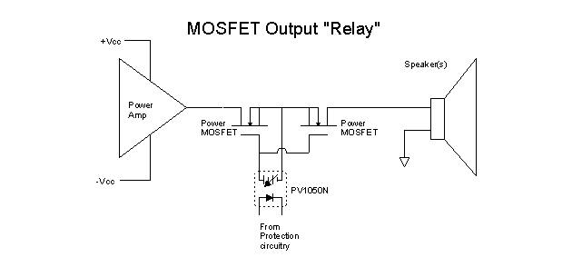

How about this baby, less than $2 and you get a pair of N-FETs in a flat pack,
BSC750N10ND - is it tough enough for the job at hand ?
add one of these... TLP190B and the cost of the 'relay' is $5
Am I looking at the right parts to make this work ?
The diagram is from Geofex, do you think its omitting key components or is it really this simple ?
I'll be using a 'C1237' protection i.c. from fleabay to drive the 'relay's
The dual FET wouldn't be my choice tbh even though it is space saving. Are you OK working (soldering) that package (PG-TSDSON).
Compared to an IRF2907 which I have used the dual has a very high on resistance (62mΩ vs 3.5mΩ). For normal operation that has to be one of the most important parameters for anything other than a very low powered amp.
Tha max current ratings, in particular peak currents and "maximum pulsed energy" currents are way way down. These are very important if the FET has to handle a fault condition and break the resulting current flow.
That really is all that's needed as shown on the diagram. The photovoltaic coupler drives the gates directly.
In general, you are seeking for a MOSFET with very high Vdsmax, very low Rdson and very high Idmax. Regarding Vdsmax, it must be higher than the sum of positive and negative supply rail voltage, and the output should be provided by clamping diodes connected to supply rails, reverse polarized. My tips are
Type Vdsmax Rdson Idmax
IRFB1227 200V 0.0197ohm 130A
IRFP90N20D 200V 0.023ohm 94A
IRF3710ZG 100V 0.018ohm 59A (too low Vdsmax to me)
IRFS59N10D 100V 0.025ohm 59A (too low Vdsmax to me)
The BSC750N10ND part has Vdsmax 100V (quite low), Rdson 0.075ohm (quite high) and Idmax 13A (very low). This would be very unreliable solution to use this part. I also warn against strange manufacturers that are offering this part. You have to count with much higher price than 2 USD per part, in case you require quality.

Is there a resistor missing from the diagram?
Or does the driver discharge the gate charge quickly enough to turn OFF the SS relay?
to turn the SS relay ONThe photovoltaic coupler drives the gates directly.
is it possible, with the diodes in place and diodes across the PSU capacitors, for full rail to rail Vds to be required? If the SS relay were placed in the speaker return lead, could the requirements for the FETs be relaxed?Regarding Vdsmax, it must be higher than the sum of positive and negative supply rail voltage, and the output should be provided by clamping diodes connected to supply rails, reverse polarized.
Good question.
The turn off time for the TLP190B that Bigun mentions is quoted as a 1 millisecond.
The Avago ASSR-V621 that I used specifically has an "active turn off circuit" and is quoted at 0.03 millisecond off and 0.3 millisecond turn on. Substantially better.
I would say even 1ms is quick enough though, particularly when you factor in a conventional DC offset integrator detect circuit.
Or does the driver discharge the gate charge quickly enough to turn OFF the SS relay?to turn the SS relay ON
Further to my above post.
I think I see what you are getting at Andrew.
I would refer you back to here,
http://www.diyaudio.com/forums/solid-state/191449-output-relays-14.html#post2661555
As for the TLP190. That could be considerably slower if there were significant G-S capacitance.
