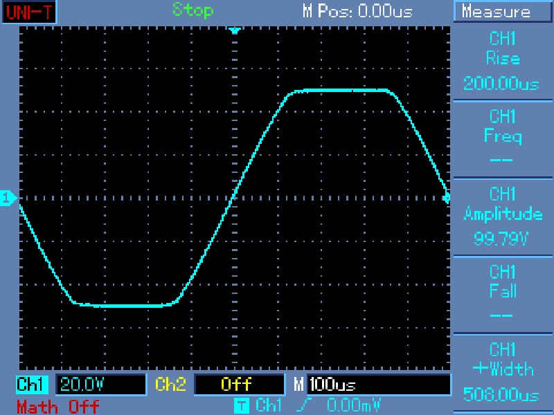

Is it worth checking SOA at turn ON when using these as supply rail relays?
0.3ms is a significant proportion of 1ms SOA at turn on.
The OFF seems to be adequately fast, ~40us delay and then a switching period <<10us.
If used as supply rail switches and particularly if there is a significant rail capacitance to charge then yes, I suppose SOA could be compromised depending on the device chosen.
I wonder if it might make sense to wire the AVAGO outputs in parallel to reduce switching times, the data sheet for the PVI5013 says "The dual-channel configuration allows its outputs to drive independent discrete power MOSFETs, or be connected in parallel or in series to provide higher-current drive for power MOSFETs or higher-voltage drive for IGBTs." It could be a better way to go.

The AVAGO data sheet I have for the ASSR-621 does say that the cells can be connected in series. I think for a speaker relay there is no issue at all with both on and off times.
I went for series connection to maximise gate drive voltage to ensure lowest possible Rds of the FET's
Mike
Yes, this what I will do.

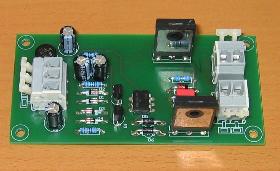

This is the schematics that I have developed. It works well, without problems. It is supplied from center tapped secondary of the main transformer, in my case it is 2 x 42Vrms, but would work both with lower or higher voltage. I can post photos and PCB, if someone is interested.
wow, thanks for sharing this. I'd prefer to use a proven circuit than invent my own when it comes to speaker protection. However, I need a single pcb that will protect 3 channels (HT amp) and I have a couple of UPC1237H chips on order - so my plan is to use this chip to driver 3 SS relays. However, perhaps your circuit is better - not sure I understand the benefits of your schematic.
Yes, thanks Pavel, a very neat job.
Do you feel FET switching is a way forward or would you still prefer a relay given a choice ? Personally I prefer the FET based on my experiences.
D7 ? I'm guessing your running the FET's at least with around 10 or 12 volts Vgs for minimum on resistance. When I was looking for FET's I picked the IRF2907 because of its very low Rds (and I could get them locally
) and run these at around 16 volts Vgs although the 2907 is less well specced for current and volts although fine for lower powered amp.
Any benefit in two pairs in parallel do you think ?

I have evaluated this MOSFET relay circuit for several months in a real 2 x 250W amplifier and there has been no problem. I have also evaluated faulty conditions with switching off the load. The schematics posted is complete. The part is IRFP90N20D. The circuit is very rugged and capable to interrupt higher DC currents than a 10 - 30A relay.
However, I still use a 30A, double contact relay in my power amplifiers for sale. The main reason is that the MOSFET relay does not turn off instantly after power shut down (power switch off). It continues to conduct current, though with higher resistance, until the gate charge is not discharged into gate-source resistor. Anyway, under faulty conditions (DC at the output) it works perfect and saves speakers by disconnecting them in a more reliable way than the standard relay.
Might it be possible to have a second means, another opto-coupler even, to turn off the MOSFETs whilst the rails still maintain some potential. It could be actuated when say, the AC supply is disconnected.I still use a 30A, double contact relay in my power amplifiers for sale. The main reason is that the MOSFET relay does not turn off instantly after power shut down (power switch off). It continues to conduct current, though with higher resistance, until the gate charge is not discharged into gate-source resistor... .
Patel,
Forgive my ignorance, does the scheme include DC detection? thanks
