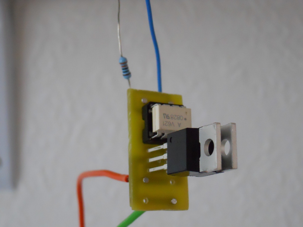

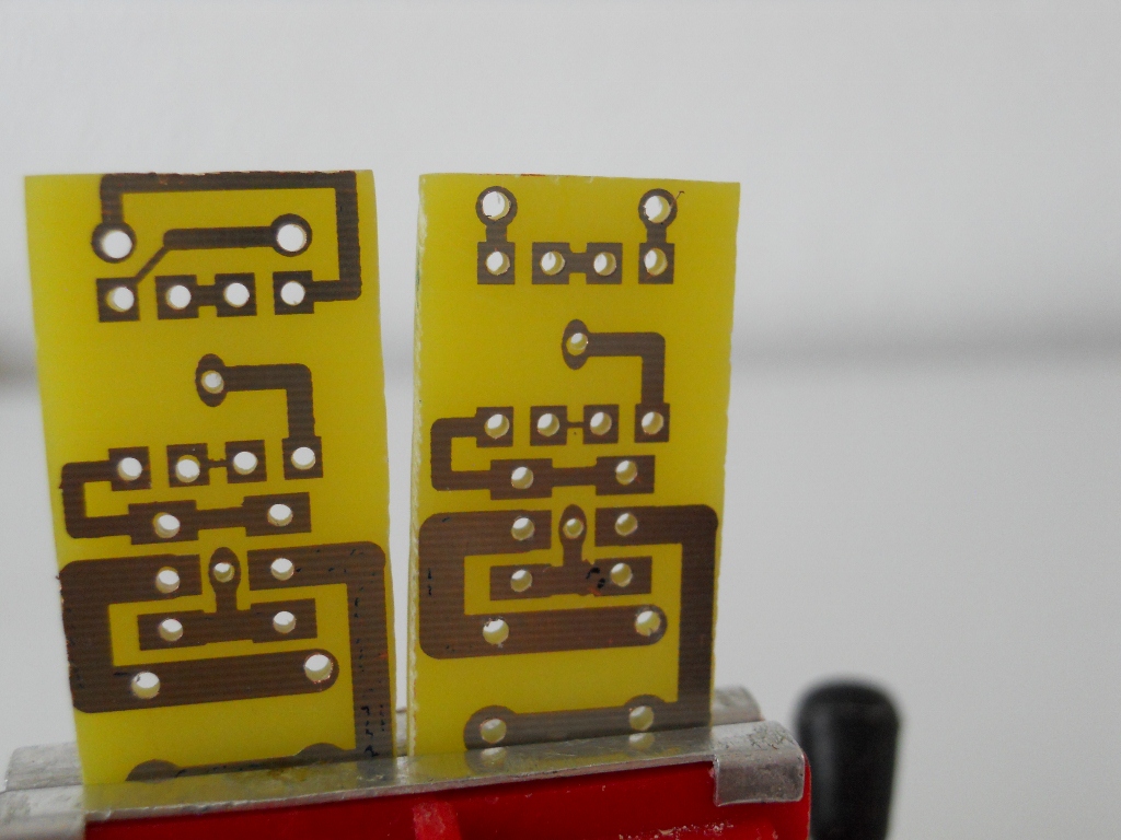

I would suggest that there may be a need for a suitable small circuit board that can be retro-fitted to existing designs or used in pure DIY Builds.
As I am familiar with the problems caused by output relays I have been using crowbar relays for speaker protection for decades. This removes the relay from signal current path completely during normal operation and protects the speakers.
However clearly, if there is a fault, the relay will often melt shut and the severity of damage to the output stage will be increased. It has however served well and I only had the output protection trigger in anger a few times since the 80's, when it did the internal results tended to be quite spectacular, based on the post mortem, but I never fried a speaker from blowing up Amp...

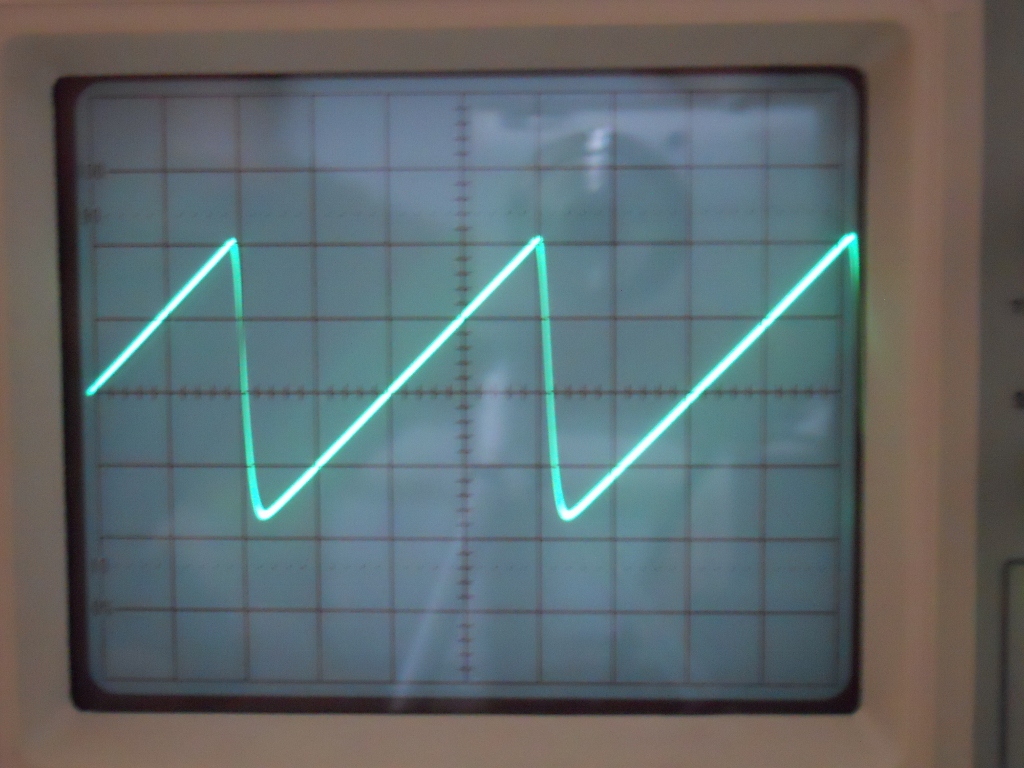

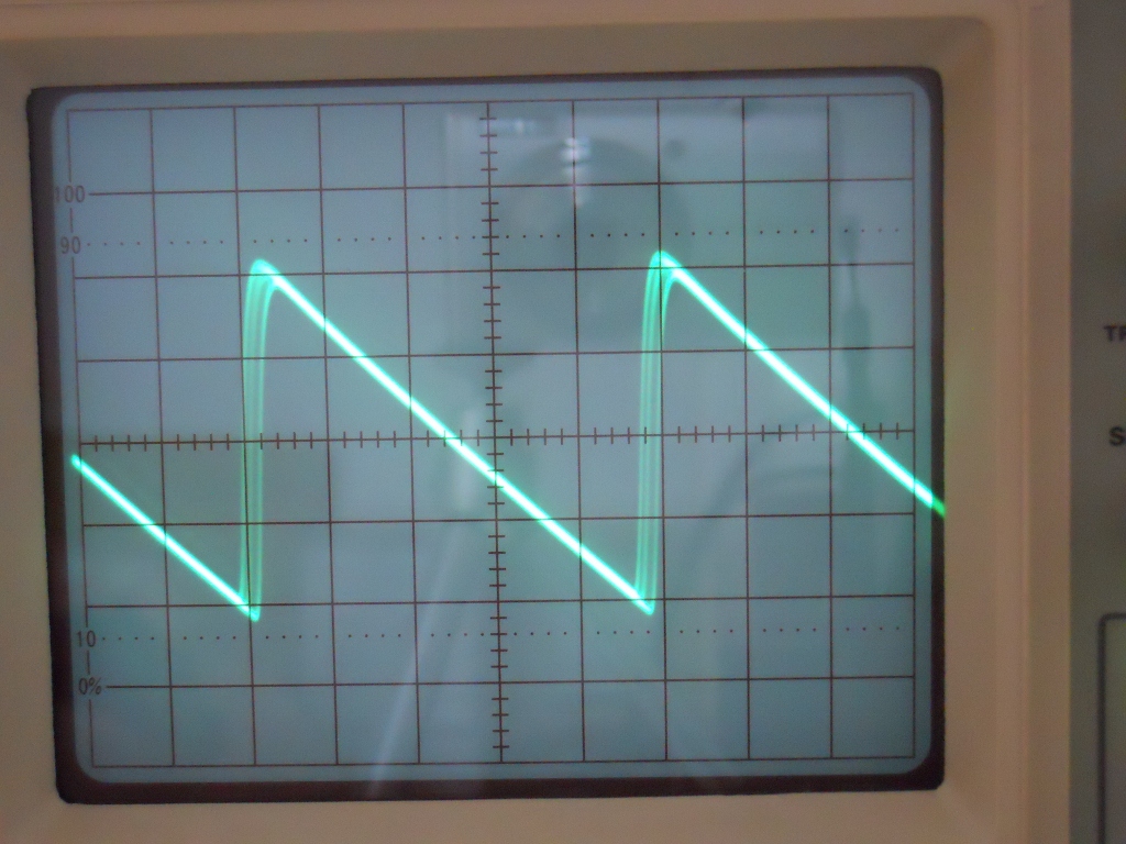

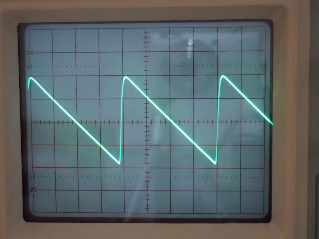

As I am currently again mucking about with a general style solid state Amp (mainly a research platform) I have also been looking at the whole relay question again. This Amp will use fairly expensive lateral mosfets and be somewhat experimental (so I'm expecting the odd protection triggering), so perhaps I may wish to avoid the crowbar relay approach this time...
The approach using Mosfets seem decent based on the measurement results, though not as good as a high quality signal relay but better than the bad examples Bob Cordell shows in his book.
My suggestion for the "diya speaker protection board" would be to use a combination between a solid state (FET) switch and a mechanical switch (high quality signal relay), with interlocked and precisely managed timing.
The idea is that after the FET switch is fully engaged the signal relay can then be used to a) bridge across the Mosfets and b) optionally redirect the feedback around the output switch.
In case of fault or other disengaging the relay is dropped first (maybe with a short across the coil to drop it out as quickly as possible) and then the FET switch actually breaks the current loop. This should normally still be fast enough to avoid frying the bass driver.
If there is any serious interest, let's get going with this and make it as a 3-section board with breakoffs, a single PCB with supplies, DC, RF/Oscillation detection and even the option for a overcurrent/short circuit trip based on either emitter resistors or resistors in collector/supply lines in the center part> Then electronic/mechanical relay combo plus timing system for them on the two outer parts, which may be detached from the center PCB or used together...

I think many want a SS relay that will physically fit where the original is though with no PCB redesign work. That's the beauty of the photovoltaic design. You can make a drop in replacement.

Many thanks for that BV...
My only reservations are that as Vin approaches V2 the FET's will tend to be cut off I think. This was the problem with my first version.
Also in order to mute at power on (to stop switch on thumps) the opto would have to be active immediately... maybe place a high voltage opto in series with R1.

I personally would suggest that retaining a high quality mechanical contact (ideally mercury wetted high power reed, but these are banned in this day and age due to ROHS) as the "final switch" is probably not a bad idea, however this switch should never be the one to make or interrupt the initial contact, instead it will only remove the remaining non-ideal behaviour of the mosfet switch, be it as the signal approaches rails or low level non-linearity (and allow the switch to be included in the feedback loop, see Bob Cordell's Book).
Including a variant of your difference monitor in the design is likely a good idea, we can add a small time-constant to eliminate the circuit triggering on each and short clipping etc., but get a faster response than classic DC protection circuitry.

Well... this thread has really captured my imagination and having experienced now first hand the problem of relay distortion (as mentioned earlier) and not twigged what was going on at the time I decided to see about making some SS relay replacements.
I decided to use the AVAGO photovoltaic coupler type no ASSR-V621 (from Farnell) and the IRF2907 FET which offers a "typical" Rds of around 3.5mΩ. This figure is quoted with 10 volts across gate and source. As each relay would use one ASSR-V621 i decided to connect both photovoltaic cells in series to maximise the available drive voltage.
Test were done as follows.
LED's in coupler were run at 12ma and 7ma to test. Open circuit voltage was 15.26 and 14.72 volts respectively.
Next a 1MΩ load was applied and the test repeated. Voltages this time were 13.93 and 10.66 volts.
Some real world tests were done using an old Rotel RA820 amplifier with the SS relay in series with a 5 ohm resistor. Shots below show the result. What you are looking at is both traces on a dual trace 'scope overlaid. In other words the voltage at each side of the relay. There is no visible loss or deviation before and after the relay. The test was done at 10khz repetition rate at 40 volts peak to peak swing and then at 200 millivolts peak to peak swing. The "distortion" on the positive and negative going slopes on the 200mv shots is due to low level hum from the generator/leads/physical position of generator on top of amp making its presence felt.
All in all a good result I feel. There was no noticeable heating of the FET's even at 40 volts into 5 ohms... maybe not stone cold but definitely not even warm.
The PCB's I made in two flavours as (shame on you Mooly) until I delve into the "Mooly" amp I can't remember what the polarity is of the relay coil connections on the PCB's (it was all pre PC and done on paper... as you do/did) and the hand produced board layouts are long gone.
This little exercise also shows how good Diptrace is at producing excellent PCB's using a cheap Inkjet printer and transparency/UV light box. The IC interconnections are 0.3mm. The dark bits on the PCB are just a bit of ink.
