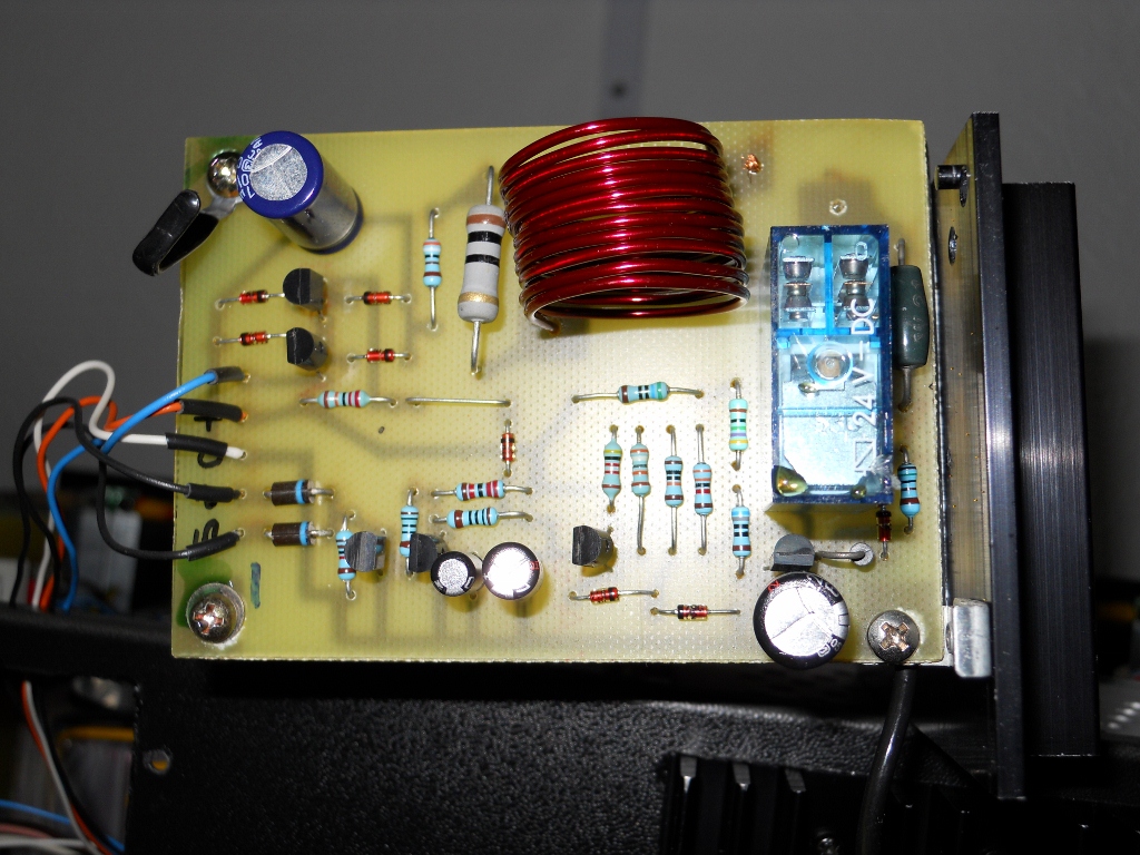

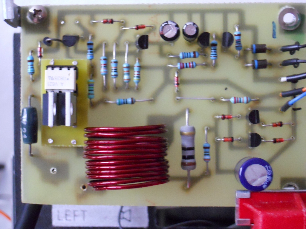

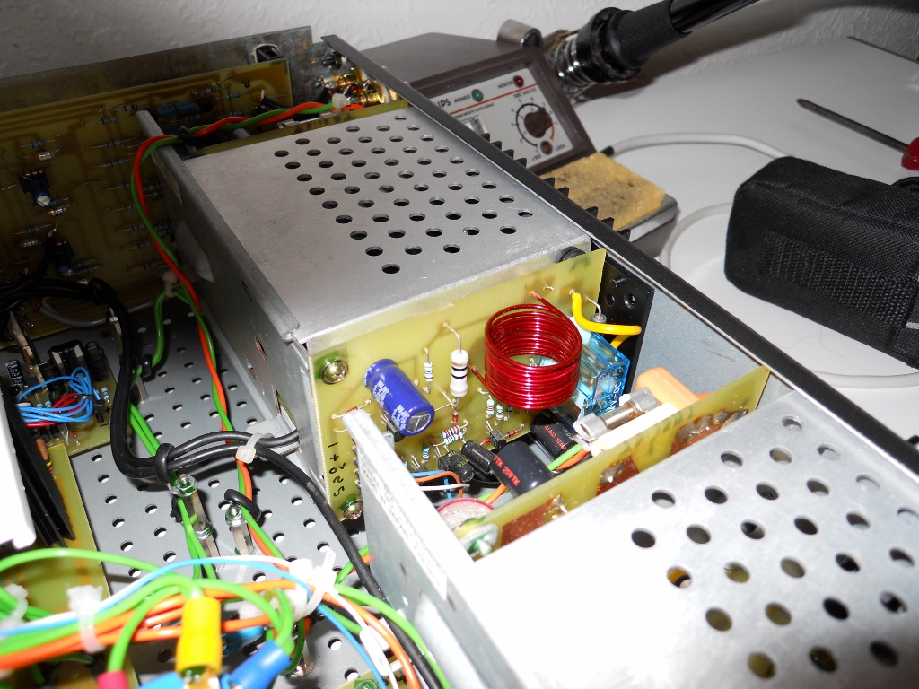

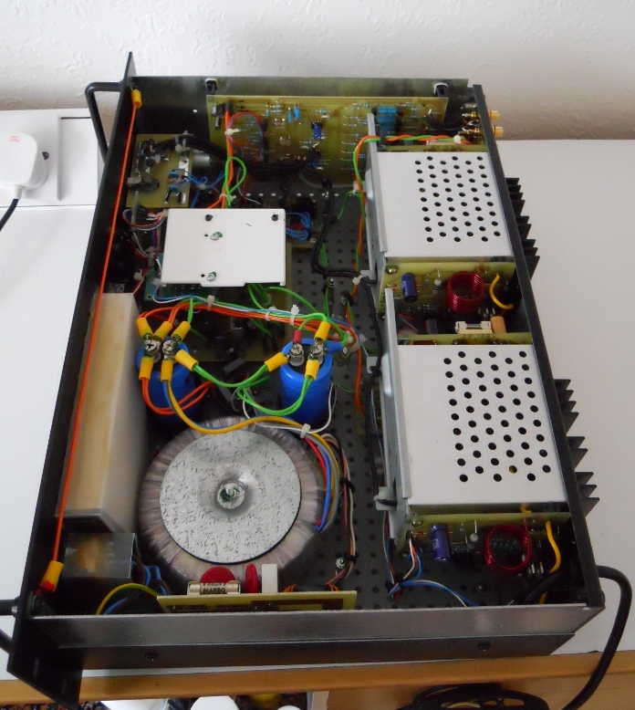

Well the SS relays have just been fitted... time consuming but pleased to report all has gone well.
In the pictures you'll notice a cap (220uF) just below the relay. That had to be removed as it's purpose was to charge to +48 volts at switch on ensuring the relay closed with a definite action the voltage then reducing to give around 50% of the coil voltage. Good news was that the resistor values were spot on and give an LED current of 13milliamps... perfect.
So there we have it :)

Have to say it all sounds very good too. I'm reluctant to say better ! but it just could be because I do tend to listen at what many would consider lowish levels a lot of the time anyway... precisely where the relay issue appears.

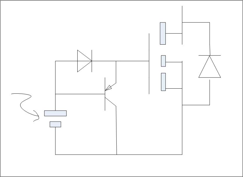

If turn-off time is a concern, would this simple circuit (a diode and a transistor) help draining the gate charge quickly?
That' a classic type of circuit...
I think the turn off time will be orders of magnitude quicker than a relay tbh The photovoltaic coupler has a "quick turn off" circuit incorporated according to the data sheet.
As I mentioned, if I have the inclination I might do a real test.....
It's most likely very much so. However, personally I wouldn't mind putting in a couple extra parts to help discharge the gates despite the internal quick-turn-off circuit. To my understanding if I may, the internal turn-off circuit takes gate charge as its power supply, and it is intended to straddle across the gate capacitance directly. When two of such circuit are connected in series there could be some uncertainty to its behavior unless one knows the details about the quick-turnoff circuit. An extra gate discharge path would then bypass the uncertainty and make it worry-free.
Your idea of making the SSR a drop-in replacement is very cool.
Thanks nattawa,
I understand your thinking on the two cells in series re the turn off uncertainty. We need to measure it to know for sure.
For speaker protection I imagine the integrator time constant of the DC offset detector circuitry will absolutely swamp any small active electronic delays.

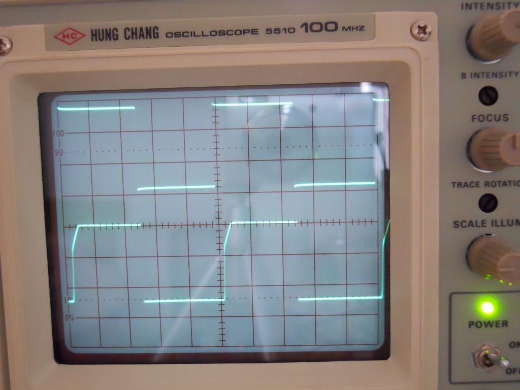

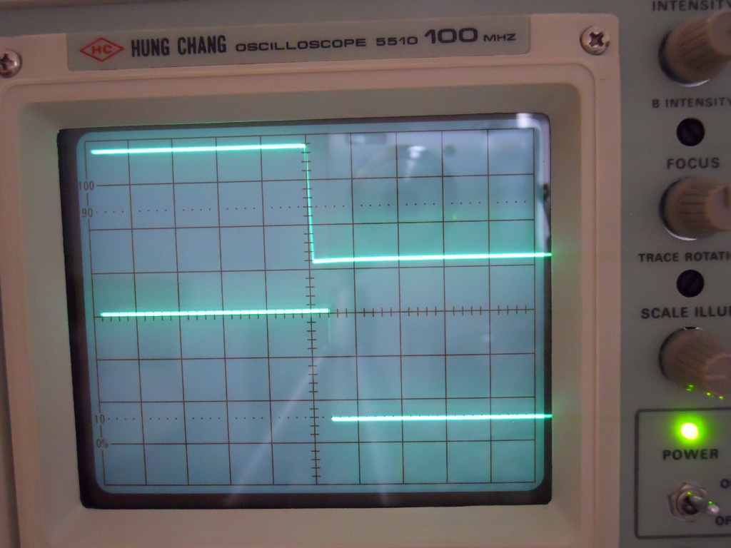

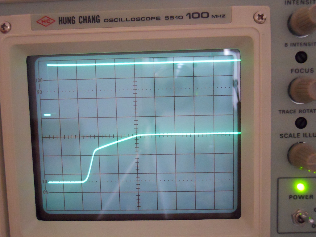

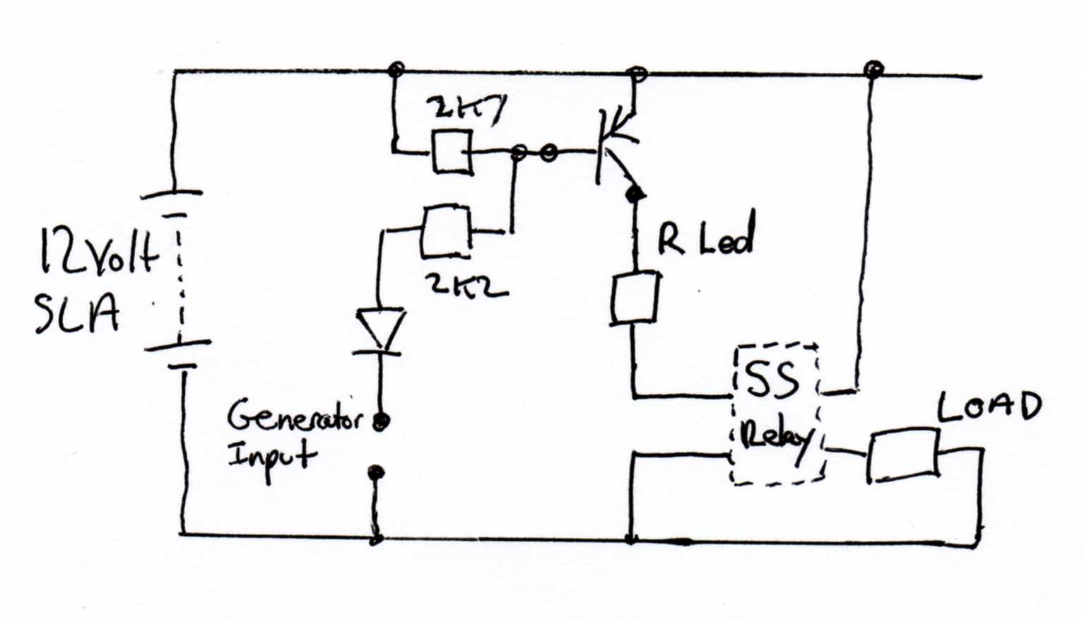

This might be of interest...
The circuit shown below was used with a SS relay of the type I made yesterday post #267 using the AVAGO coupler with both cells and LED's wired in series.
The LED current was around 13 milliamps for the test.
The load switched by the relay was 100ma. Increasing the load to 2 or 3 amps had no real impact on the on/off times or shape of the switching transitions. All that was observed was a noticeable drop in voltage across the load due to the high Rds of the FET's.
The FET's used were NOT of the type I used before (didn't have any) and were an IRF830 and IRF630.
The first shot is a general overview of the switching on and off of the relay when driven at 200hz. At slower speeds the eye can see the transitions are the same but the camera doesn't photograph well at low sweep speeds.
The second shot is a detail of the on time at 0.1millisecond/div. So it takes around over 0.3ms for the FET's to turn fully on. Maybe the gate capacitance charging from the limited drive current available ?
The third shot is a detail of the off time again at 0.1ms/div. So the off time is quick and well defined at around 0.04ms from removal of the LED drive.

I wonder if it might make sense to wire the AVAGO outputs in parallel to reduce switching times, the data sheet for the PVI5013 says "The dual-channel configuration allows its outputs to drive independent discrete power MOSFETs, or be connected in parallel or in series to provide higher-current drive for power MOSFETs or higher-voltage drive for IGBTs." It could be a better way to go.
