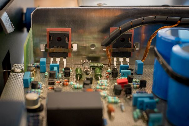

As a small update (of the funny ones )
Client owns a LAB Goupen LP 2100 analog one the old models, well kept using it as a home amplifier with a tiny bit of bias increased .
Got it in for noisy ventilators replacement
While we searched for a ventilator that is quiet enough for the application ( home use ) so the vent need to be quiet on its own but also quiet in the specific ventilation channel we gave the client a P3A as a replacement amplifier.
The first night client realized that the P3A sounded 10 times faster than the Lab Groupen extremely wider ( probably in terms of bandwidth ) and out of the blue he realized that his speakers ( Dynacord VL262) Are no longer up to the task ....
Second night client decided to go and listen the CHario Cygnus speakers and at the shop they tested with advance acoustic Xi 160....
Third night client took the P3A with out my permission to the shop to test with the Chario ....
Beat the crap out of the advance acoustics from sound quality aspects though the Advance was a bit more powered while still the P3A with 60.000 ufd had no drive issues at all and left both the client and the shop owners .... breathless /......
Enjoy

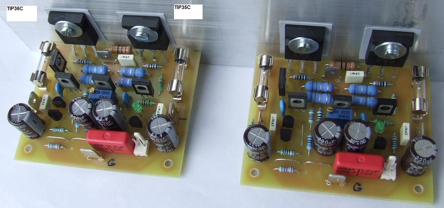

I disagree. The purpose of this build was to see if slower output transistors will work without oscillations with parts values from the original schematics. Based on my experiences, I would recommend to builders to use such transistors, especially if they don't have scope to verify the results. Fast Japanese transistors are not recommended if the builder is not experienced in modifying the schematics and if does not have scope. TIP35/36 (for 35V supplies) and MJL21193/4 (for 42V supplies) are perfect candidates.
The P3 began its existence with slow 2N3055 devices many years ago, so there is little doubt it can be made to work fine with other general purpose power transistors such as TIP35/6. The only question is, just how fine in audiophile terms, is the SQ going to be?

Some of the best sounding amps that I ever heard were not high power and used very slow conventional devices. First amp that comes to mind is NAD 3020, although it was long ago that I listened to it last time. I was never able to find direct relation of SQ with specs of parts used. Very often I find "inferior" parts better sounding. At the end, it all comes to how your amp matches with you speakers. I am using Tannoy professional studio monitor speakers with compression horn HF driver and it's absolutely amazing what can give the best subjective results with them. The other day I built miniature amp with TDA 2005 (bridge version) and small 30VA mains transformer. I was surprised how good it sounded with my speakers. Better than many high end amps.
The main reason that I used Toshiba 5200/1943 pair for my build using original ESP pcb was that they are high power. My main concern was reliability, not the SQ. But, it proved to be problematic concerning stability. They certainly sound excellent in P3A if you can verify stability and correct compensation if necessary.
