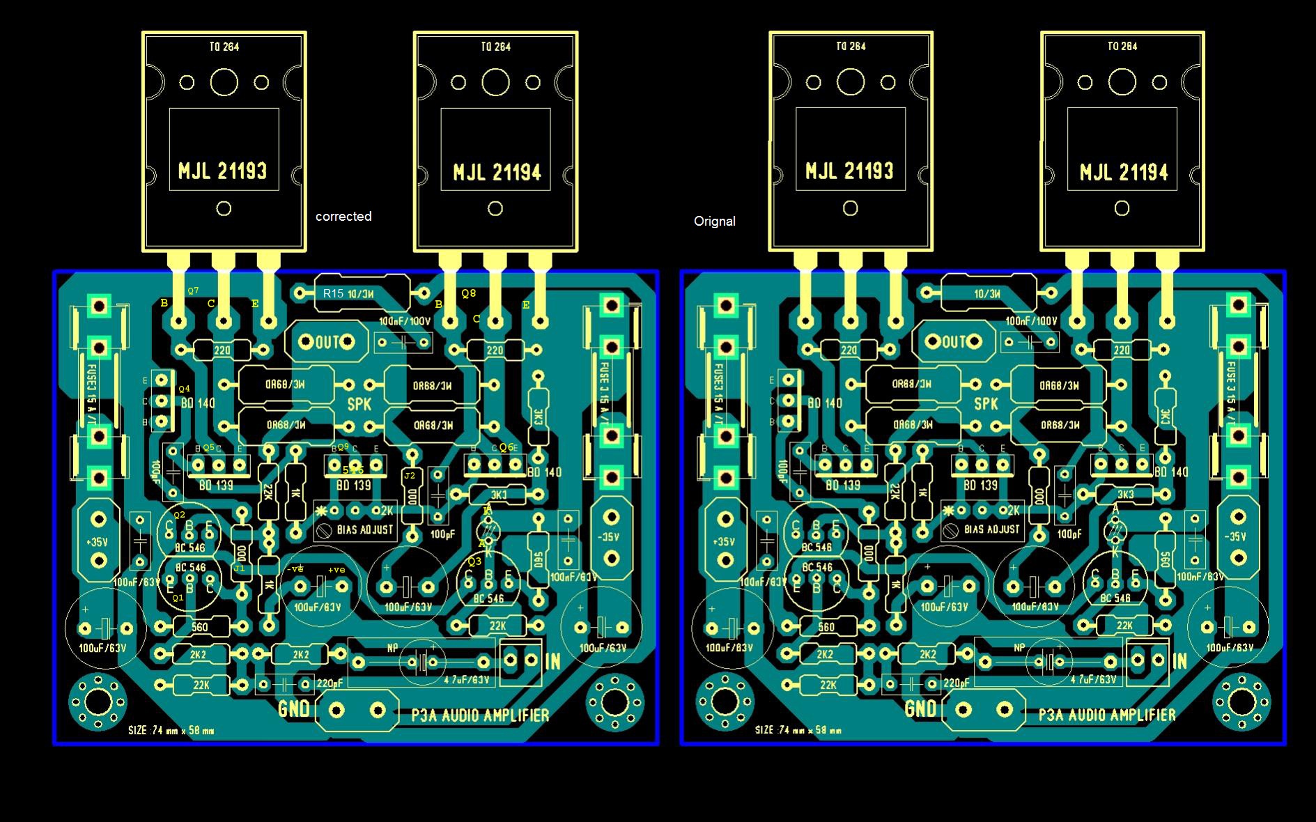

I found a mistake in this pcb.
Green led is in opposite direction.
Hello Thimios sir
I found some error in this layout, I try to correct it, is this modification is ok, Is R15 & C7 connection is right.I think C7 should connect o/p through R15.Please correct if I wrong.
AlexMM pcb is good! It's not necessary to follow the sequence of R15 and C7 from the schematic. They can change places. The sequence in the AlexMM pcb is dictated by the space and layout of components on the pcb.
But Thimios was right about orientation of LED. It should be reversed compared to what is shown on the top side of pcb.
But Thimios was right about the orientation of LED. It should be reversed compared to what is shown on the top side of PCB.
Hello ivanlukic
thanks for reply, What about Q9, Alexmm uses BD139 But as per Rod Elliott sir It should be BC546.
It's not a problem that AlexMM pcb uses BD139 as Vbe multiplier. BC546 has higher hfe and theoretically can correct bias faster than BD139. That's the reason why some APEX circuits use Darlington transistor for Vbe multiplier.
But in this case output stage is CFP (Sziklai) configured. Ian Finch claims that if Vbe multiplier is placed directly on the driver transistor itself it can overcompensate bias. Therefore using lower hfe transistor like BD139 can even be beneficial.
