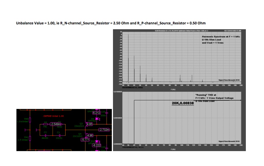

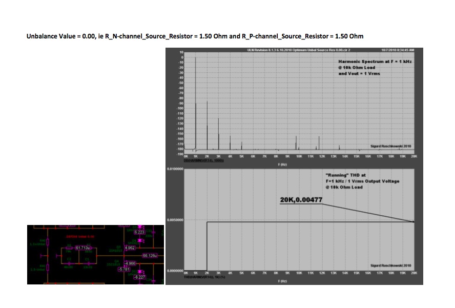

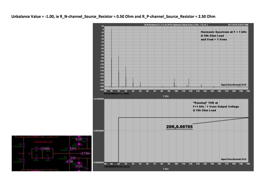

Sigurd Ruschkovski made a distortion analysis for me in a parallel symmetric input stage with N and P-Channel Fets. For example a 2SJ74BL has a Gm of 22mS at 8mA and a 2SK170BL has 20mS at 8mA so the P-Channel is a bit steeper. We put a trimmer inbetween to ground but adjusting it did not change much the distortion unless grossly off.

Here it is :
That meant a different transconductance total between P & N branches?
