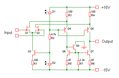

Ok, what I want is a single diff pair jfet input, with folded cascode pnp on each output, then one side of the cascode going into a current mirror, the other cascode connecting to the output directly, and the current mirror also connecting to the output. This will give a high impedance (current out) output, that can drive a PARALLELED RC time constant, consisting of a .047uf cap and 1600 ohms (or so) that will constitute the first 75us time constant of the RIAA. Give it a shot, if you will.

Something like this, John?
Edit: Output compliance will not be great as Q5 is not cascoded.
Also, I worry about the distortion contribution of Q5 and Q8 due to variation of beta etc with collector voltage. For power amps, my simulator tells me this sort of thing is significant. For small signal circuits, maybe not. Then again, maybe it's just in the sim's imagination.
Maybe there are noise issues too ...especially around R3,4,5,6?
One sugestion. Take out the extra cascode. Insert an NPN bipolar. Base to collector of Q6, emitter to the bases of Q6 and Q7, collector to ground. Resistor from between the bases of Q6, Q7 ( ca.1kOhm to 2kOhm ) to minus PSU. That helper transistor makes the Hfe match between the mirror BJts less critical.

Actually is appears at being parallel to the transimpedance resistors. One simple way is to connect a resistor and a cap to ground at the output and measure frequency response. You can then "backcalculate" the output impedance by adjusting the resistor until the desired response is reached. The other ways are simulating or classical mathematics.
I simm'ed the first stage.. get a gain off app 50 dB and quite low distortion...-75 db, nice distribution also.. distortion figures improve when run on higher voltage tried 15 24 and 28 V, but noise may increase... took 7 mA through the fets and 10 mA through the cascode...Nice
