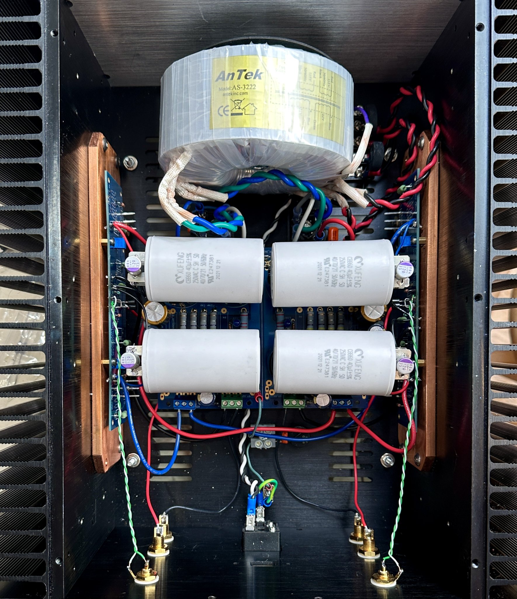

They look like this..
I didn't have my preferred 80uF caps on hand, so I supplemented a set of 40uF with 120uF organic polymer in parallel. The caps are wired into the channel board power & ground connections. The speaker (-) were relocated to the PSU board GND.
The motor run caps are held in place by double-sided foam tape.
