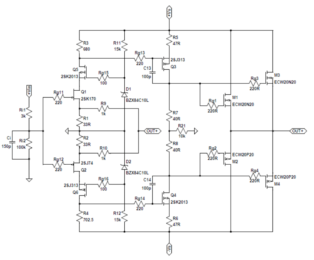

The Holy Grail Follower Output Stage has much lower distortion, which becomes apparent vs. the F5m at higher output frequencies and power levels.
The comparison is not completely fair since my implementation of the F5m uses Fairchiild IRFP9140 PFETs which have known issues.

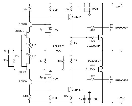

In addition, the open loop gain of the second stage of the F5 / F5T / F5m (and their 2-stage variants) are speaker load dependent.
This can be overcome by using an additional unity-gain source-follower output stage to delivery current to the speaker.
As can be seen in e.g "Burning Amp" power amps or many others.

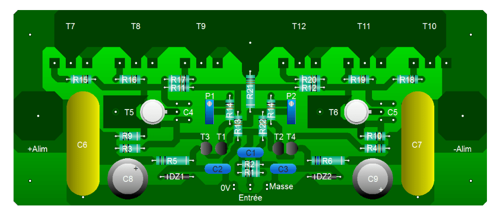

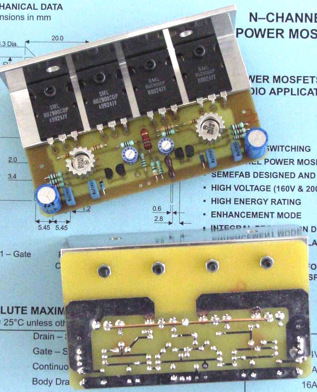

And the version we actually built.
We call it F5EXC.

Why bother with an additional follower output stage ?
You can read page 6 of this article :
https://www.passdiy.com/pdf/diyopamp.pdf
"The follower not only gives a lower output impedance, but makes the performance of the amplifier less dependent on the load impedance.
If you want to drive a lower impedance load, particularly a loudspeaker, you will want some current gain, and very often you will want this third stage."
Patrick
