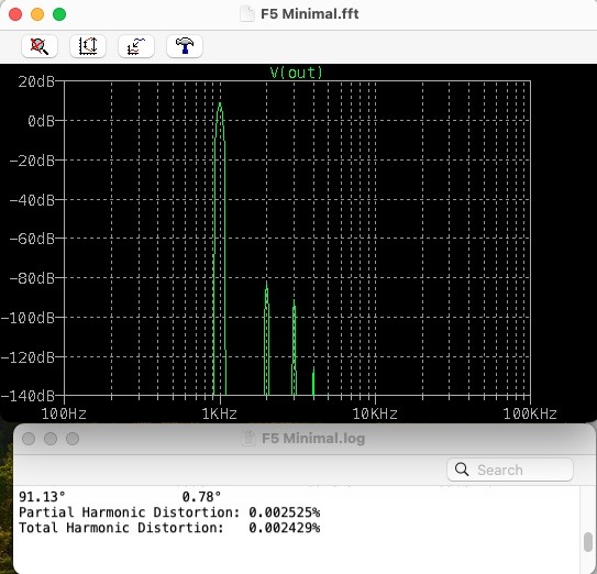

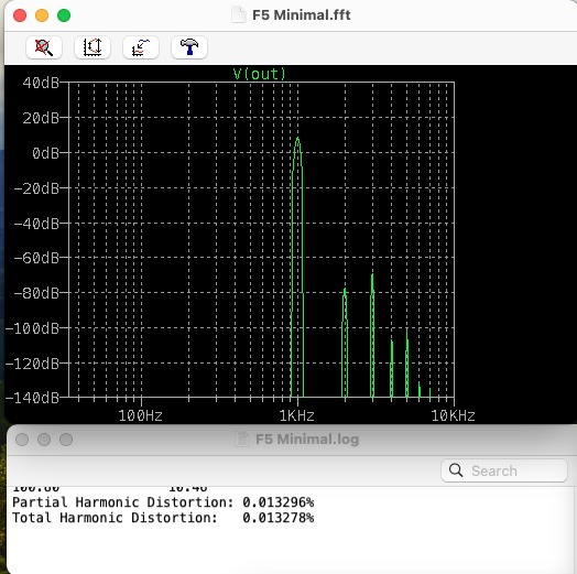

I did the circuit today in Spice and....
I am so astonished how good the simple change from IRFP240/9240 to IRFP140/9140 is changing the THD pattern.
I has the charm of tube rolling! And it shows how good Nelson knows his candidates to use them in their best way!
Here the minimalistic circuit THD pattern in Spice with IRFP240/9240 first and second with IRFP140/9140.
Even the distortion values at 1W/8Ohm are lower, though H2 is higher than H3.
