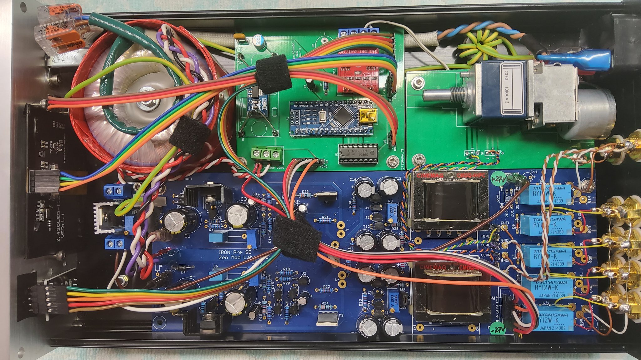

Hi Wayne, there is no doubt in my mind that we are dealing with a faulty transformer that has a great electro magnetic field radiation.
I considered the trafo shielding sheet from Don Audio but have no experience with this type of shielding, have you tried it?
The VPI brick is too big and could not put back the top cover.
Hi 6L6, if I understand correcly even our XP-17 had hum on the right chanel that was cured moving the original toroidal trnsformer in a separate power supply?
Correct. It makes a very good benefit, well worth doing.

finally solved the hum problem with my XP-17!
in particular I would like to thank ACnotDC for giving me the great advice of trying the Shielding Sheet from Don Audio.
I wrapped the shield oround the toroidal transformer and now my XP-17 is dead quiet.
Thank you ACnotDC!
I would like to thank even 6L6 for all the support he gave me.

Wayne is PL
The right channel is closest to the transformer and with all that gain you may get some noise.
A new transformer may fix it. An additional shield or heavy steel on top like the old VPI brick may help get some answers.

An additional shield is what I did.
