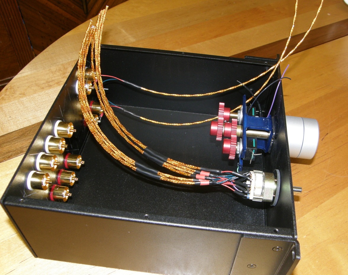

So yes, now that I have gone in a little different direction, here the start of it. 4 inputs, 2 outputs, 2 mono 10k pots by Noble, and more heat shrink and wiring than I care to normally do. I have kept left and right signals on separate leads, and even the grounds will be separate by way of the selector switch. For the 2 outputs grounds are common to each other, and the signal lead from one output to the second output has a 150 ohm resistor. So far, so good. More connections to make tomm. and then test.

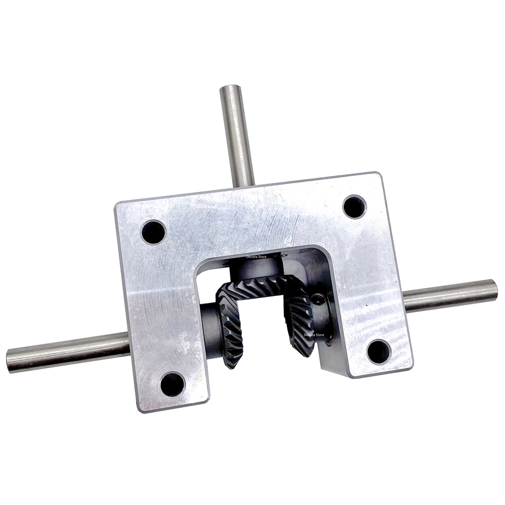

A few years back I "doodled" a dual mono preamp with each channel in a separate box on either side of a central section that held PSU regulators etc. plus differential 90 degree bevel gearing to drive the mono attenuators and switches.

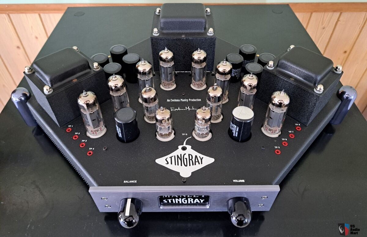

Funny that you mention simplifying things. In the end, that is exactly what I intend to do. In fact, after the unit is tested, I will put it up for sale. Simple reason for this is that by a fluke, I found an old Manley Labs Stingray integrated amp for sale. As cool as it looks, the design was all about short signal paths, and the selector switch for each channel is on the back,,, well kind of. This is definitely not a boxy style amp. And the best part is that it uses a passive design for signal input.

By the way, did the attenuations of the two Noble pots at very low levels, match adequately with this kind of assembly ?. . . 2 mono 10k pots by Noble . . .

It's a long time since I diyed this kind of thing. Looking at it again, with you and Jean-Paul talking simplicity, I would now use only two geared pots, one facing towards the back, and a shaft extension with a single knob on the one facing forward. Pot assembly near the selector and the RCAs. The bigger the gears, space permitting, the further apart the pots would be.
Since the pots can be adjusted to mechanically gang together by flat spring tension, there is less worry about just that sort of thing. ANK products used to employ these Noble pots because of their quality until they were no longer made, making ANK build and design their own.
This mechanical apparatus can use extension rods and an extra set of gears resulting in the same action as you describe, but with only one split knob at the front of the unit.
Having said that, it was a conscious decision for me to buy the Manley Stingray just because the e selector knobs were close to the inputs, and also that each selector was a separate mono unit. I cannot say the same for the front panel volume and balance controls of the unit, except they are made by Noble. We'll see what I think when it arrives this week.
