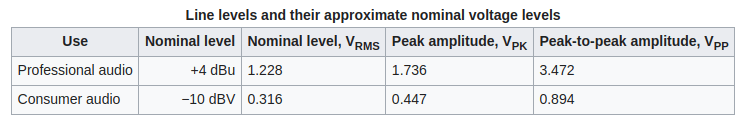

Very interesting for me, it kind of explains a lot but I'm still not sure about what a Consumer Line level of 0.316V rms actually means. Is it the maximum level or some kind of
average ?
Thanks Chris. However the Wiki on Line Level suggests that CD levels are an exception being 2V rms "to avoid the need for a preamp" it said. That's what was confusing me as
I'm seeing much higher levels that 0.316V rms from my CD players. This is important for me as I'm designing output transformers for a Dac and peak o/p levels matter.
Sorry if Ive still got it wrong somehow.
Commercial CD's you play at home always confine the level to 0,31VRMS The level is in the media being played, not the Players capability ,The exception is a Test CD that will warn when 0dbFS is approached. Peak levels in the article are stated as Voltage Peak, and Voltage Peak to Peak, different to average level RMS , see:

The difficulty I'm having is that I'm seeing peak voltages of over 1V on some CD's so the rms value will be well over 0.316V . I checked the 0dbfs level at 2Vrms using a test disk.
I dont want to hijack this thread so I will recheck for specific track's and levels to be sure of my findings before responding again. Anyway thanks for this I didnt know about
the Consumer Line level.
Check your output is from your CD player, rather than your DAC, as the latter may or may not then be representative of consumer line level, Possibly additional gain is being selected as part of its available features. RMS in the attached image is light blue, and peak is dark blue.

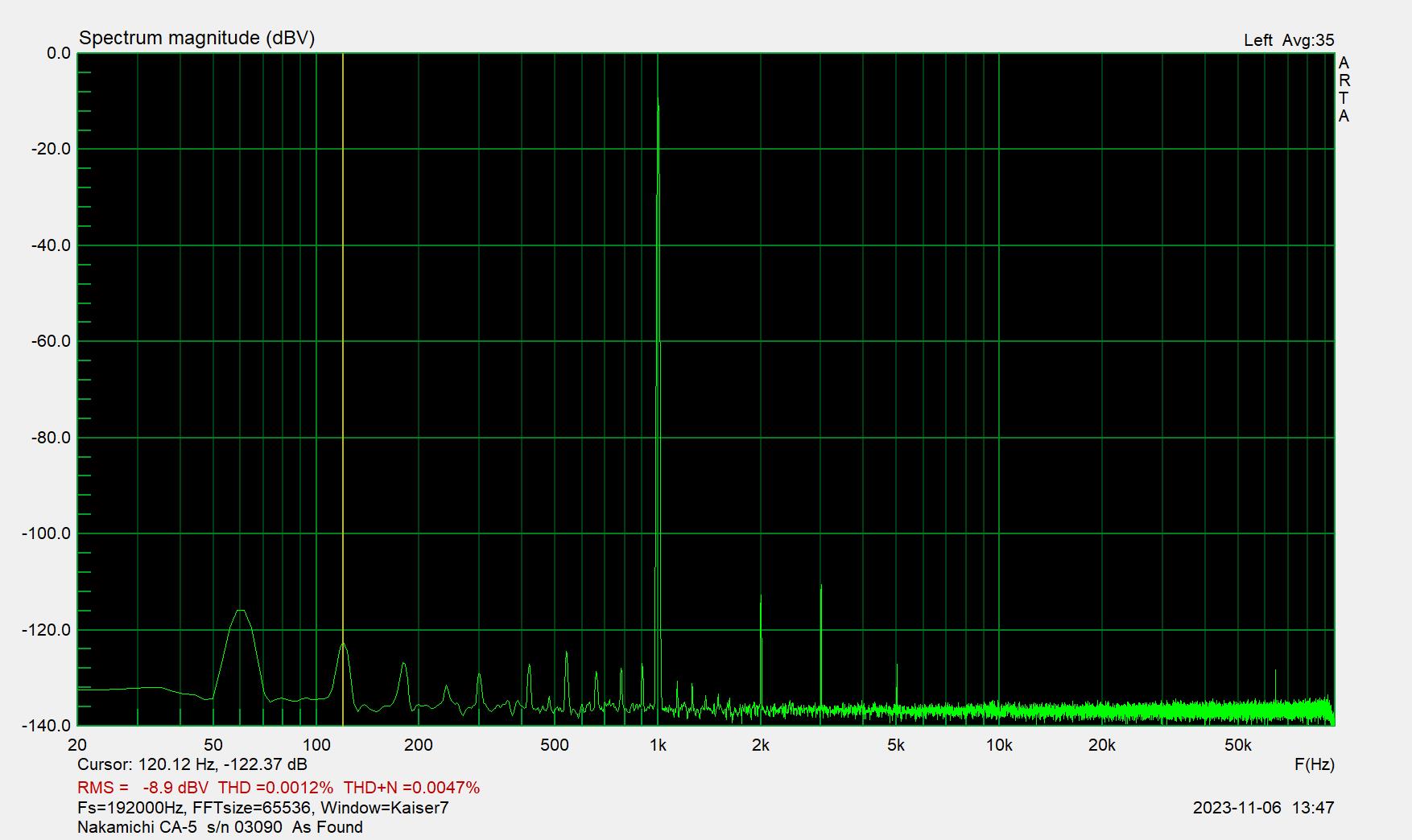

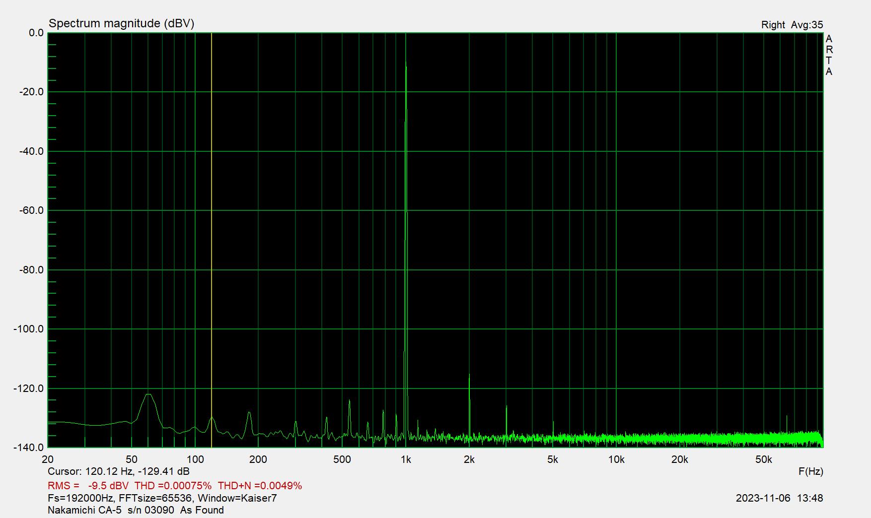

They do not add power. The frequency response isn't as wide, and therefore transient response isn't as good as a good preamp.
Here's a stock Nakamichi CA-5 for example ...
This is real measured performance without special care taken. Hint: It's better than most sources. If I look, I could probably find something better. The real kicker is that this is a mass market, commercial product. Not a one-off, hand tuned thing. Very affordable.
I have to ask. Why wouldn't you buy one of these used instead of buying a more expensive transformer based thing? You get RIAA MM and MC inputs as well. On top of that, performance is much better. It also drives real world amplifiers and cables.
