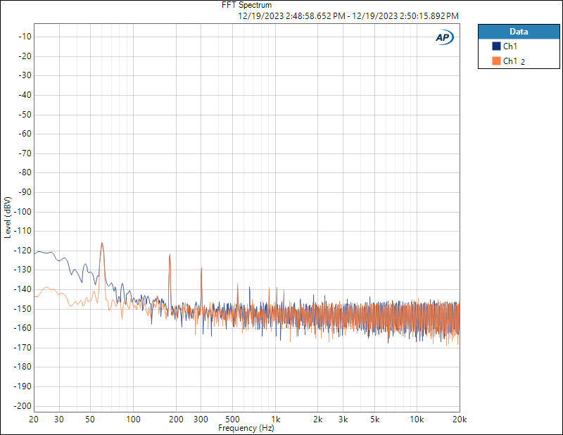

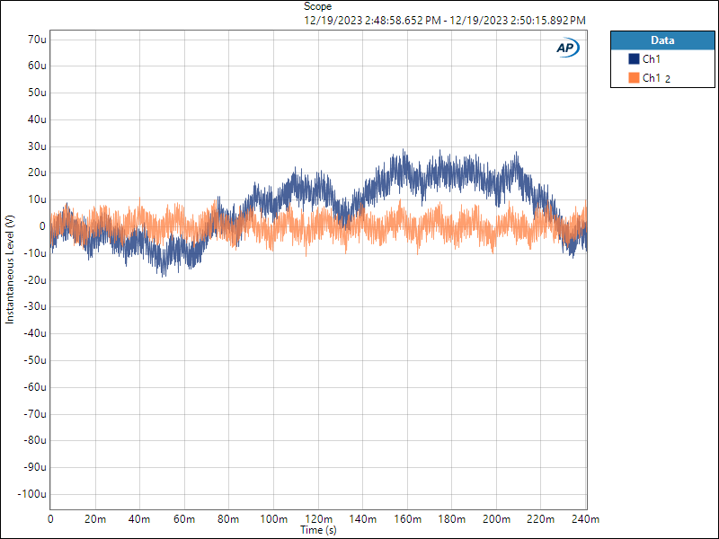

For grins I have assembled on perf board a LM7815 and a Sparcos 7815 3 legged supplies.
Both supplies are operated into a breadboard of the P3 input stage.
The raw supply for both is a TRIAD 18volt DC wall wart. See the attached AP scope and FFT plots.
The LM7815 regulator is much cleaner.
Thanks DT
Orange is the LM7815 regulator.
Thanks DT
![sparcos FFT Spectrum.png sparcos FFT Spectrum.png](https://www.diyaudio.com/community/data/attachments/1156/1156785-48f83ff24d2b7e0ddf728cb921eac4ad.jpg)
![sparcos Scope.PNG sparcos Scope.PNG](https://www.diyaudio.com/community/data/attachments/1156/1156786-e36915efd695c13c2ddb7ead639acc5a.jpg)
