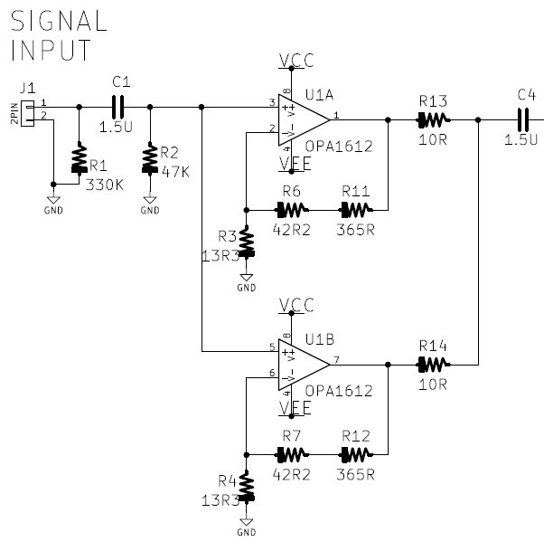

The noise floor for the AP2722 is about 6 to 8nV/RtHz. The Jung SR using an AD797 has noise of ~4nV/Rt Hz so you need an amplifier with a sub 1nV/RtHz noise floor to accurately measure regulator noise. The setup WJ showed in the 1995 articles still works.
When I get P3 boards will measure, but my experience with the P2 is that there is essentially NO difference in the P2 phono-pre output noise when powered by LM type regulators OR the Jung or Salas regs (set to the appropriate level, in the case of P2, +/-24V). Zen Mod is certainly correct.
Here's a less expensive ($6.40 @ qty=1) way to proceed -- assuming very low source impedance as in a PSU.
First stage gain = 30dB, subsequent stages aren't noise constrained so select for high-GBWP and low price.

The Device Under Test is not only the Regulator. The regulator is not the only offender. The raw DC power supply looks to be a worse offender. The jfets and 47K input resistor contribute additional noise.
Power line ripple can clearly be worse, a couple of inline CR filters help the LM regulators do their job.
I am looking at the input stage of the P3 including filters and regulator as the DUT.
For additional insight see this TI document.
https://www.ti.com/lit/pdf/tidu016?keyMatch=NOISE MEASUREMENT POST-AMP

I used SSM2019 for the article, those I have were 1.0nV/RtHz or better, and it's differential so easy to use shielded twisted pair. It's about $6.00 in single quantities and available as DIP. Rather high input bias current, however!Here's a less expensive ($6.40 @ qty=1) way to proceed -- assuming very low source impedance as in a PSU.
Now use one of Gerhard's designs (of which he has a dozen at least!).

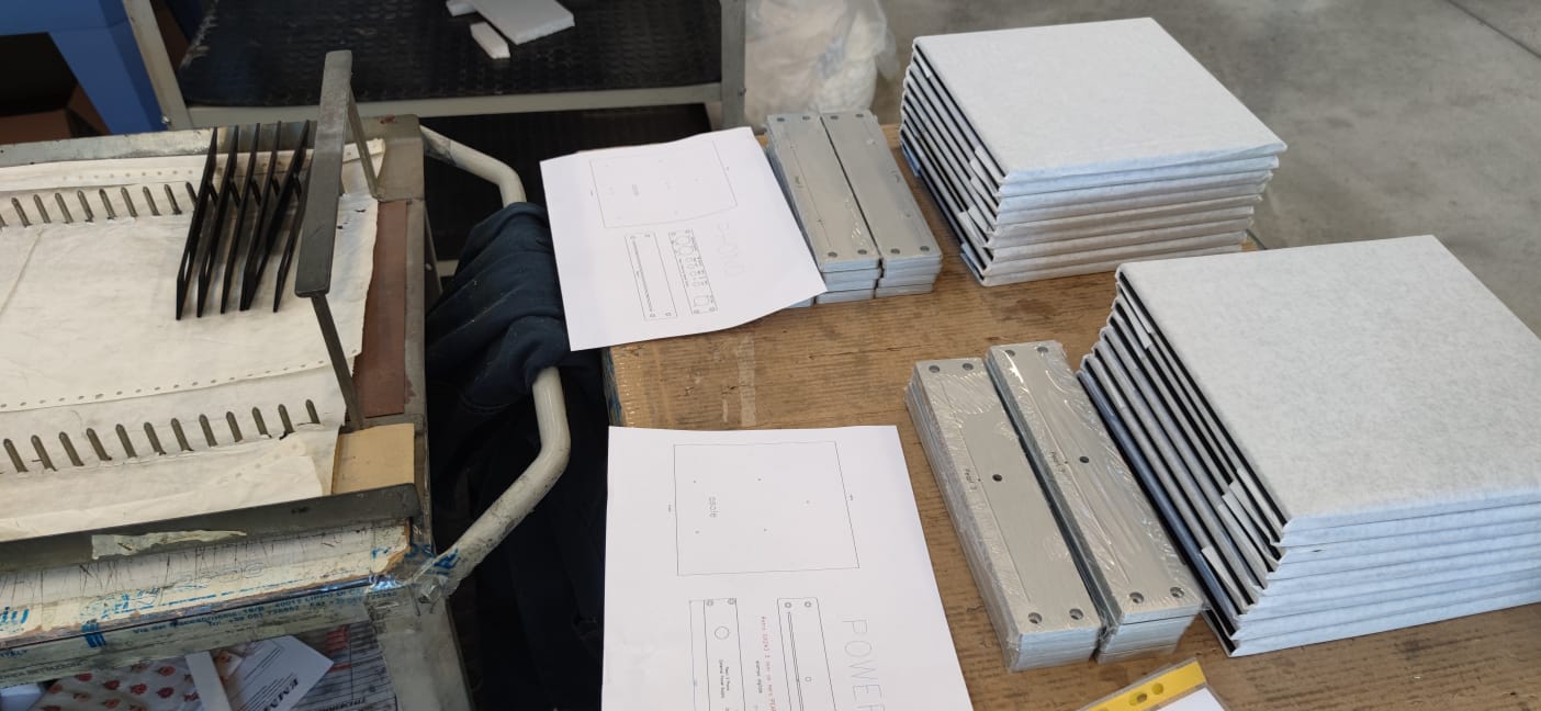

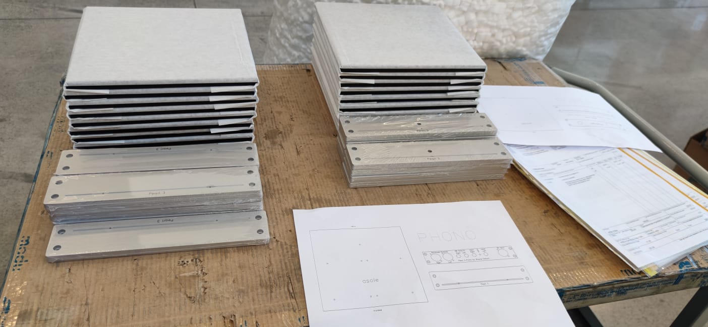

Ciao Gianluca,🎅🎄🎁🎶 Santa Gianlu is comin' to town...🎅🎄🎁🎶
Is there the possibility to obtain the same faceplates in a standard Galaxy?
Buone Feste
