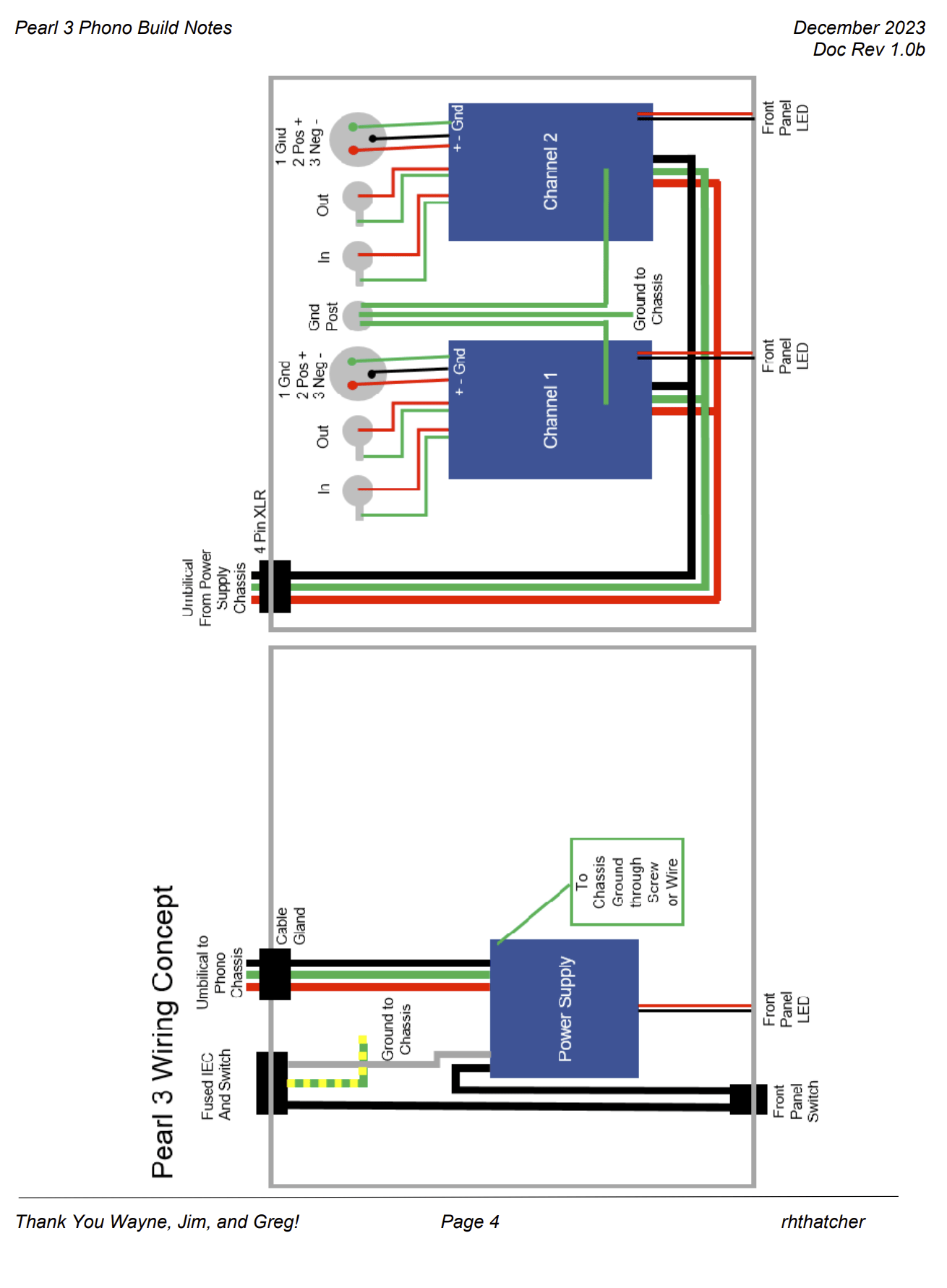

I would have thought that the "shield" and related wiring should be separate from the signal (and power) ground until the last possible moment... at the bridge.
Logically, I would think that the shield of the umbilical should connect the shield enclosures at both ends as their separate shield ground. Connection to earth would be on the chassis side of the bridge. The signal ground from the boards would be run in a dedicated wire in the umbilical to the signal side of the bridge.
I'm not sure how the TT ground wire and the ground post figures into this particularly in a dual mono setup. (two ground posts?) (connected to the signal chassis? or not???) Flexibility either way is likely in order.

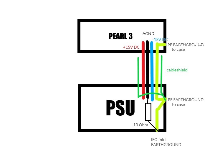

The shield should be connected to earth ground ONLY at one point... usually the upstream ( "head") side. Otherwise you are creating a ground loop with the "ground wire"... The Hot and Ground wires are connected at both ends... the Shield only at one end.
You ever seen directional RCA connectors? That's how they're wired. Except that in that case, the shield and ground are both connected at the "head" end.
Balanced connections are a bit different since, by definition, the noise will be filtered out. But even so, if using a shield ONLY connect it to one end point. The idea is to separate the noised picked up by the shield and shunt it to ground.
For your power supply interconnect, the shield should be grounded at the power supply side... to earth ground. This will ensure a PS DC signal(s) devoid of RF interference.
BTW, this should be the REAL ground, the chassis.
I consulted the P3 building guide. There is a wiring diagram like this:
In the PSU chassis (the green box) is going to chassis. I guess this is via the "bridge" on PSU PCB.
I am using the UDP3. But think I can elaborate from this drawing and make something that will work using the UDP3.
There is also UPD3 documentation I can look into in dedicated UDP3 thread.

Grounding is a complex subject. I try and maintain isolation between chassis and signal ground all the way back to a single point ground in the power supply. The goal is to A) make sure no current flows through the chassis, B) maintain chassis + enclosure + cable shield integrity as an overall Faraday screen. For some small signal applications this needs to be modified, but that is generally a phenomenological situation.

I confirmed, shield should be connected only at one end, usually the power supply enclosure chassis. I wouldn’t expect using a shielded cable between the supply and phono would have such a great impact on noise, on the phono side. The shield protects only from high frequency noise and has marginal effect on the line ac noise. The physical separation of the power supply and the phono is doing the real reduction of ac noise in the phono. That and the actual steel shielding of the enclosure.
