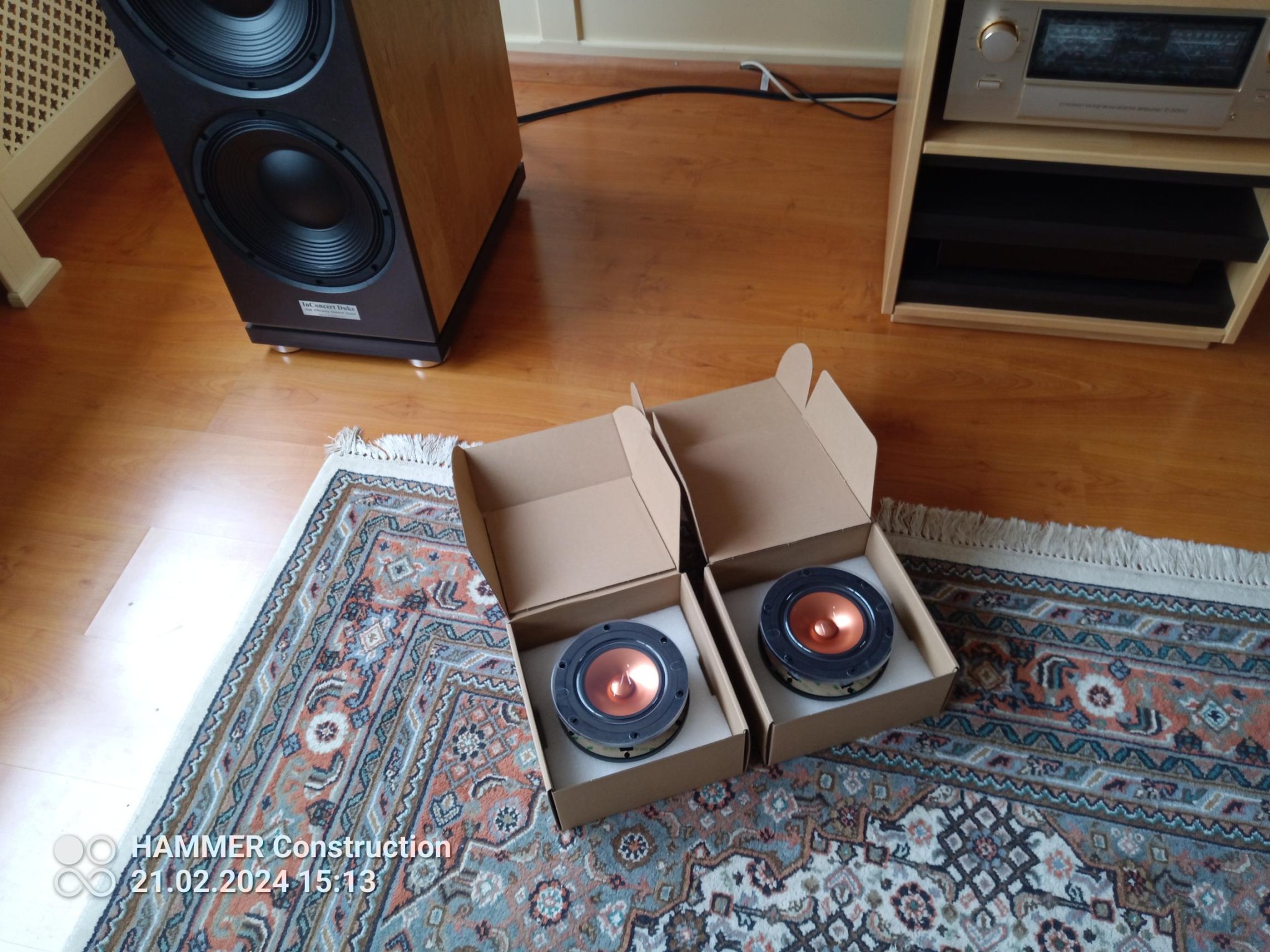

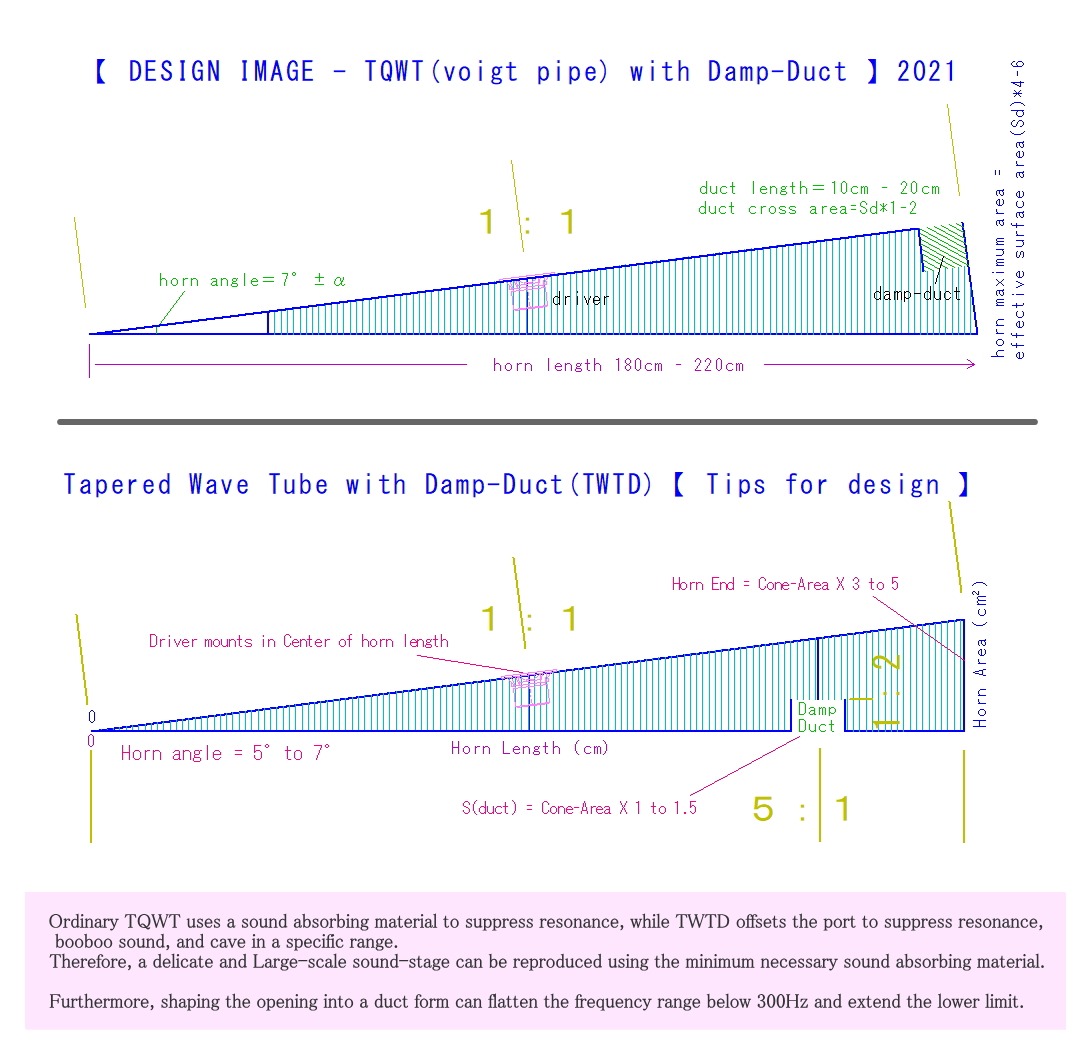

Today I ordered another pair of the 10.3's and I like to use them in my cloned Sibelius.
I really like to know how the 10.3's sounds in the cloned Sibelius to compare it with my previous built "Crystal-6 Double Horn luidsprekers with Markaudio Alpair-10 Gold Full-range Woofer".

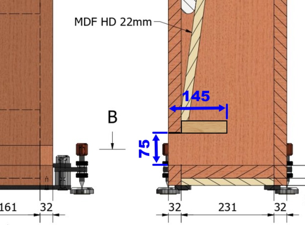

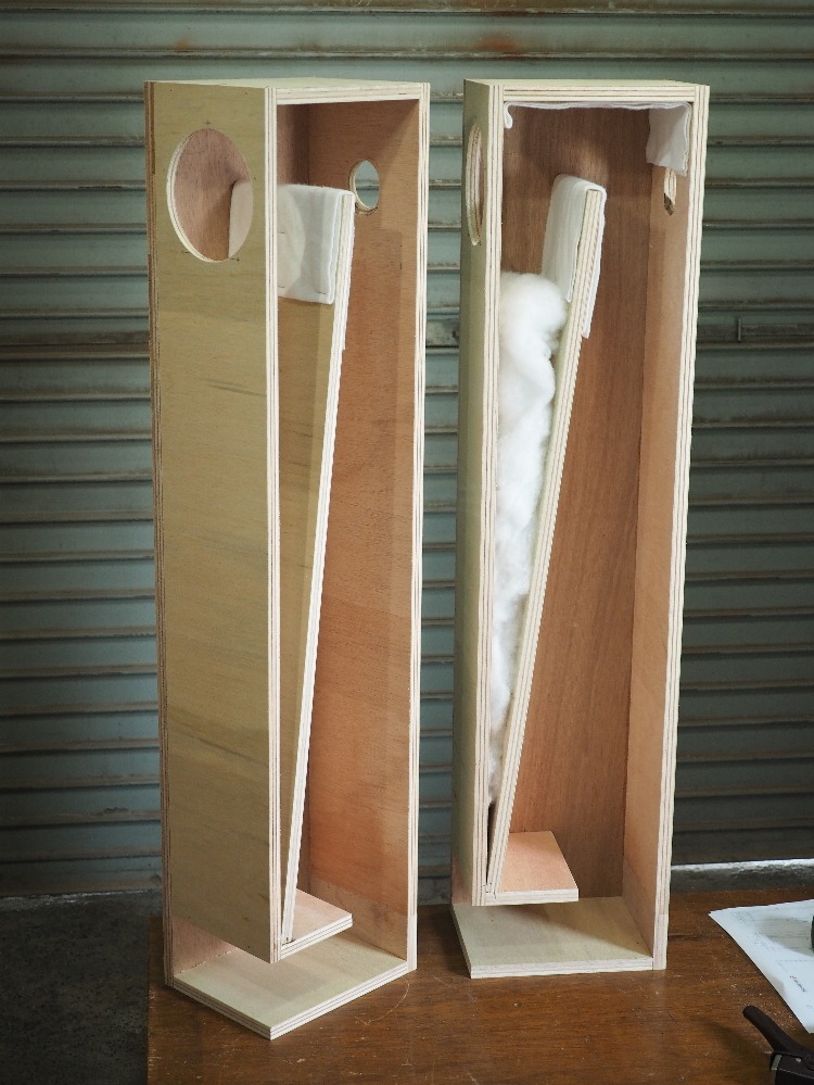

Updated the drawing and lateron playing with some damping.

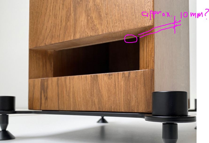

I feel that the dump-duct effect is weak when the opening length is 42mm.
Next time you build this product, why not widen the opening area and extend the duct length?
I think you can experience a different world.

This is not according the original design.I feel that the dump-duct effect is weak when the opening length is 42mm.
It must be a "99,99%" clone.
