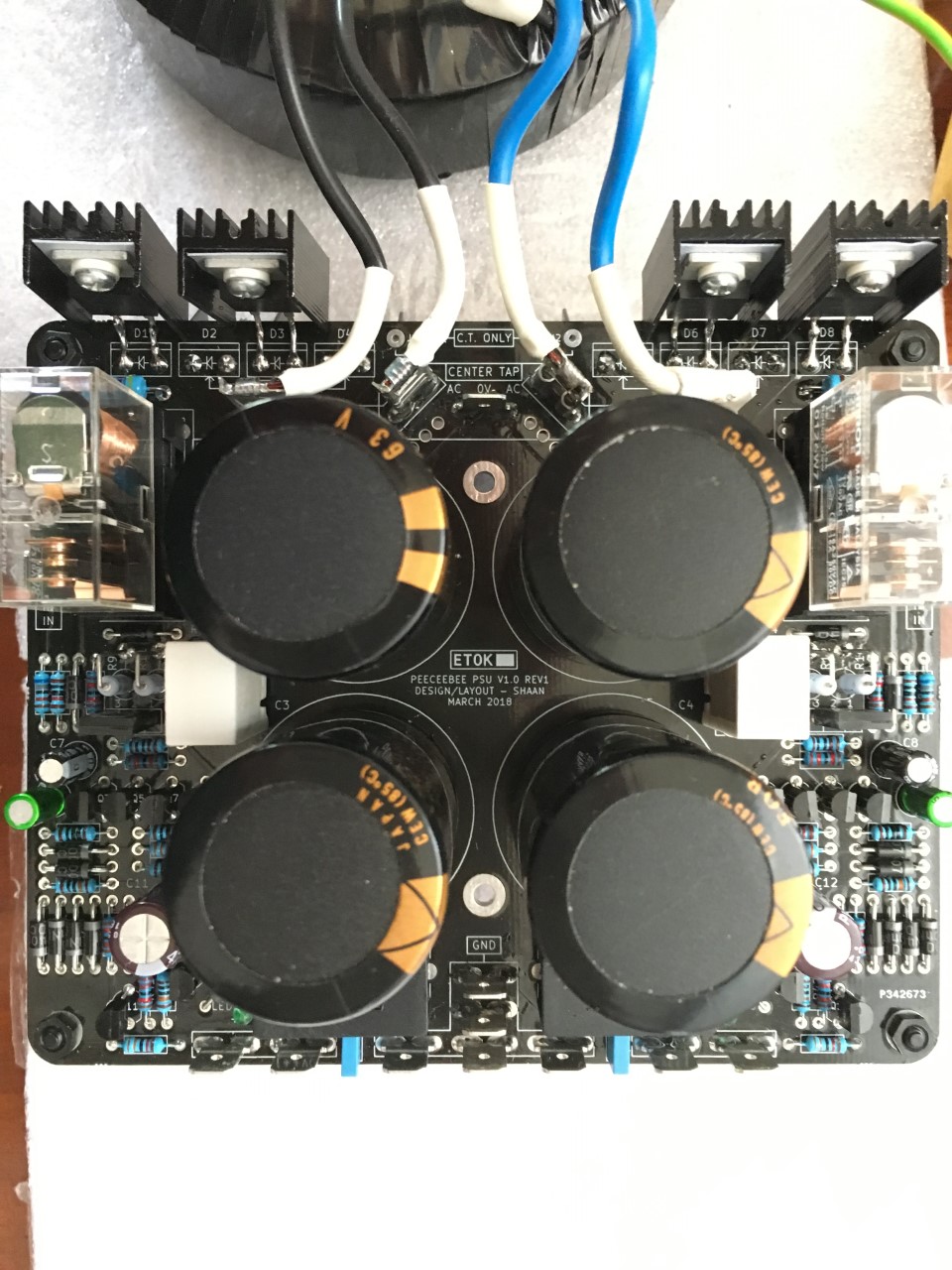

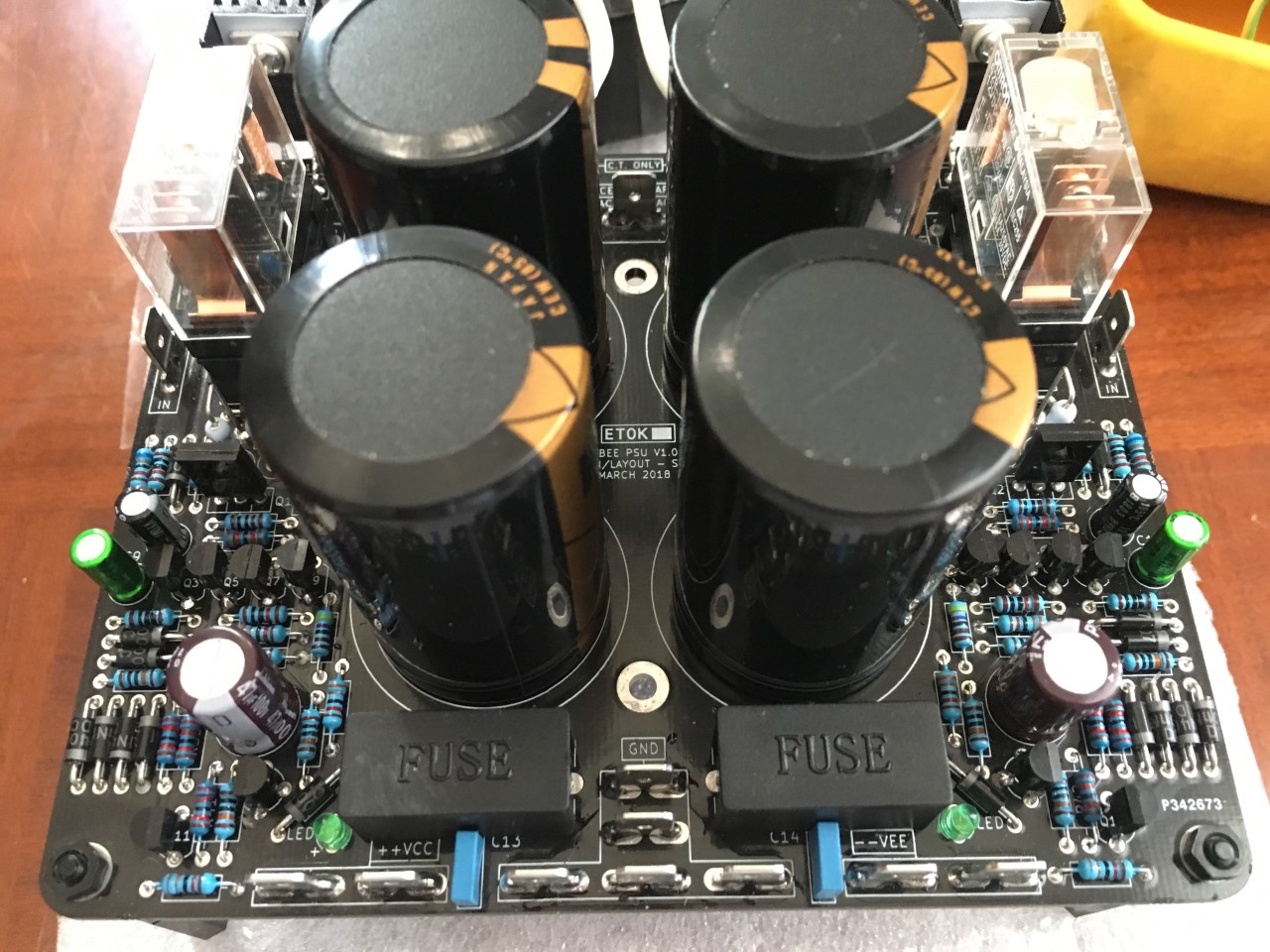

Please check Q1 and Q2 whether they were damaged during reversed operation. Just base-collector and base-emitter diode test will be sufficient. Can test without removing from board.
If Q1 and Q2 are fine then install one 10uF polarised electrolytic capacitor in parallel with the existing 10uF (C7 and C8). Turn on power and check (for 10-15 seconds).
edit: also check for any loose solder joint and whether all small transistors and resistors were placed correctly.
hi Shaan
all is well the relays works, I changed Q1 and Q2 and controlled the welts and small transistors
I am happy
thank you for your advice and patience
