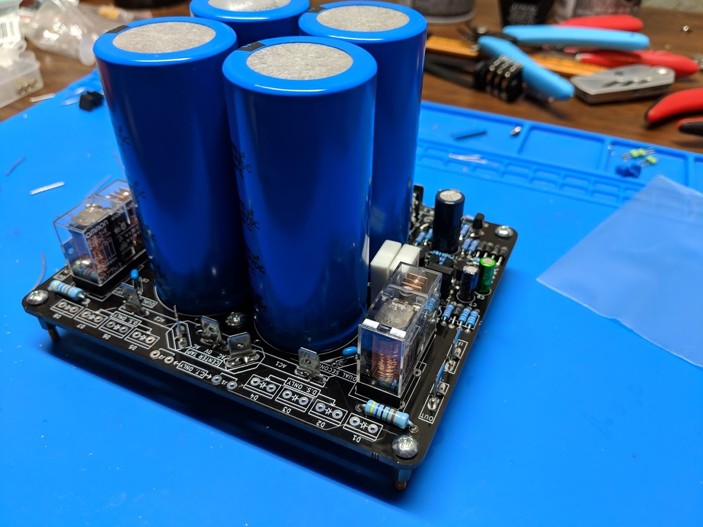

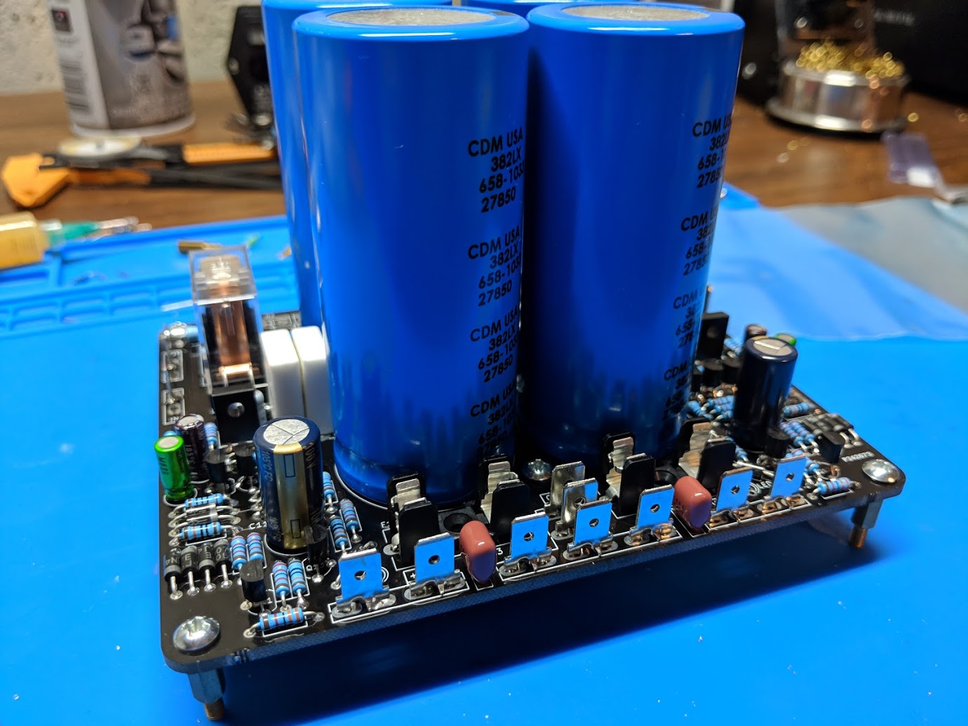

Got the PSU stuffed for the most part except for the LEDs and diodes. The diodes will be mounted under onto the base plate and the LEDs will have a lead to the front panel.
Good looking board Shaan.
