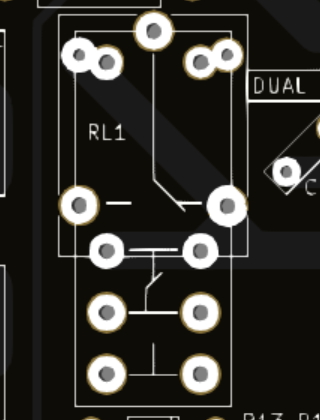

Hi Shaan, any model suggestion on the relay for large current using ?
What form factors are supported?
I'm looking at this one:
G5LE-14-CF DC24 Omron Electronics Inc-EMC Div | Relays | DigiKey

Hi Loafiums. I dont know what form factor it can support. I just wanted a high current supported one for the psu board

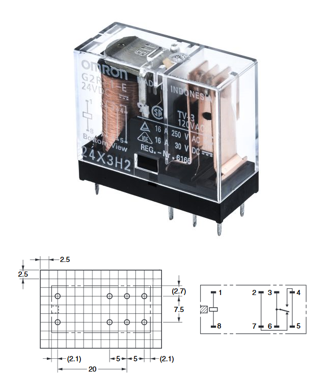

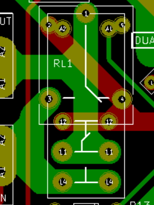

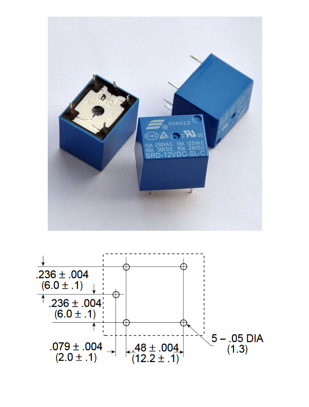

Please check the attached pix. The PSU supports these two form factors. I can't seem to land on any model number that I'd prefer over others as most models that fit in the configs shown in the pictures below are suitable for the purpose. But considering killer looks, the G2R-1-E SPDT 24V Coil 16A (second picture) wins my heart.
Hi Gannaji. Will upload shortly.
Please read on.
Please check the attached pix. The PSU supports these two form factors. I can't seem to land on any model number that I'd prefer over others as most models that fit in the configs shown in the pictures below are suitable for the purpose. But considering killer looks, the G2R-1-E SPDT 24V Coil 16A (second picture) wins my heart.![]()
That is one pretty looking relay. Thanks!
