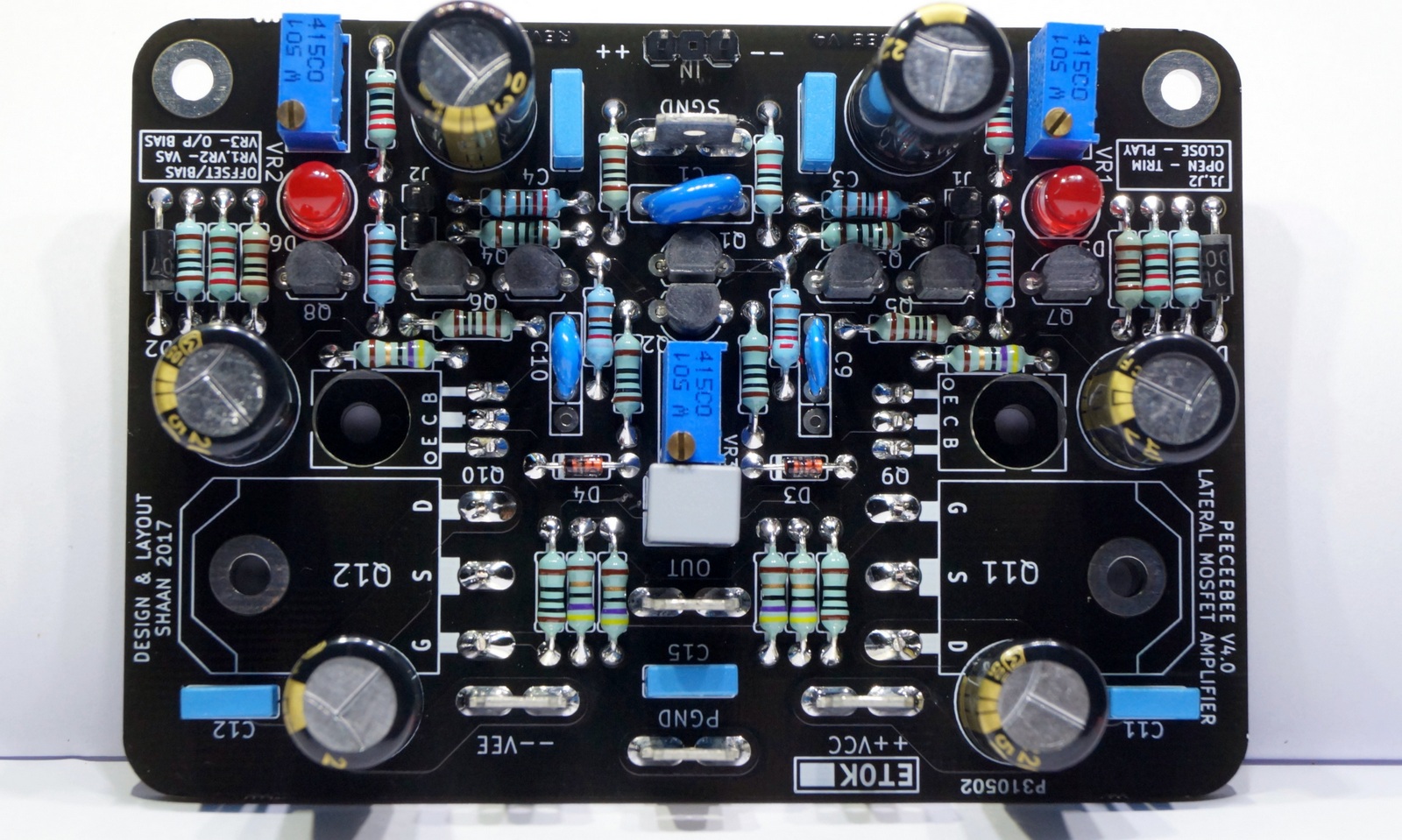

Hi Shaan, before starting to order BOM do you recommend some specific make/brand for caps or some matching for BC trasistors?
What components i need to change is i plan to use a +/- 45v SMPS?
Thanks for your help!
Hi.
I like Panasonic FM electrolytics + Wima films + Dale MFR. IMO this combo looks sick with V4!
Matching is not really that important here, but try to avoid a hFE difference of more than 25 between PNP and NPN.
For 45V operation use ECX10N20/P20 instead of 2SK/SJ, MUR160 instead of 1N4148, MJE/KSE340/350 instead of BD139/40. Also change the two 220R resistors (R7,R8) to 330R.

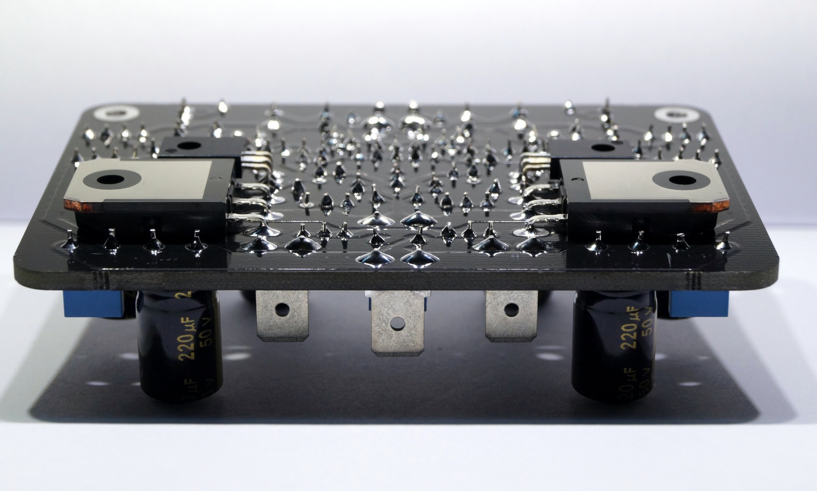

Looking on pcb's one quiestion raised into my mind: how is the pcb mechanically tighted to heatsink: with the two screws of power transistors?
Is it ok that pcb is tightened along with transistors? In VSSA that plastic spacer was a good idea to keep pcb 2-3 mm away from hot power transistors. Thanks!
With two screws for power transistors, two screws for VAS transistors and if you want more retention then two extra screws for only the board on the input side. IMO, power and VAS transistor screws are enough as the board is very sturdy, very hard to bend it from a push on a tab terminal.
Yes, absolutely ok. V4 was designed with that in mind.
Plastic spacers are a thing of the past.
