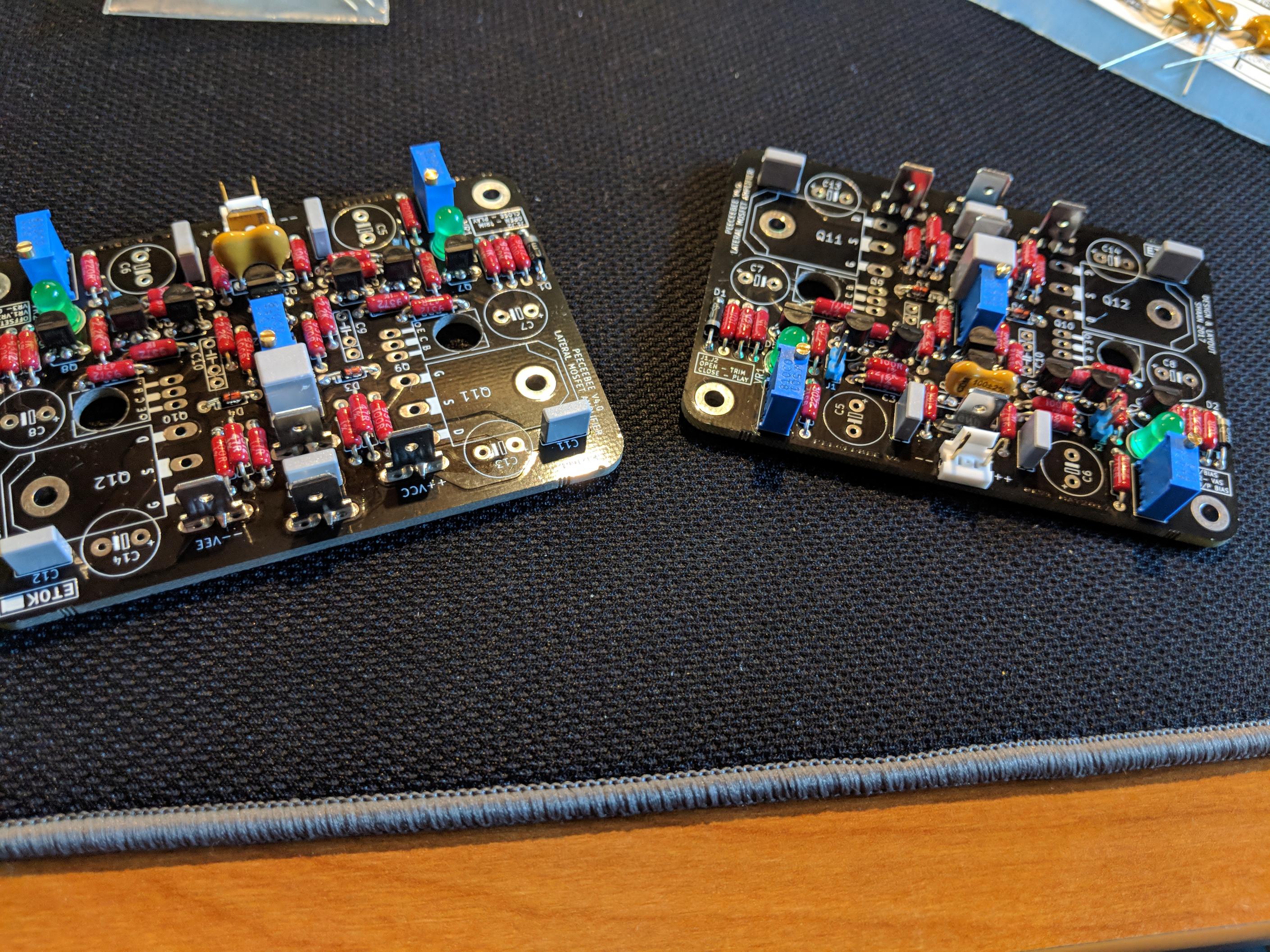

Finally started building my V4 that I've been sitting on since Christmas last year. Going for an Exicon build along with the peeceebee PSU.
Got most of the components on and tapped a few holes for mounting. I plan to at least have the V4 completely soldered and mounted to the heatsinks tomorrow.
Since there's not a lot of building in this thread, I'll try to post progress as it's made.

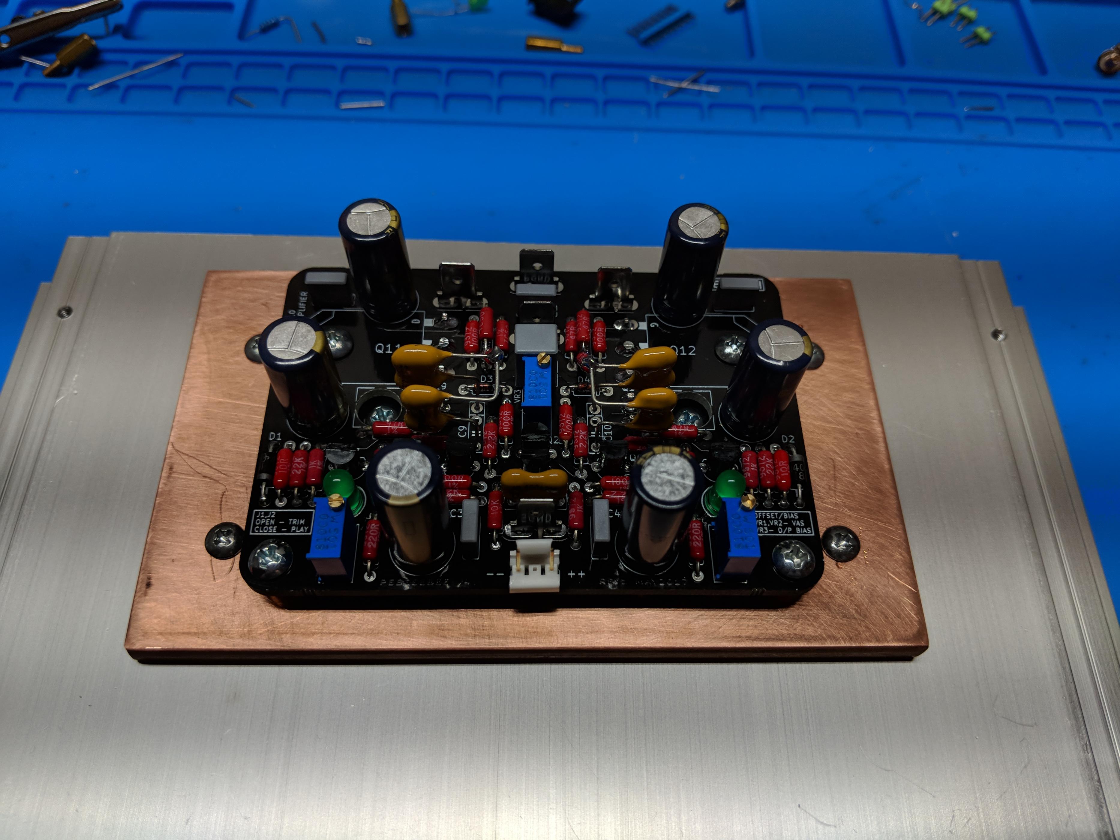

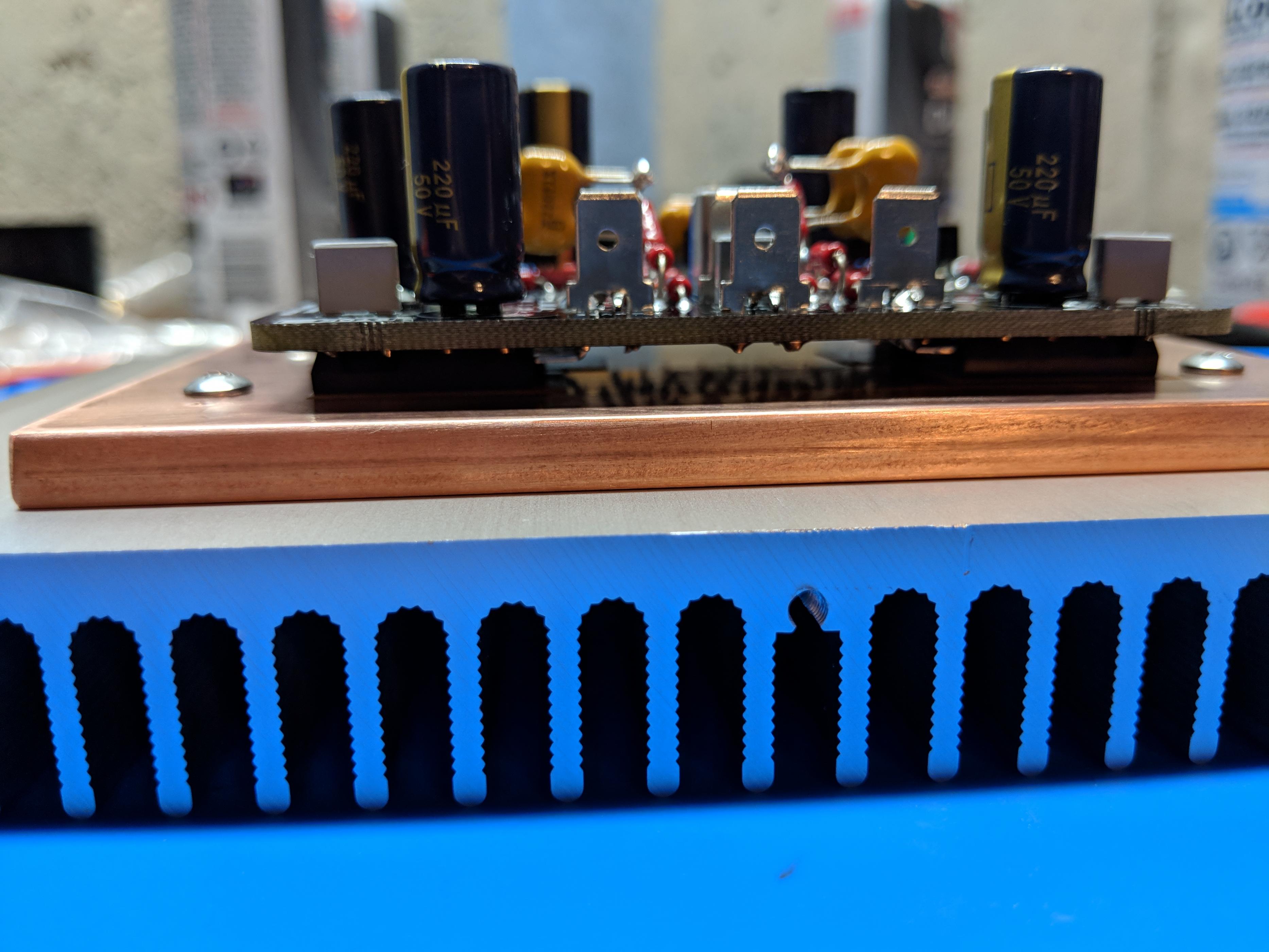

Made a little more progress today. Only one channel is done, but it's a start!
I decided to mount the peeceebee to a plate of copper so I could tap the heatsink between the fins. Also, I figured it would add a little thermal mass and I have some nice Wakefield thermal compound I stole from my brother that I wanted to use. I learned that tapping copper is not nearly as fun as aluminum.
Pictured is the rev2 mod.
Hopefully this week I'll be able to finish up the other channel.
