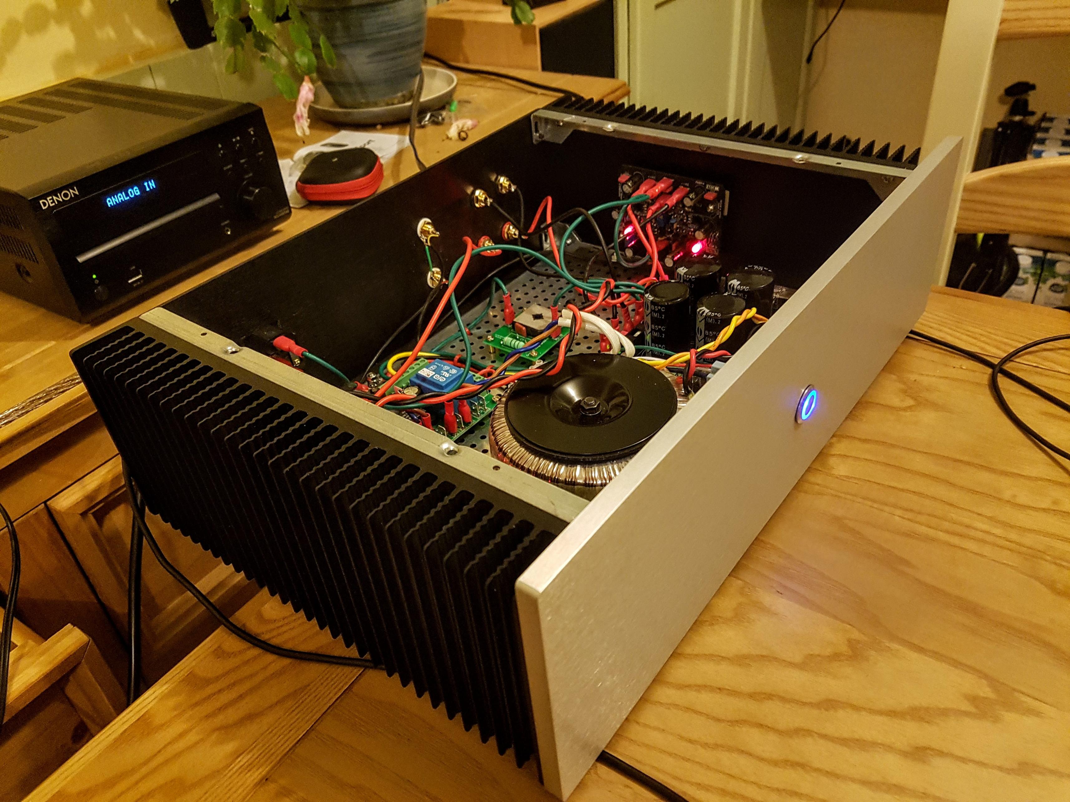

Finally got my V4 finished!
I had hums and buzz for a while, but now it's at the stage where I have to have my ear next to the speaker to hear a faint buzz when no music is playing.
I've only had it through my office and kitchen setups, where the speakers aren't that great, but the sound is fantastic. I've tried it with reggae, electronic and classical music so far and it really does handle a wide variety of music well.
I found this build quite challenging, but it has taught me patience and I've learned along the way, which is important to me.
I would like to express my gratitude and admiration to Shaan for making this amp and PSU available to us, and especially for his help and advice. Similarly to the other forum members who chipped in with suggestions, thank you, it is much appreciated.

Hi Neal.
It's great to know you finished the V4 amp build. The enclosure is awesome.

Hi Greg,
Thank you very much.
Two extra circuits were used. The ground loop breaker is indeed based on the ESP circuit. The website circuitbasics has a link to a PCB you can order for fabrication yourself. I ordered 10 for £6 inc p&p.
There is also a Hypex softstart module, and this also incorporates some additions, such as the ability to have status LEDs, temperature monitoring and a push button switch.

I've had a week with the PeeCeeBee V4 now and just thought I would share some observations.
After moving the amp into its final home -the office/shed in my garden - the hum/buzz increased to a level that was unacceptable. I did lots more reading and experimenting and finally got to the point where for all intents and purposes (bearing in mind I'm 51 years old with some tinnitus) the amp is silent when no music is playing. I have the ground/shield from the RCA inputs tied together at their tabs, but the shield goes to V-- at the amp rather than the PSU ground. This cable (signal and shield) was always close to the AC input and soft start but routing it away from these worked, even though it's now longer and right next to the transformer!
I have it connected to a Schiit Modi Uber DAC and Magni 3 headphone amp which I'm using as a preamp for the moment (I'm planning on building a Rod Elliott ESP preamp next to go with the PeeCeeBee). I think the sound is just superb. I swapped between the PeeCeeBee and a Cambridge Audio amplifier that I've been using previously and for me there are two noticable differences. I am useless at describing sound, but the bass certainly feels tighter and punchier, it seems to have less of a bloom than the Cambridge. The mids seem to have a little more clarity, almost sharp, but not in a harsh way, but this is less obvious than the difference in the bass.
Once again, I'm really happy with this, it's a superb amplifier.
