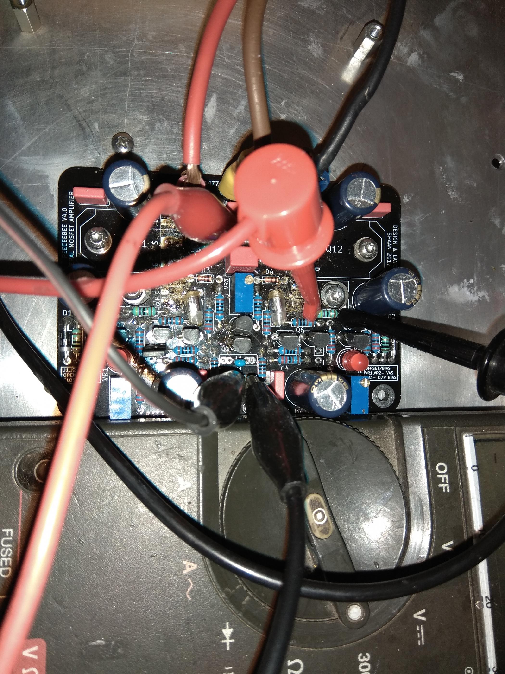

I have a donation, part of it's is a set of faulty Peeceebee v4 boards.
In my attempt to repair those i had used ksa, ksc.
They oscillate badly.
8v on 47R vas load resistor.
Then i swap the ksa, ksc with bd139 140 and everything is fine.
I have some photos from the setup process but i don't know where i must post.
Sorry to be late.
Does increasing 47pF to 56/68pF help?
I don't know.
My first effort is to repair those faulty boards.
Now i think that they are in good condition. Everything looks good.
Next step will be the modified compensation.

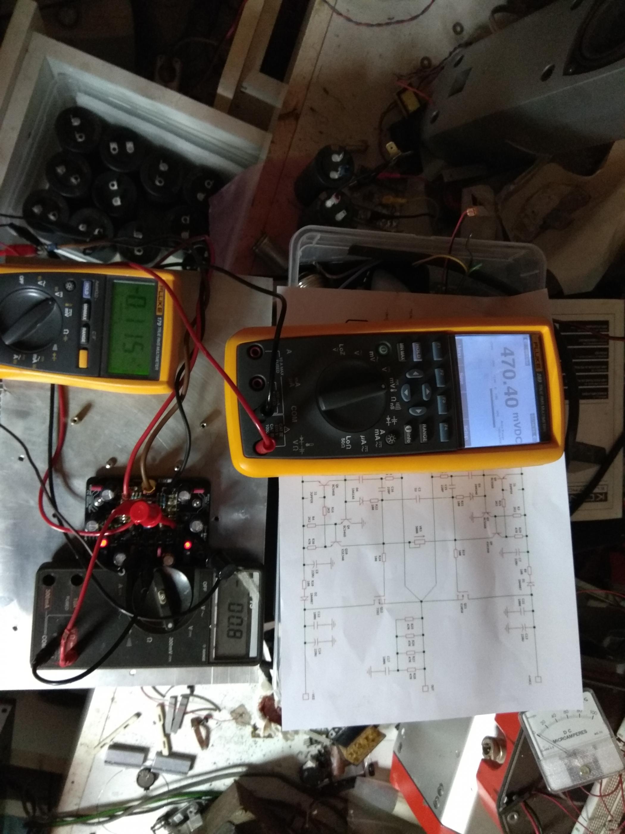

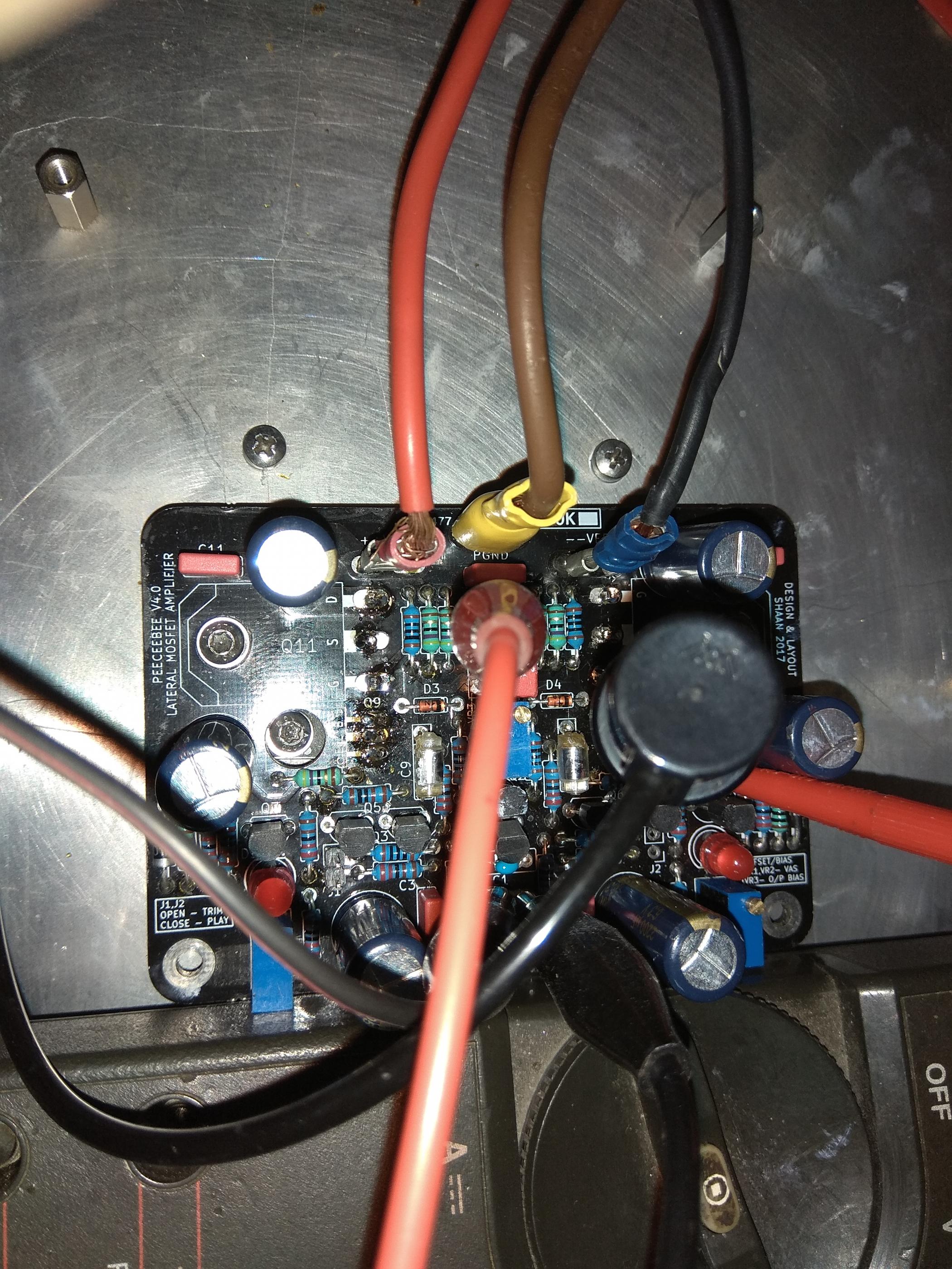

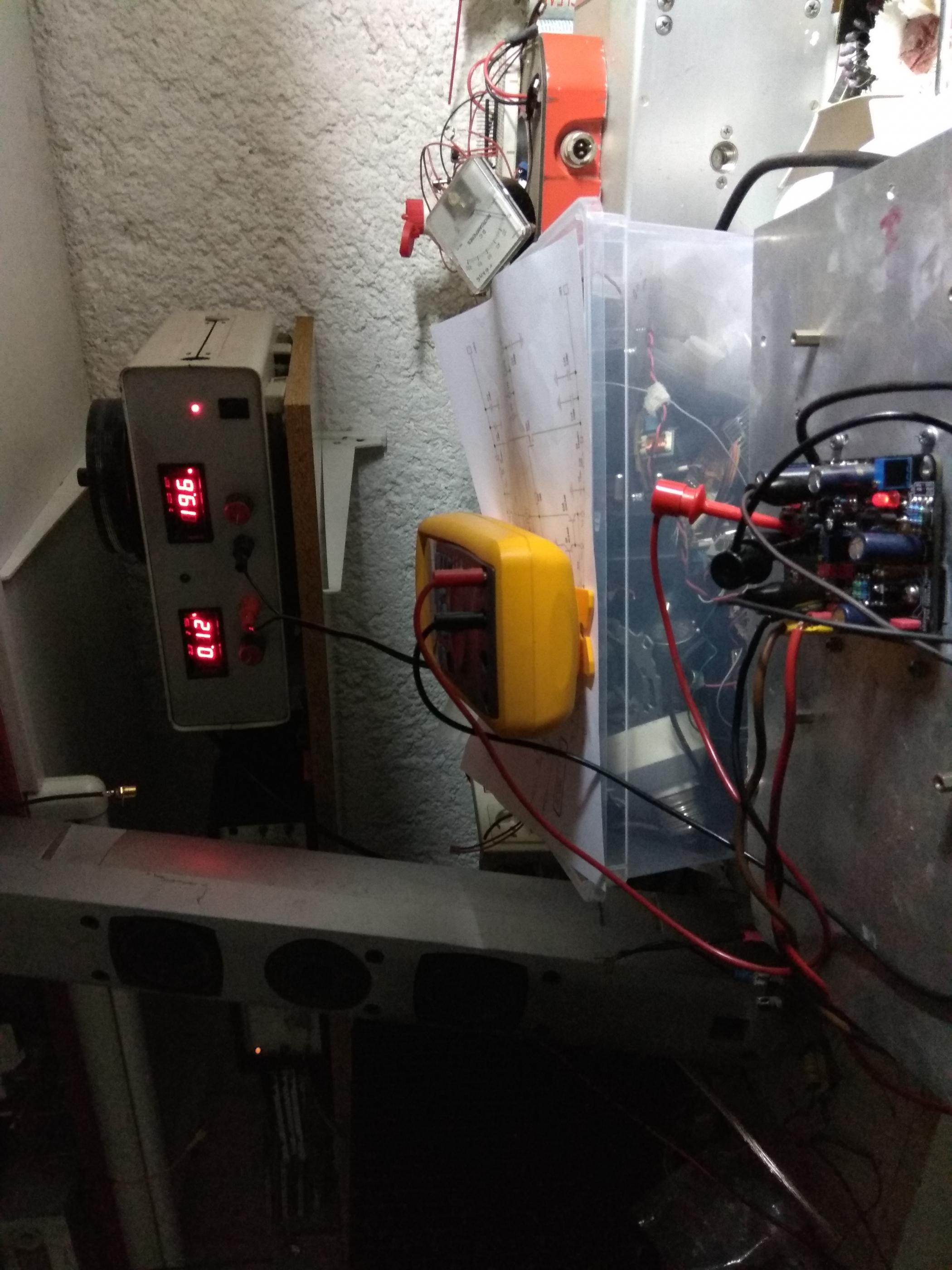

The test setup.
Vas current, mosfet bias, offset voltage measured all together.
Two regulated power supplies used for +/- supply.

The member who donated,gave those as faulty.
During repair i didn't seen any wrong placed part,not something like short circuit not dry soldering.All looks good,very good job.
I believe that he failed during setup procedure.
I will post, as built shematic and measurements soon.
I will try to post the trimmer setup procedure with pictures to help others not fail again.
