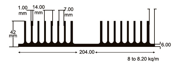

Hi Shaan, any pics of finished amp...wanted to estimate heatsink requirement
Hi Kamal.
Mine is a naked setup so no pix of a finished amp as of yet from me. But you can use a 300mm x 100mm heatsinks with 30mm fin depth for one channel. You can contact the following website for heatsinks with any dimensions for a custom design: Akash Heatsinks
the first 2 listed are 600va, should be good for 2 channels , the third one is 300va, good for one channel only, but it's up to you the way you will build it.
Thanks.
Hi Kamal.
Humm... I have 204 X 100 mm heatsinks with 42 mm fins
![IMG_0279.JPG IMG_0279.JPG](https://www.diyaudio.com/community/data/attachments/593/593141-b41bfcdbcabbdd8e283c8c94be069e62.jpg)
Can this work for single channel?
